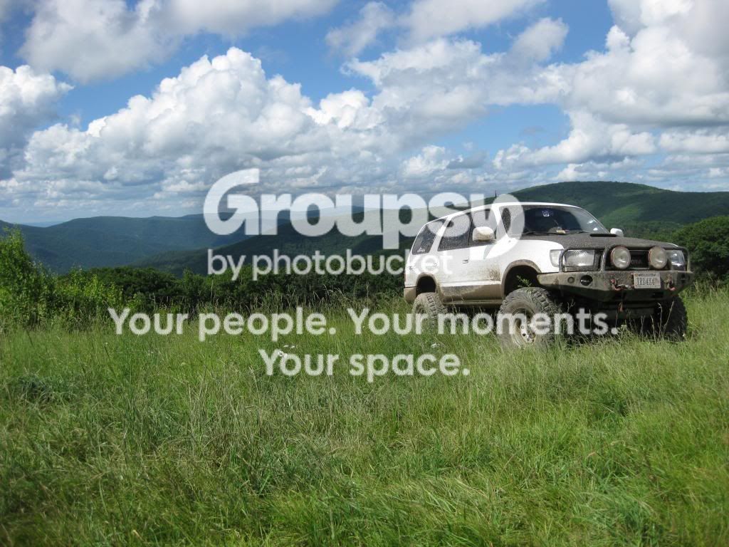

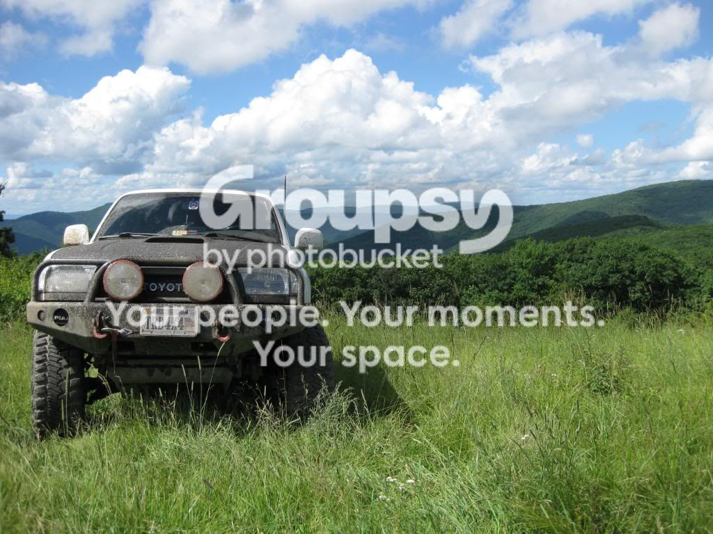

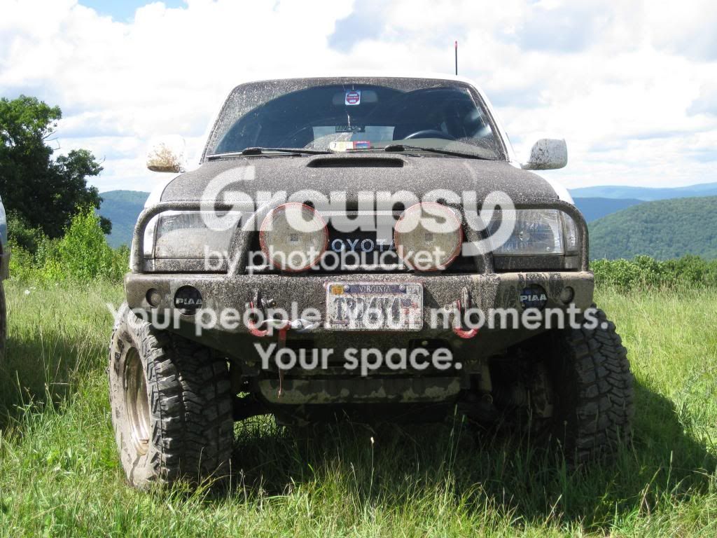

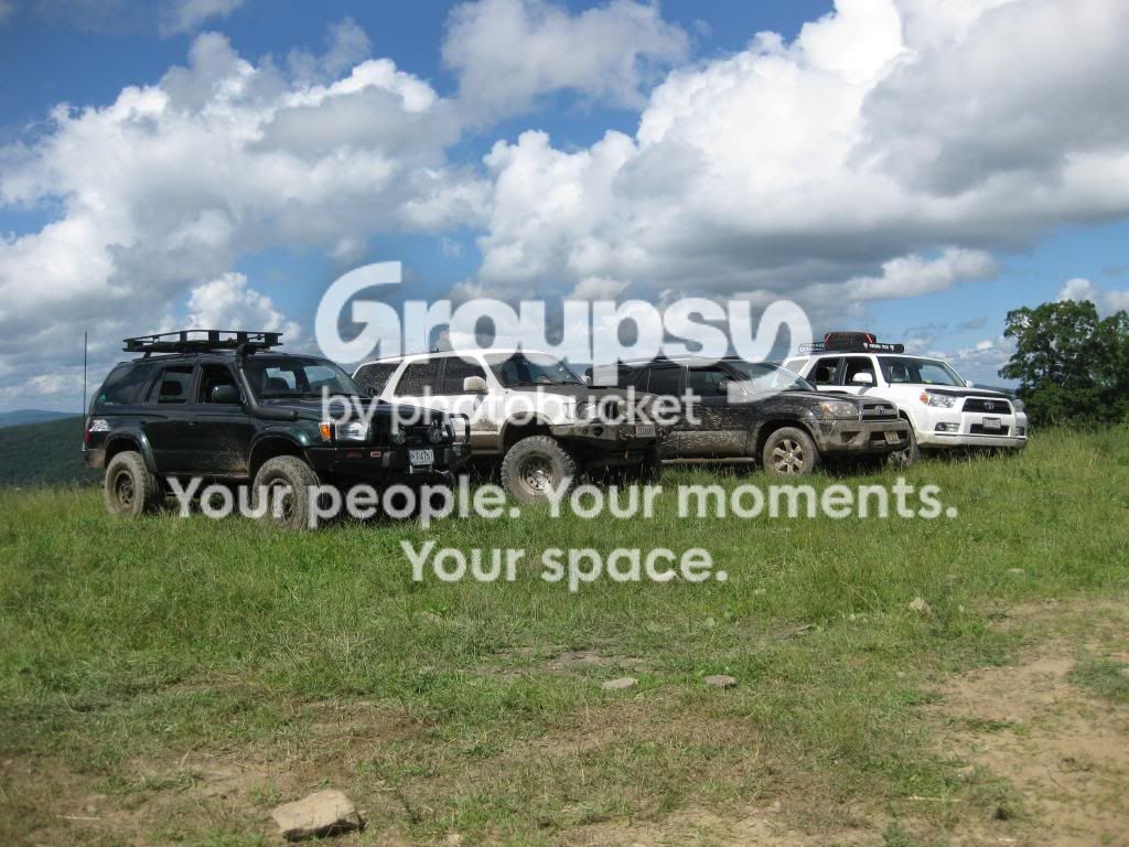

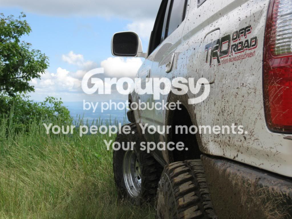

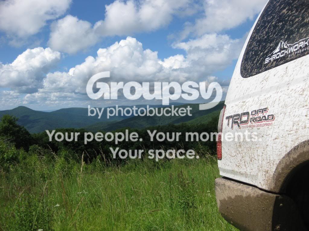

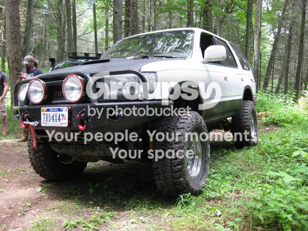

This weekend I was able to get out and hit the trails with a group of T4R members. We ran Flagpole Knob and Meadow Knob in the George Washington National Forest just outside of Harrisonburg, VA. Overall it was a great day with a great group of guys and I can't wait to get out there again sometime soon!
Airing down
At the top of Flagpole Knob
and at the top of Meadow Knob
My 2 favorites from the day (so far)

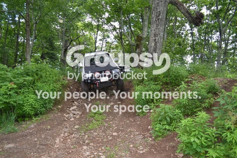

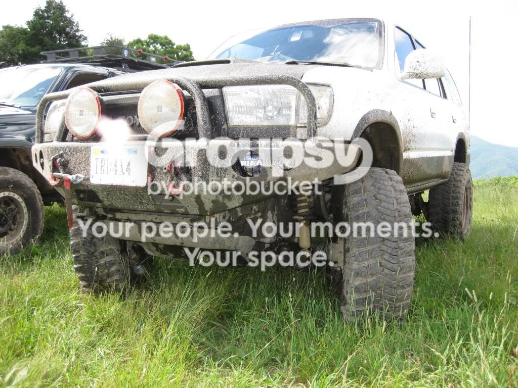

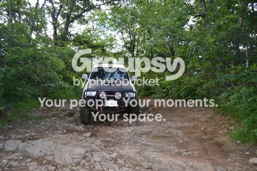

The trails were pretty easy with the exception of a couple of technical sections that required a spotter to get the stock truck through. The most technical section was an uphill climb over some pretty big boulders. Fortunately for the stock trucks in the group, it had bypasses so they could still get through without any issues, but I was determined to take the hard line and make it through. I made it a little ways up, but even with 4WD and the rear locker, the slick rocks and mud wouldn't let me get the traction I needed to make it to the top. So, I ended up having to winch myself up the rest of the way. This was the first time that I had to use the winch on the trails and I must say that I am very happy and impressed with how well it did. (I was a little busy at the time so I don't have any pics, but I know some of the other guys in the group were taking pics so hopefully I can get some from them)
[MENTION=89072]Tresvn[/MENTION] was able to get a couple videos, including one of the recovery. Thanks for sharing Brian!
The video doesn't really do the spot justice, but here's a pic of where I got stuck.

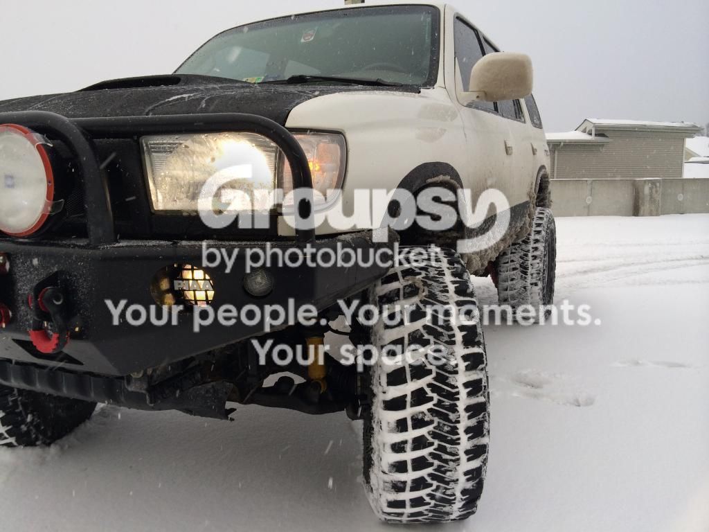

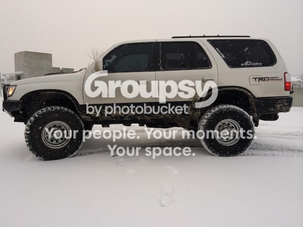

Over the past several months, I really haven't done much in the way of upgrades, I have just been sticking to routine maintenance. It has been a pretty cold and long winter for us and we have gotten a lot of snow which makes it hard to work since I don't have a garage...

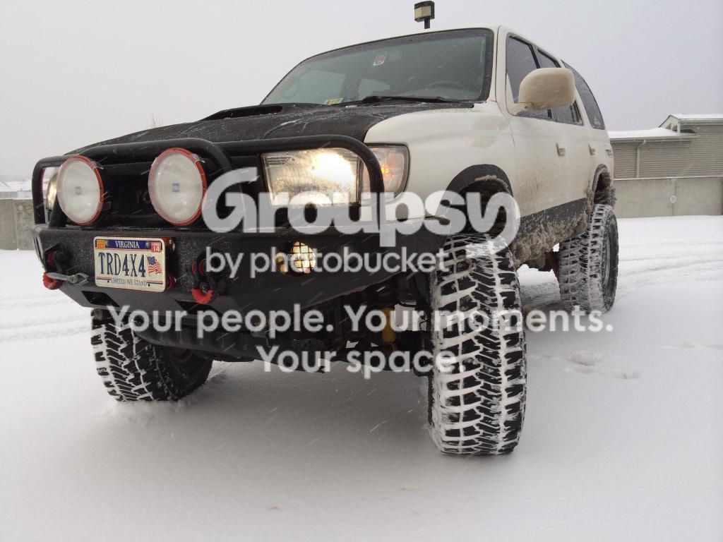

I was able to have some fun in the snow though…
And always had a parking spot…

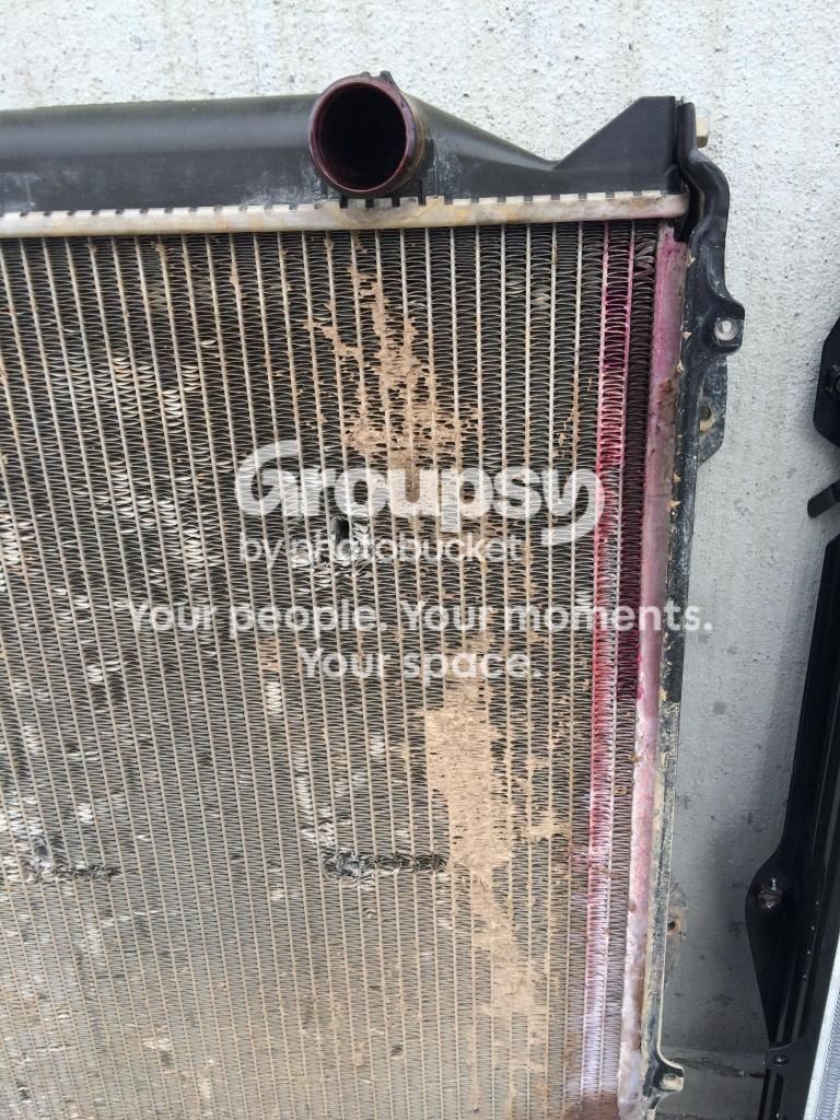

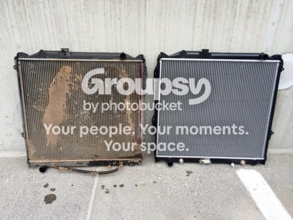

2) On the way to work a couple weeks ago I noticed that my temperature gauge started to creep up, even though I was driving in subzero temperatures. Fortunately I have a pretty short commute so I was able to make it to work and home without hitting dangerously high temperatures. I figured I was just low on radiator fluid so I added some when I got home when I opened the hood it immediately smelled like radiator fluid and I ended up having to add over 3 liters of fluid to fill the radiator so I immediately knew something was wrong. I looked around for leaks and didn’t find any so I inspected the radiator and found what I was looking for, an accumulation of radiator fluid in the upper corner…So I did a little research online and ended up ordering a new radiator from Amazon: Amazon.com: TYC 1998 Toyota 4Runner 1-Row Plastic Aluminum Replacement Radiator: Automotive. I know it probably isn’t as high quality as a Koyo or OEM, but funds are a little tight right now so I didn’t have many options. The replacement was pretty easy and straightforward, but just took a little longer than most people because I had to remove my Hella lights from my Shrockworks so I could remove the grille and access the radiator mounting bolts. I also had to cut and replace the zip ties that attach my external transmission cooler to the radiator and condenser. When I removed the old radiator is was immediately clear that it was indeed cracked so I’m glad I replaced it before it failed completely.
Old cracked radiator
Old vs. new
