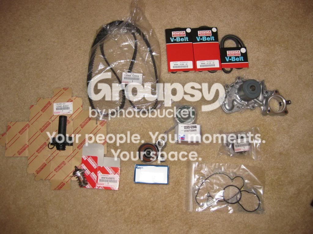

After spending more than half on my timing belt kit, I still had some $$ left over....So, I decided to upgrade my stereo head unit and just ordered this bad boy from Amazon: Amazon.com: Pioneer AVH-X3500BHS 2-DIN Multimedia DVD Receiver with 6.1 WVGA: Car Electronics. It has pretty much every feature I could possibly want/use and I have always wanted a double din unit so I'm pretty pumped!

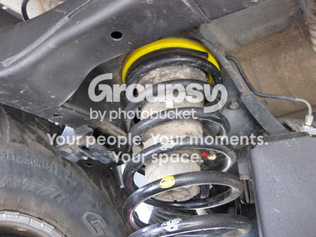

Exactly right. I don't remember the measurements off the top of my head, but I do remember that it brought that side up about 1/2". I will take some measurements when I get home from work today.

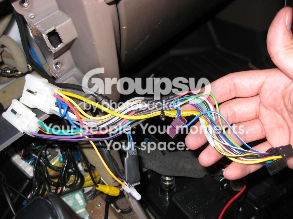

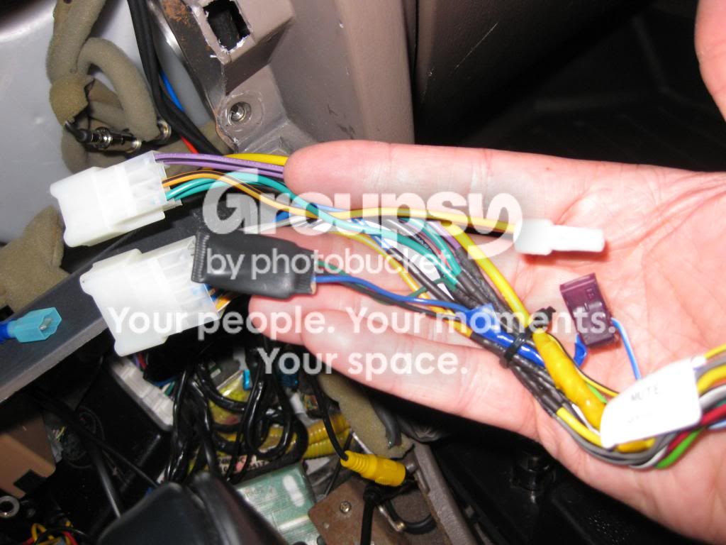

After removing the old Sony unit, I cut off the Sony wiring harness from the Metra wiring harness. I was careful not to cut too much of each since I would be reusing the Metra harness and selling the Sony harness with the head unit. After cutting off the old harness, I soldered and heat shrunk the Pioneer harness to the Metra harness.
Note: There were only 2 wires that are not used: 1) The orange wire with a black stripe on the Metra harness and 2) The yellow and black wire ("mute" wire) on the Pioneer harness. The white and purple wire on the Pioneer harness will only be used when connecting a rear view camera.
When soldering the two harnesses together, I was sure to include the Parking brake override relay wires. The override relay has 3 wires that match up to the wiring harness as so:
1) Black wire - This is a ground wire that is soldered in line with the other 2 black ground wires.
2) Green wire - This wire is attached to the light green parking brake wire on the Pioneer harness.
3) Blue wire - This wire is attached to the amp/antenna power wire. In my case this wire was soldered inline with the blue and white wire from the Pioneer harness and the blue wire from the Metra harness.
Here you can see the parking brake override relay (small black rectangle)

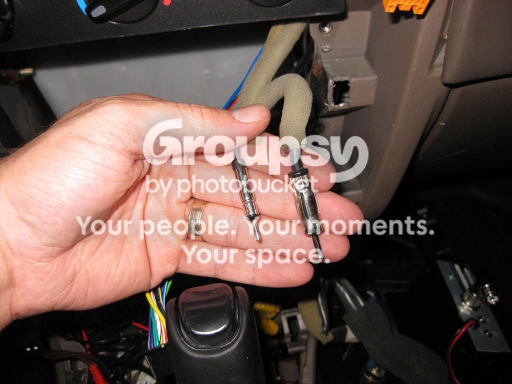

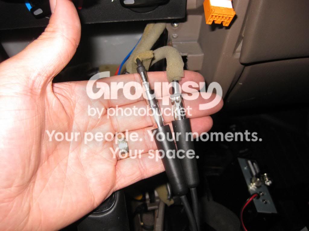

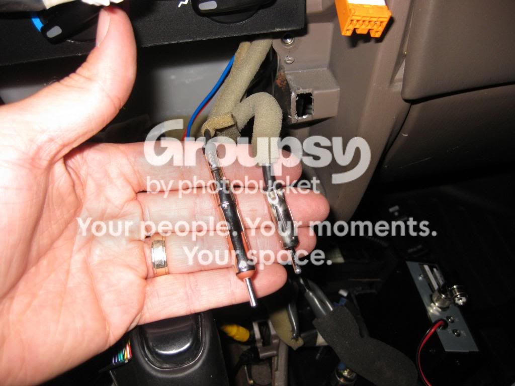

When you remove your factory head unit you will notice that you actually have 2 antenna wires. A large plug for the main front antenna and a smaller plug for the rear antenna.
Larger on right, smaller on left

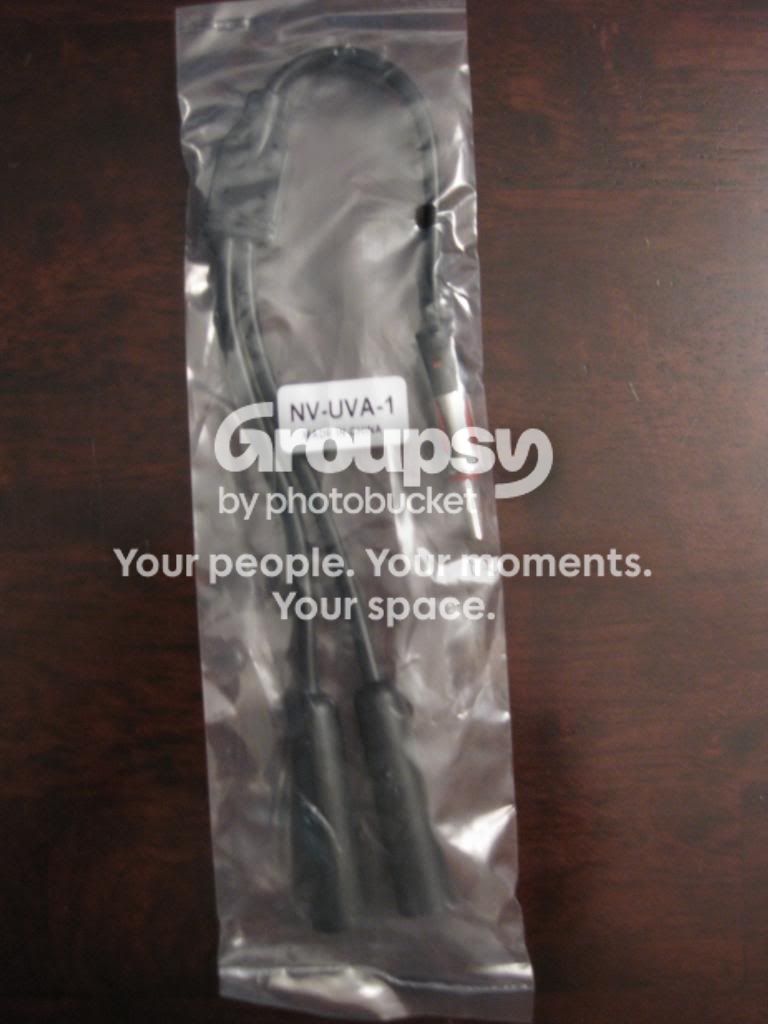

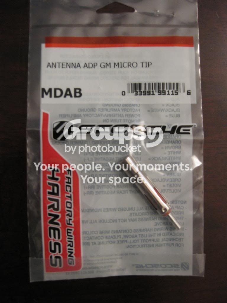

Since I bought an HD radio I wanted to make sure that I had the best reception possible so I bought a Scosche Mda-B Micro/Delco Antenna Adapter Tip and a Metra Ltd 40-UV43 Motorola Antenna Y-adapter.
The adapter tip converts the smaller rear antenna plug to the same size as the larger main antenna plug.
And the Y adapter allows you to connect both the front and rear antenna to the single antenna plug on the Pioneer unit.

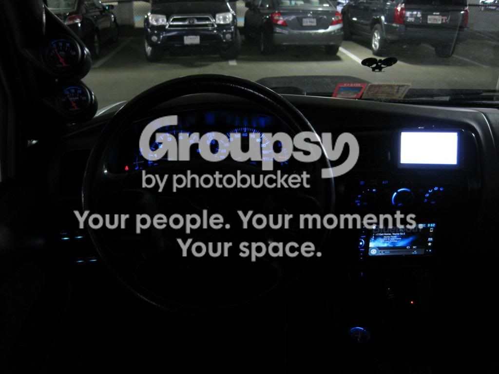

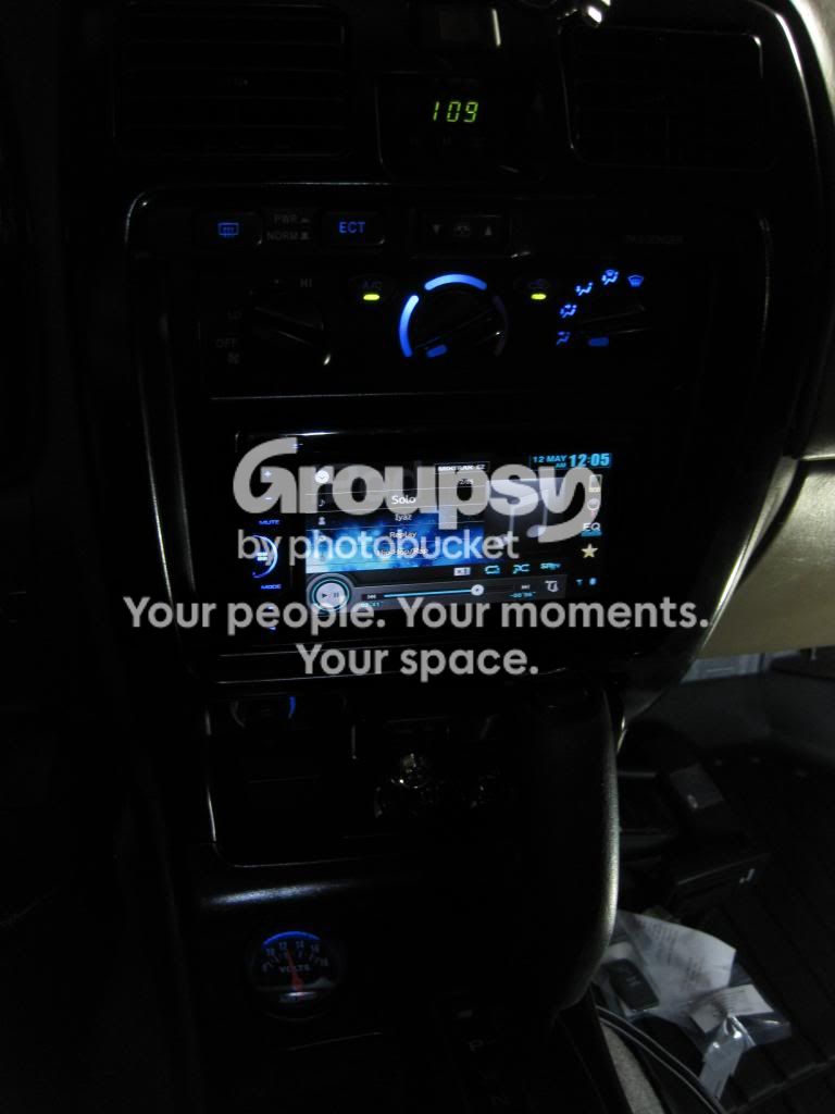

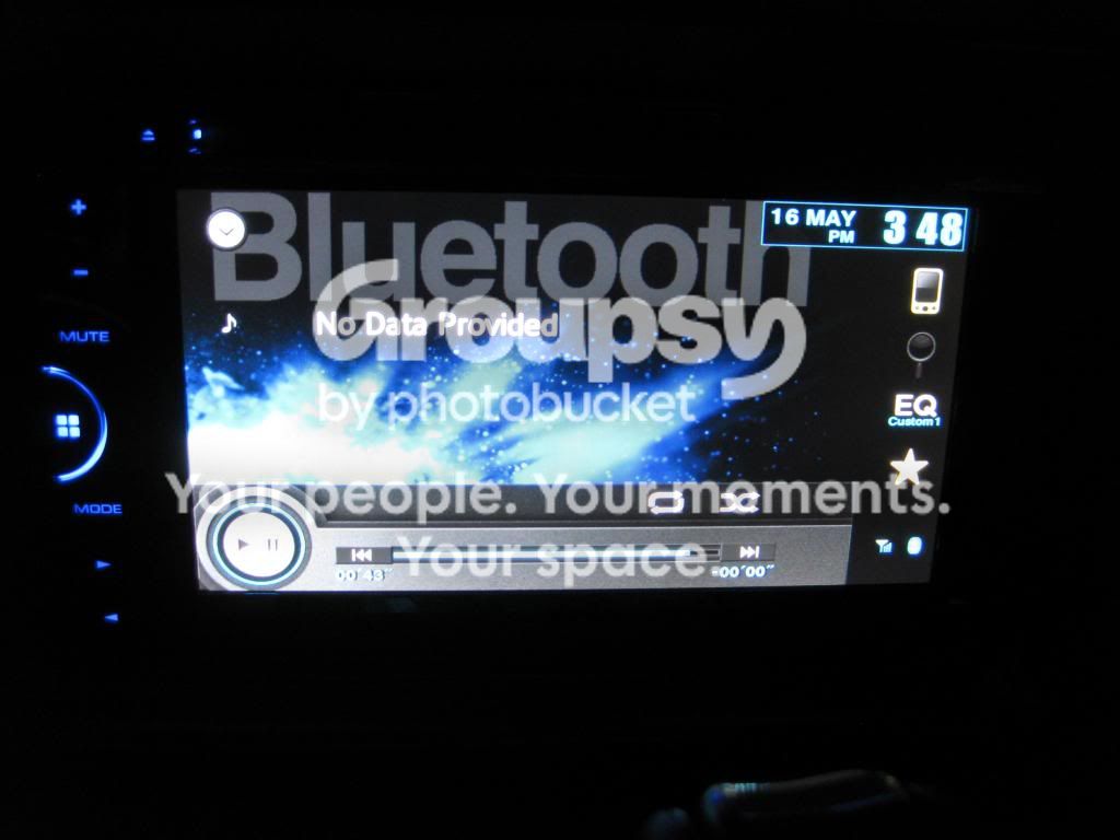

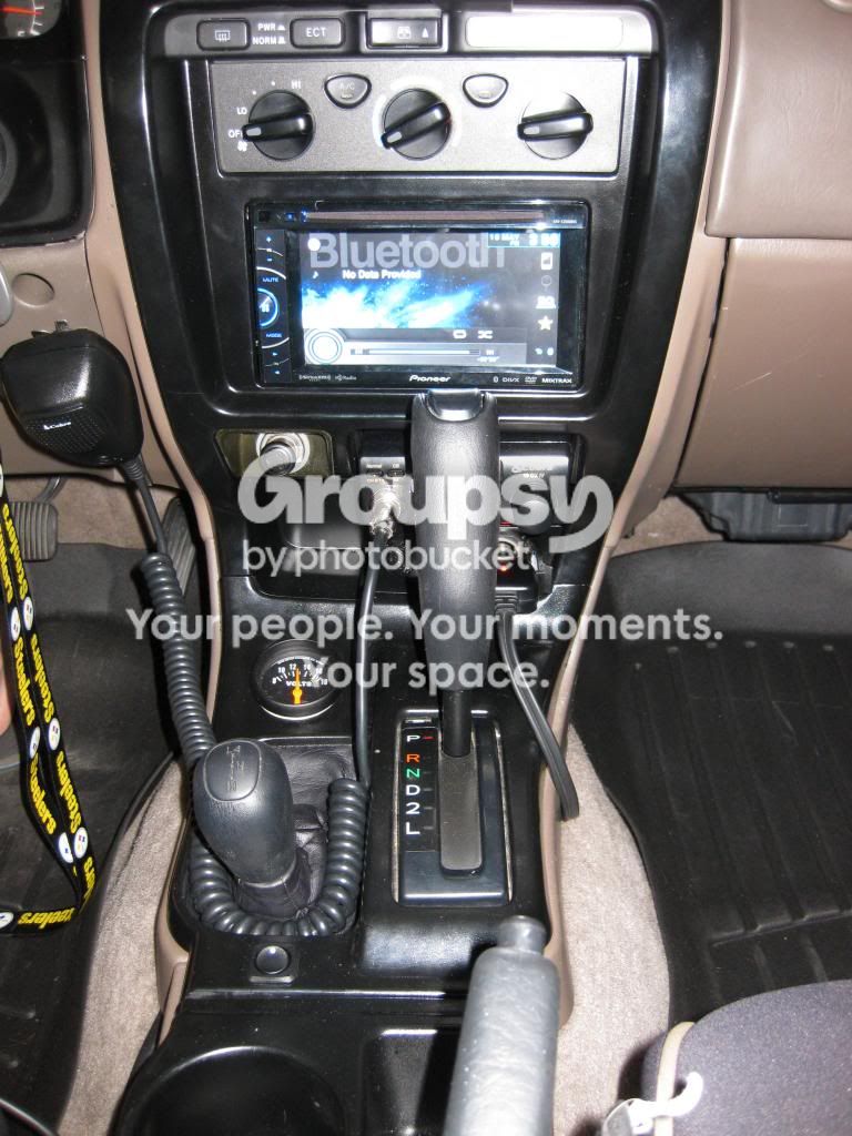

And after putting everything back together here's how it looks.

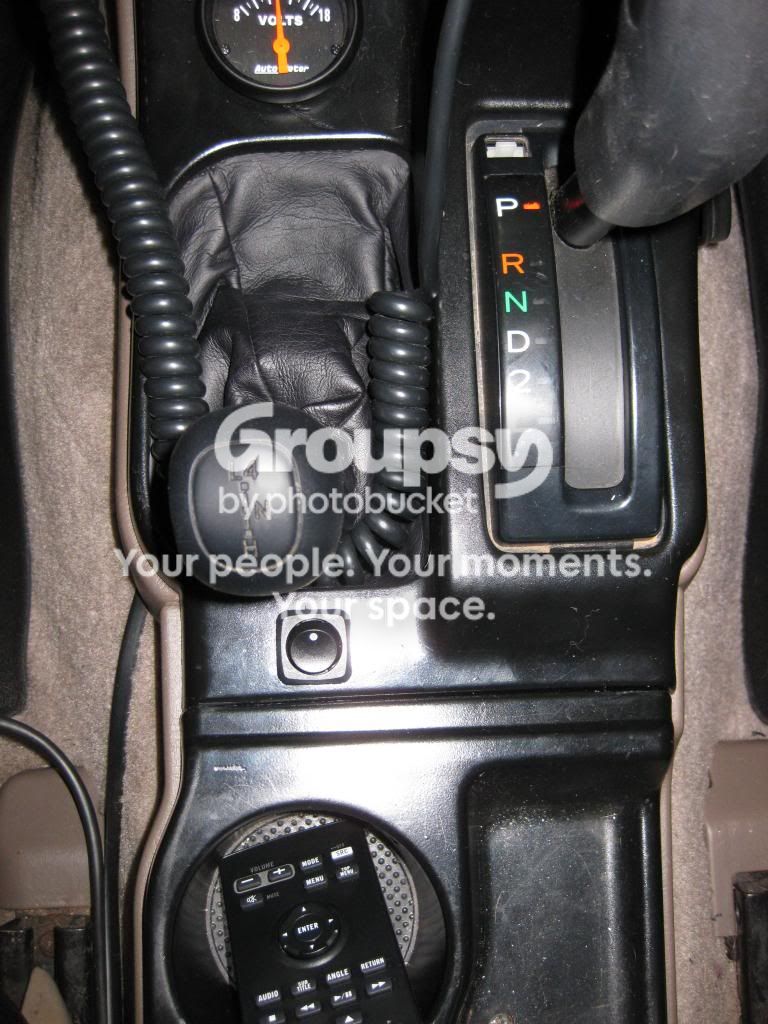

Finally, I noticed that with the new Pioneer unit, my antenna is up and stays up whenever the stereo is on, regardless of whether or not I am listening to the radio. While this isn't a huge deal, I don't like the idea of having the antenna up when I wanted to listen to music via iPod/iPhone while wheeling. So, I went to my local radio shack and I picked up a simple on-off switch. I cut the blue (antenna power) wire on the Metra harness and soldered a length of wire to each end and ran those to the switch. Now, I can raise and lower my antenna with the simple flip of a switch. Not difficult at all, but super useful!
Here is where I mounted the switch.

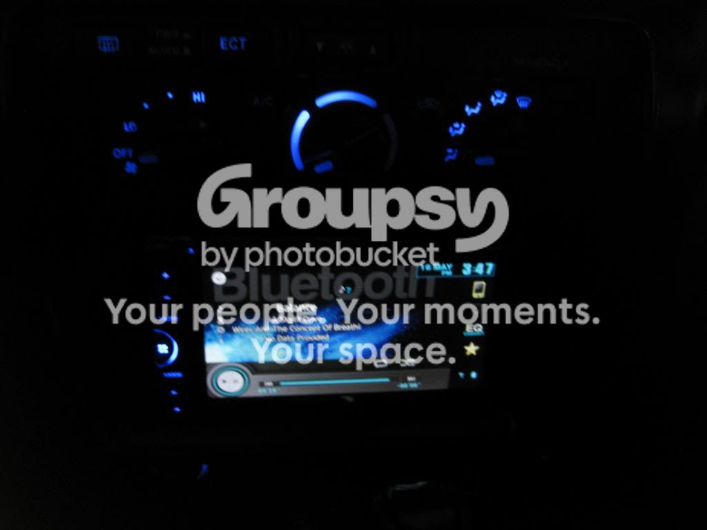

And an overall night shot

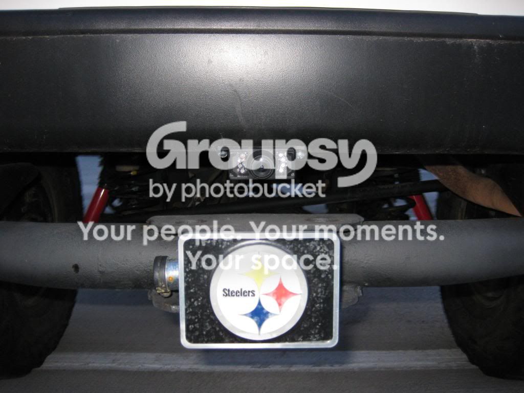

1) As promised, here are some install pics of my rear view camera. I wanted to keep it low profile so I mounted it to the underside of my stock bumper. It was a PITA to get a drill in the right spot to drill the 2 mounting holes, but other than that it wasn't too bad.
One downside with this location is that it is a little too low, so the scale for the green/yellow/red zones built into the camera aren't to scale at all. It will take a little getting used to, but I have no desire to mount it anywhere else.

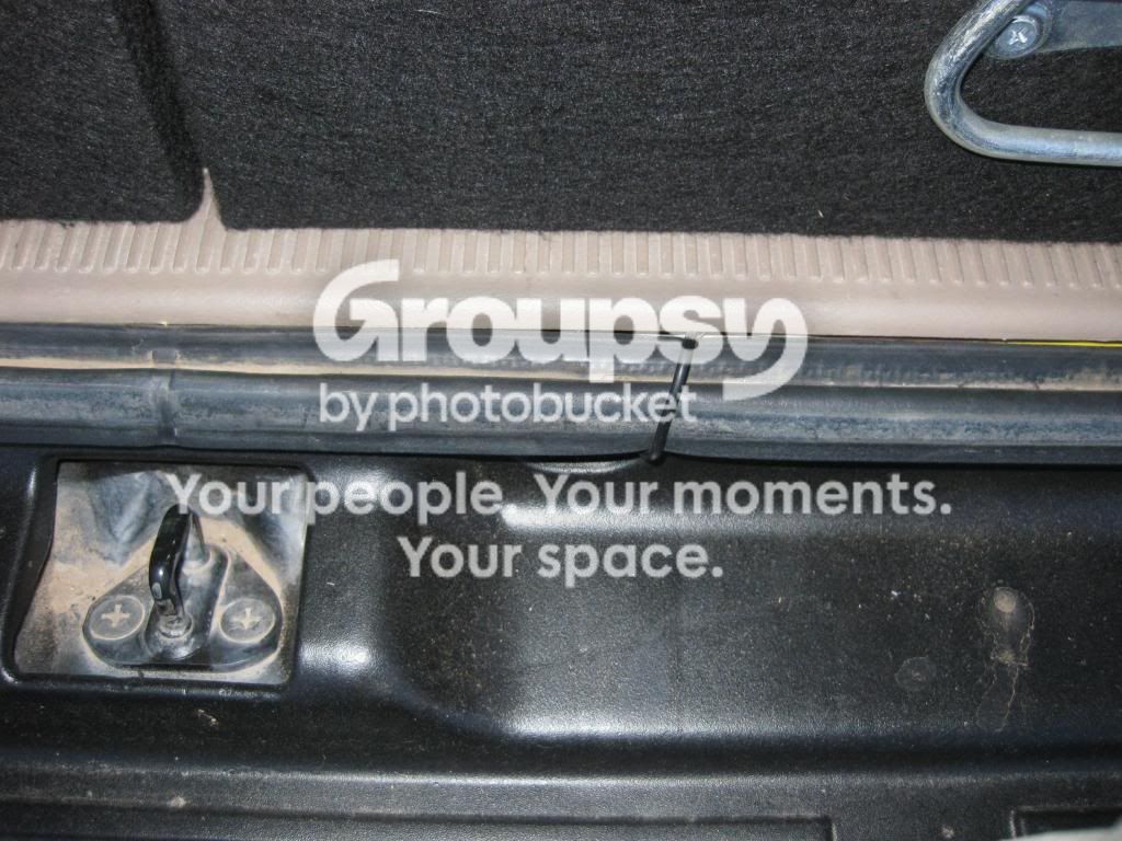

For the wiring, I ran them from the camera through the hole for the spare tire winch, into the trunk, and along the trim panels in the trunk. I tapped the power and ground wires into the passenger side reverse light so the camera powers on whenever the truck is in reverse.
The yellow video cable runs from the radio along the passenger side trim panels to the trunk.

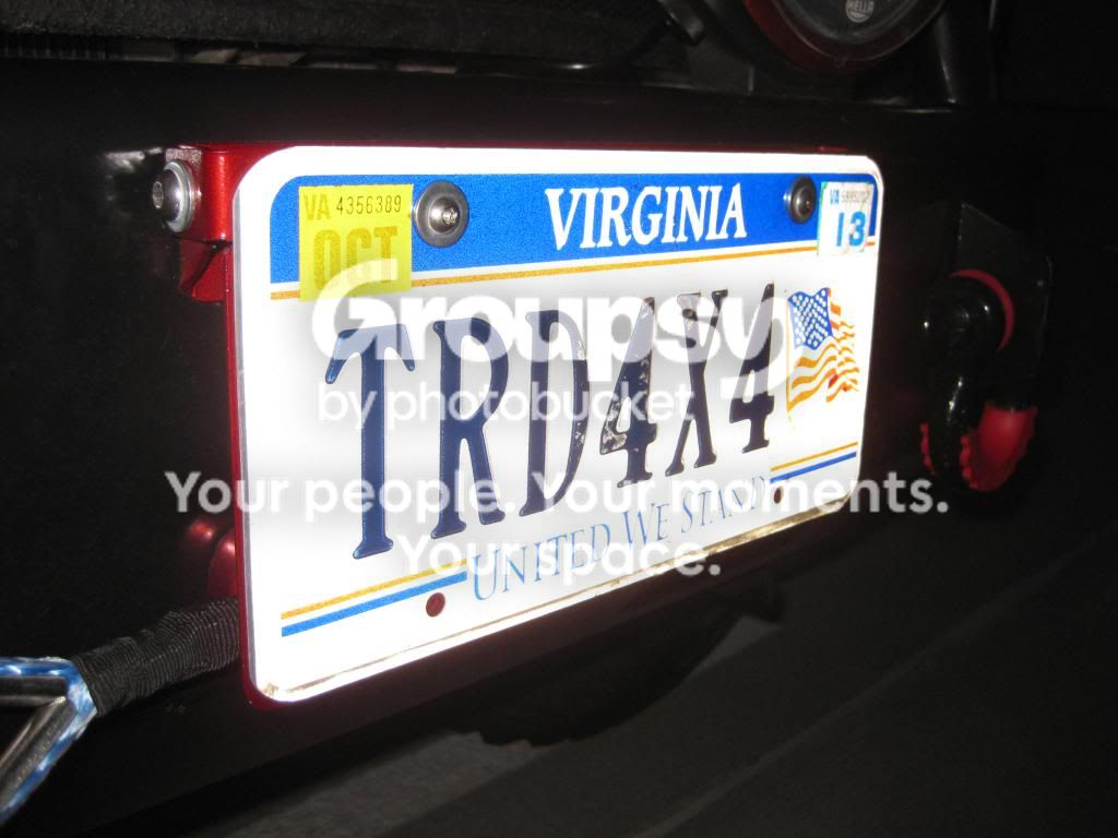

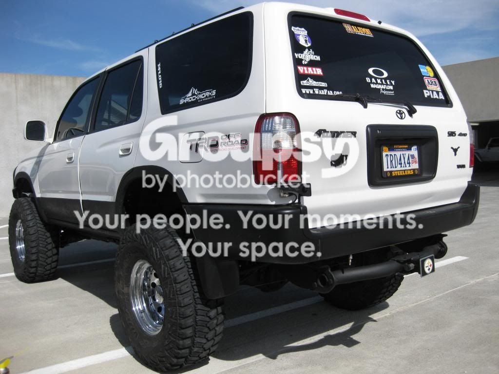

2) I received my license plate mount from Shrockworks. I ordered it in bare steel so I hit it with some Duplicolor Metalcast to match the other red accents.

I see what you did there. those pictures are like a 4runner strip tease. lol. i like the placement of the camera. on another note, does that gap between the bumper and hitch ever bother you? thinking about doing the 2" body lift but not looking forward to gaps... gaps everywhere
Haha thanks man!
As far as the gap between the bumper and hitch, it does bother me a little bit, but it really isn't too bad. My biggest problem with it is that it hurts the overall clearance in the rear because I have scraped it and bumped it numerous times. While it saves my bumper from being destroyed, it would be nice to have it be flush with the bumper so I have the extra clearance. Eventually I am going to get an aftermarket rear bumper with a built in hitch so I can just put up with it until then.
i feel ya. Mines one step up from a mall crawler since its 2wd and I live in the flat land called florida. lol. as far as clearance, theres nothing getting up that high, and the hitch has saved my bumper once from a rear end collision. I did see a guy that remounted his, but i think he welded it. Other than that, id love to do a bumper too, but schools got me on a budget that doesn't leave me with much... that and the now 15 mpgs that i get vs 19 before lift+ tires.
