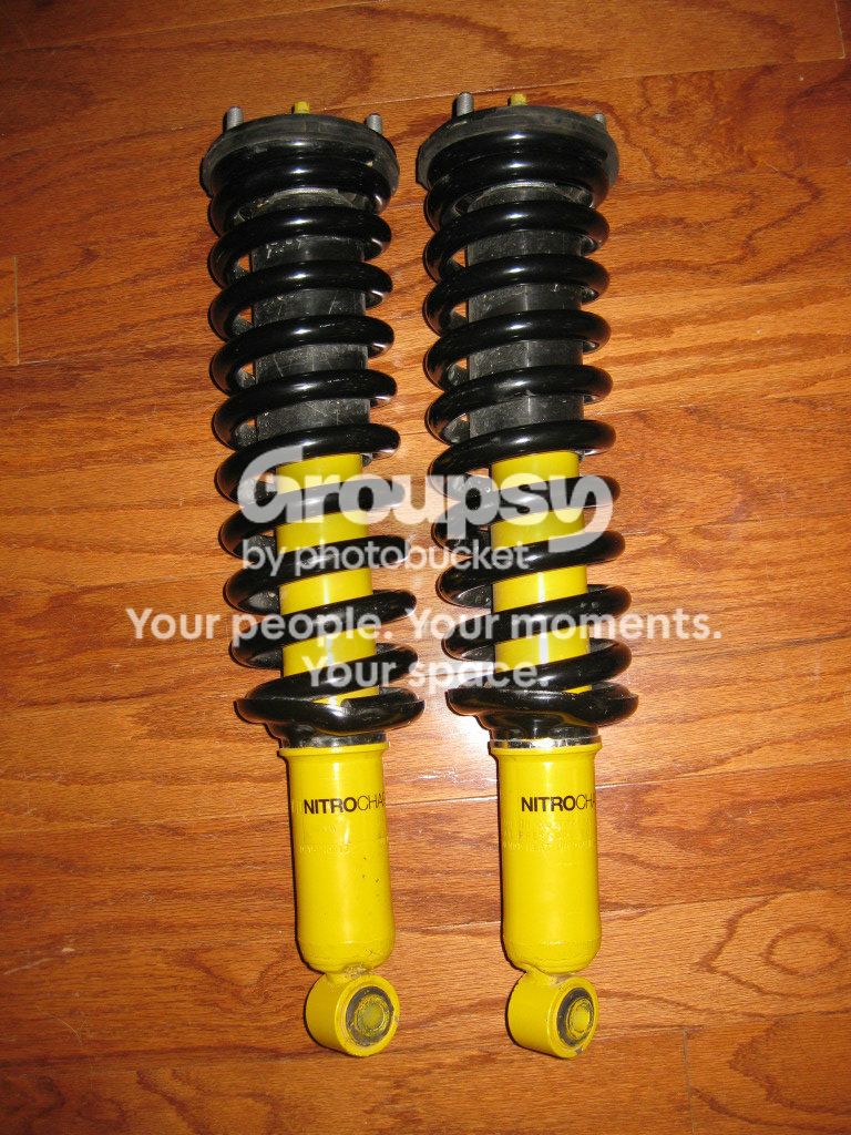

I just got these beauties in the mail yesterday!
IMG_0478.jpg~original
Although I really wanted to wait and save for coilovers, these will suit my needs just fine, they are in really good shape, and they are already assembled.

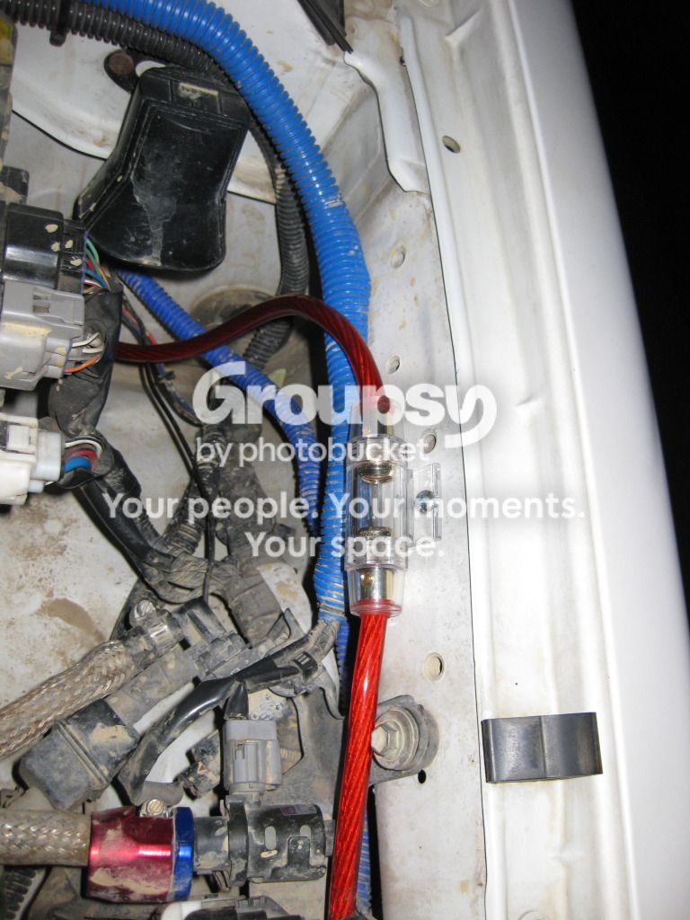

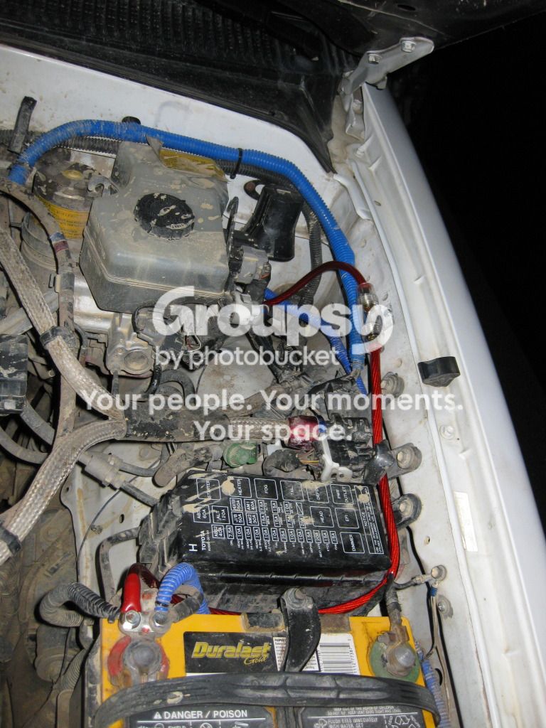

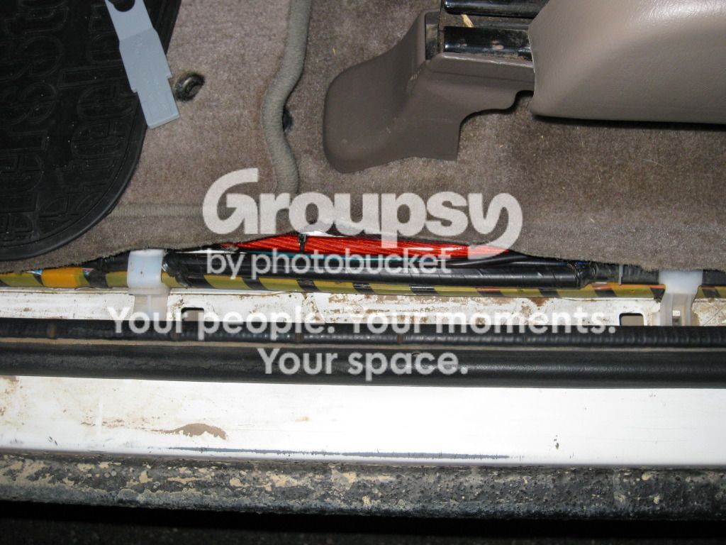

I also had some time to start the wiring process. Previously I had an 8ga fused 12+ power wire running from the battery back to my amp to power my subs. I removed the 8ga wire and replaced it with the new 4ga wire. I also ran a 14ga "relay" wire that will run from the rocker switch to the relay/pressure switch.
New 4ga power wire and 40amp fuse
IMG_0485.jpg~original
IMG_0486.jpg~original
Ran the power wire and relay wire under the plastic floor panels on the driver side

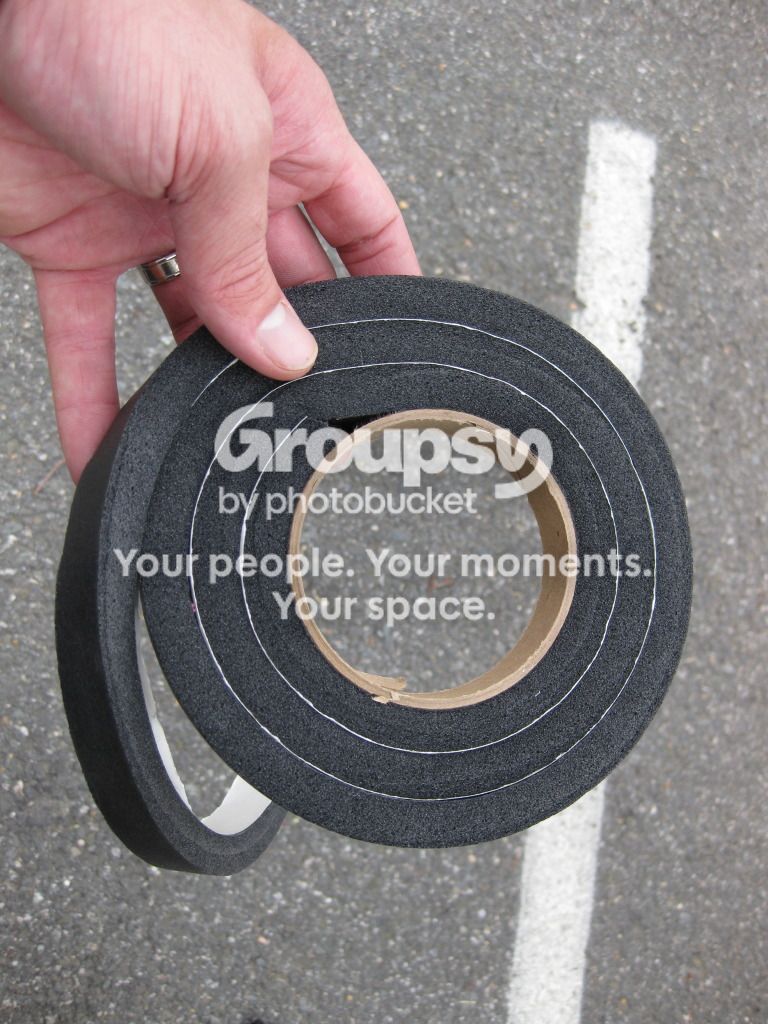

Before I installed the compressor, I put down some foam weather stripping and gorilla tape to keep the compressor from rattling on the body panel. It also helped to dampen the noise.

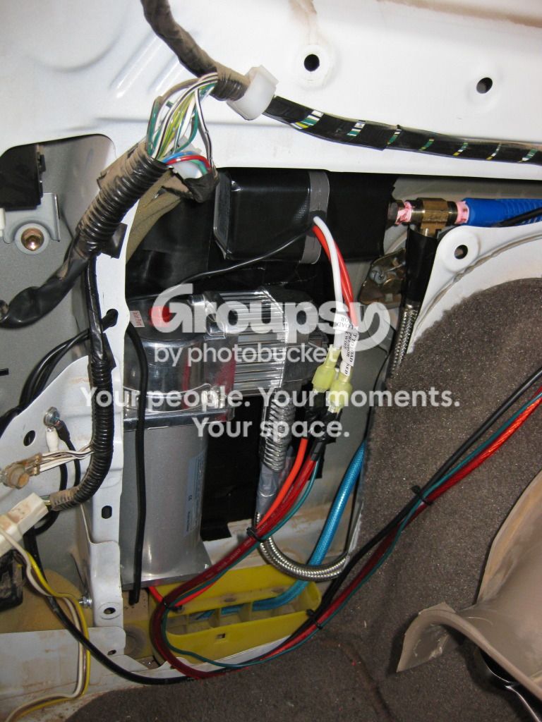

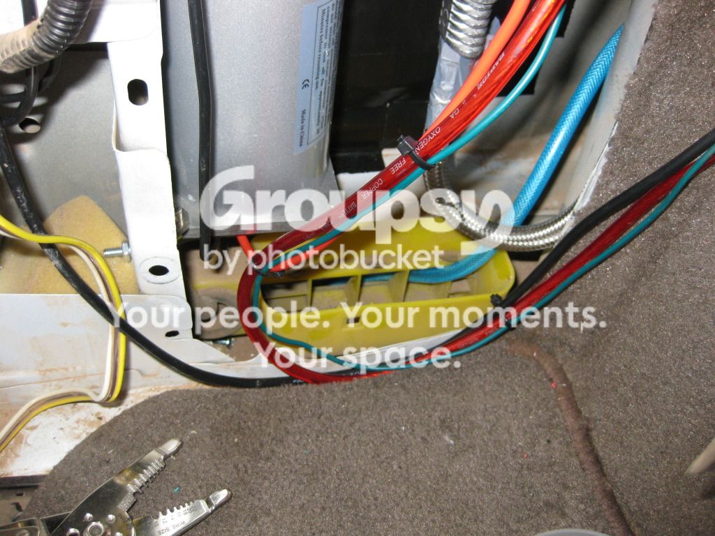

Installed! The leader hose from the compressor runs to a T-fitting. On the left side of the fitting is the pressure switch/relay and on the right side of the fitting is a polyurethane (blue) air hose that runs to the exterior mounting point.
IMG_0482.jpg~original
I used removable connectors to make all the wire connections just in case the compressor needs to be removed. You can also see the polyurethane hose that runs to the exterior.
IMG_0484.jpg~original
Other notes:
1) The pictures do not show the metal Viair air filter. The metal filter screws into the hole at the top of the compressor (in the pictures, the hole is covered with a red plug).
2) Before I put the trim panels back on, I covered all the exposed wires in plastic wire conduit to protect them from heat/damage.

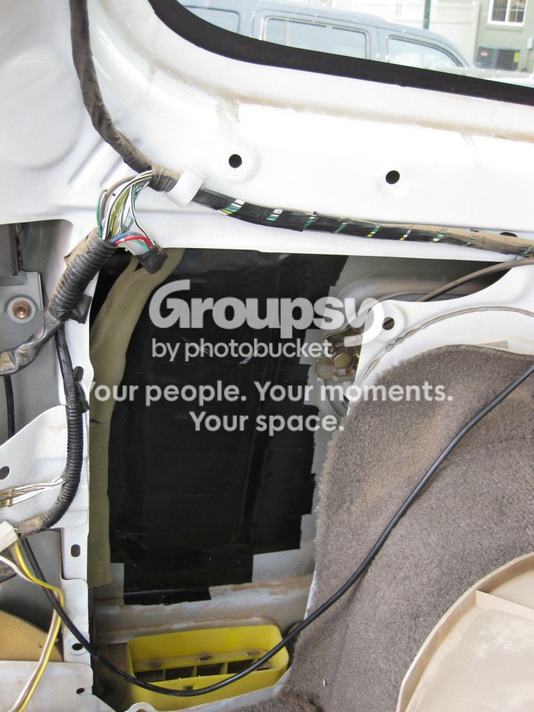

3) In order to get the compressor to fit in this location, you have to remove the plastic baffle that covers the air vents on the trim panel. I used more weather stripping and gorilla tape on the trim panel where the baffle used to be in order to keep the noise down as much as possible.
4) With where the compressor is mounted, only 2 of the 4 mounting holes are able to be used. In order to keep the compressor from rattling around, I fed the non-securing side of a long zip tie with a washer through the second mounting hole on the top compressor mount. The washer keeps the zip tie securing side from pulling through the compressor mounting hole I then fed the zip tie through a miscellaneous hole in the "body" panel that the compressor is mounted to. I secured the zip tie with a washer and the securing part of another zip tie.
