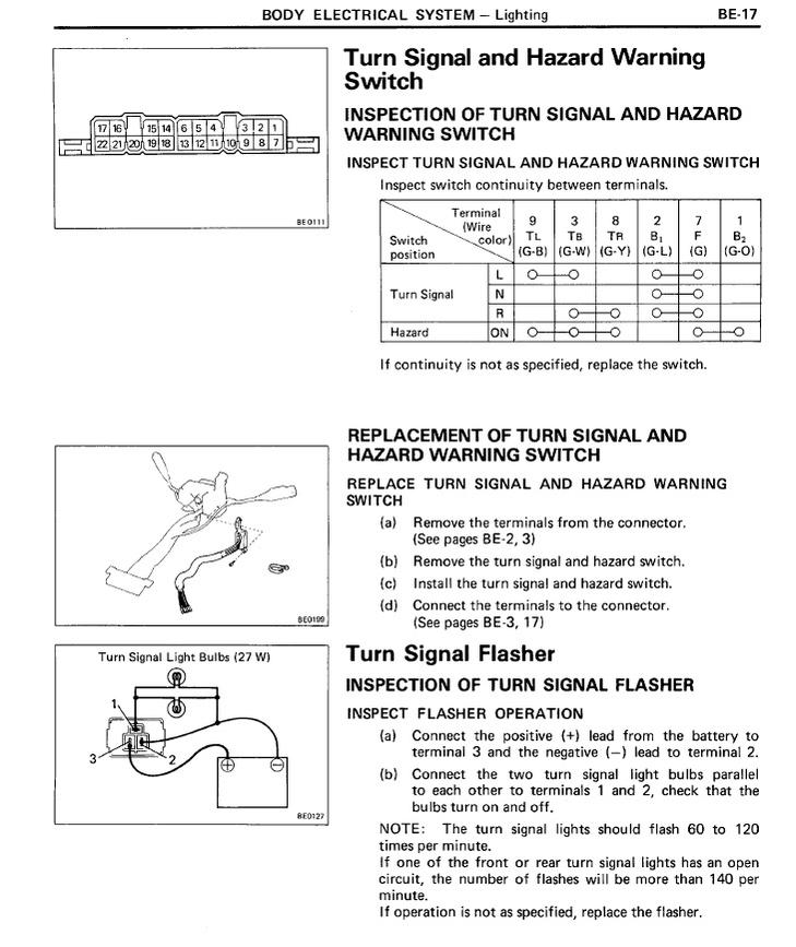

Here's how the turn signals work.
O.P.,
Start by checking if you have 12Volts on B1 pin (Green and Blue wire) of turn signal switch/stalk.
If not trace the wire back to the Engine Fuse.
Then, let us know.

I downloaded a FSM this morning, and I wanted to upload a page which can be a quick reference if somebody's dealing with the same problem than me:
