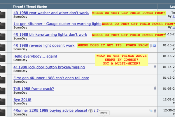

This symptom points back to... guess...

Did you get a multi-meter?
Promise: No more posts asking about electrical problems until I get my multi-meter, I ordered it online last weekend and I'm still waiting for it.

Always happy to help fellow owners, especially those who do their homework, like you did above.
I just posted pic above to help you narrow down the problems to the common area.
When ur ready with multi meter, we'll dive into it... together. :)
Actually I did not even notice that english is your second language. :)
Pls keep us posted on what you find out.
Start by checking voltage at your engine fuse.
