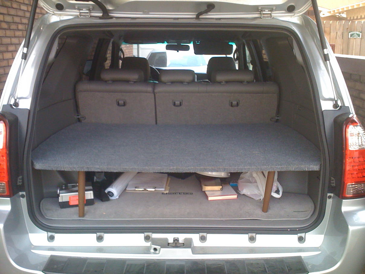

I built a raised platform just above the wheel wells and covered it with carpet. The sides over the wheel wells are hinged so they fold up for easy removal when I need space for larger items. The platform is made from 3/4" plywood. The supports are furniture legs. I plan to replace the furniture legs with a plywood support running from the back of the seat to the back of the platform, as this is the part I like the least. The over benefit of this is it give me some private space for my laptop bag, etc. Mine did not come with the retractable cover, which is an expensive dealer item.

The platform is simple to make, once you make a cardboard template of the shape of the space at this height. Incorporating the drawers from this post would make for an even better finished product.
