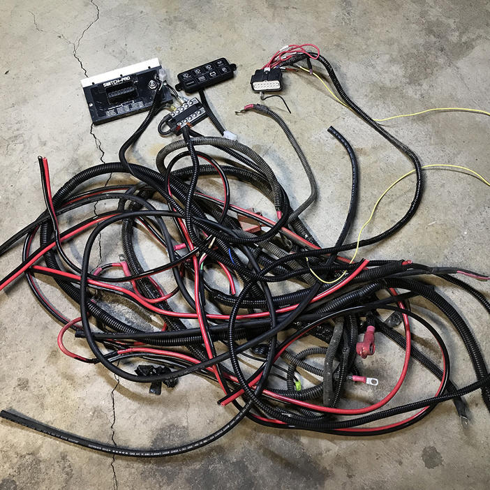

To begin this project will require the removal of the Switch Pros. There are a number of reasons why, but the primary reason is that it's a defective design. By that I mean it doesn't work the way the later models of the Switch Pros work, and upon being made aware of it, they chose to fix the issues in their next model, but nothing was done to address the issues in mine. Main key issue that makes it unusable is exiting the bluetooth app on the phone shuts down power to all outputs. In my case that meant using the app to turn on the camp lights (shown above) then turning them off and closing the app, and my fridge would lose power.
The second step will be the removal of all existing wiring/harnesses, and replacing them with harnesses that follow the same color-coding practices I use in my customer installs.

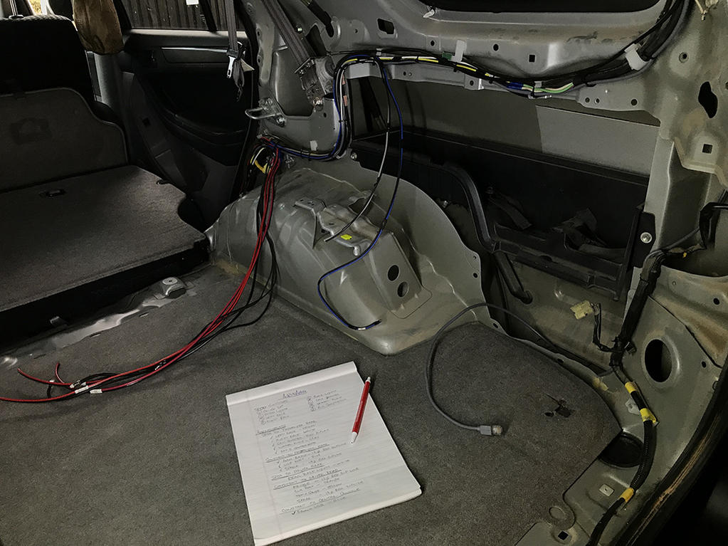

It began with tearing out the wiring for every accessory in the truck...
  • Right side and left side camp lights on the rack
  • Cell Booster (Wilson Electronics 801201)
  • Ham Radio (Yaesu 8800, for now, want FTM-100D)
  • Water pump (Living Overland Scepter MWC kit)
  • USB port
  • fuse box that was in the rear storage compartment that provided power to the Fridge, Ham Radio, the water pump, cell booster, and a USB port
  • Center console USB port
  • Switch Pros
  • Some miscellaneous underhood items
It left a lot of scrap wire! As well as the essentially useless Switch Pros.
Once that was out, the Ham Radio and Cell booster were removed to await placement in their new home in the front compartment of the Goose Gear drawer system. This was originally supposed to be a sort of hidden compartment to store a gun or two, but turns out the door is somewhat hard to open with the Fridge mounted in front of the drawer box, even with a decent gap between the two. So it will become home to those items.
Now that all the internal components have been removed, and the messy wiring out, it was time to start on getting some of the new stuff installed.

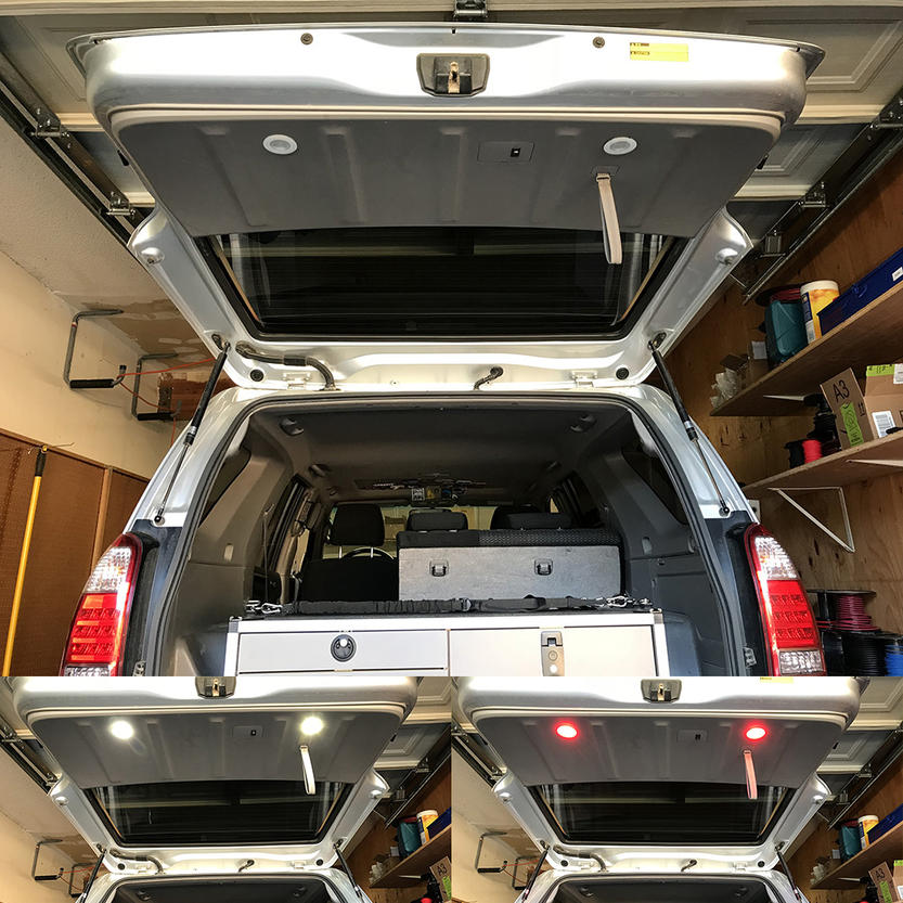

I chose to get to the Hatch lighting first, because it was a simple install that wasn't going to be part of the auxiliary electrical system. They are powered by a constant hot circuit in the factory harness within the hatch. The LED lights are from Lumitec, they're two color (White/Red), and came with a Police K9 Kennel kit that I used to install at my old job. I tapped the factory harness by crimping in a positive lead and a negative lead, put in a 5 amp inline fuse, and used a simple SPDT ON-OFF-ON switch allowing me to use one switch for both colors. It came out pretty good.

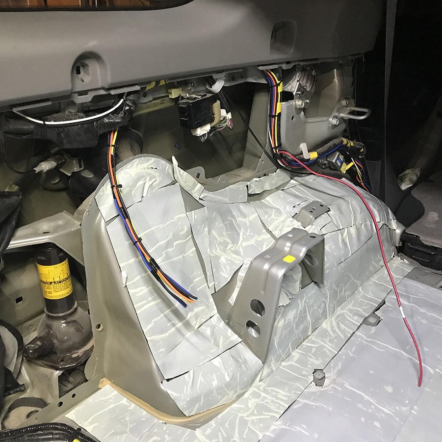

With that out of the way, it was time to move on to making the harnesses. There are two, one to go through the Driver firewall grommet, and the other to go through the Passenger firewall grommet.
Passenger Side Harness includes
  • Center Console USB Port Power+Ground
  • Ham Radio Power+Ground
  • Cell Phone Booster Power+Ground
  • Spare Power+Ground
  • Water Pump Power+Ground
  • USB Port Power+Ground
  • Right Roof Rack Camp Light Power+Ground
  • Left Roof Rack Camp Light Power+Ground
  • CAT5 Cable for Rear SPOD Control Head (Not included with the SPOD)
Driver Side Harness includes
  • SPOD Control Head Cable (CAT5, provided by SPOD)
  • Dome Light Sense wire (will be talked about later)
  • Fridge Power+Ground
  • USB Port Power+Ground (x2)
  • CLA (Cigarette Lighter Adapter) Power+Ground
  • Rear Four Rock Lights Power+Ground

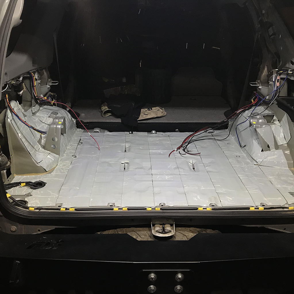

I also took the opportunity to lay down some sound absorbing material, Peel and Seal from Home Depot. Not the perfect stuff to use for this, but it's lighter than regular sound deadening material, goes on easier, and will do a "good enough" job for my liking.

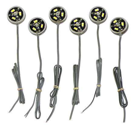

Instead of running the power for the rock lights entirely under the vehicle, I chained the rear four lights together and came up through a grommet in the floor in the left corner of the 4Runner, and connected the + and - to the wire provided in the driver side harness. The front four lights are chained together the same way and will follow the factory harness to where the SPOD is mounted where they'll tie in with the rear power wires.
The Rock Lights I chose are made by Off Road Only, called LiteSPOT's. Their kit comes with 8 lights. I put four in the rear. Two of the four lights are mounted in front of the rear wheels, and the other two are mounted behind the rear wheels. I did the same in the front, giving complete light coverage underneath the 4Runner. These lights have a super strong magnet molded into them, which is cool if you need/want to move them around, but they also have a hole in the center for securing in place, and I chose to do that.
Photos of these will follow once they get tied to the SPOD.
