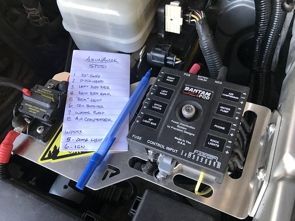

Now that the interior wiring is completed, harnesses are zip tied in place under the hood and firewall grommets siliconed, it's time to layout the SPOD.
  1. Baja Designs 20" OnX6 High Power light bar
  2. Ditch Lights (Future Addition)
  3. Rack Left Camp Light
  4. Rack Right Camp Light
  5. Rock Lights
  6. Cell Phone Booster
  7. Water Pump
  8. Air Compressor

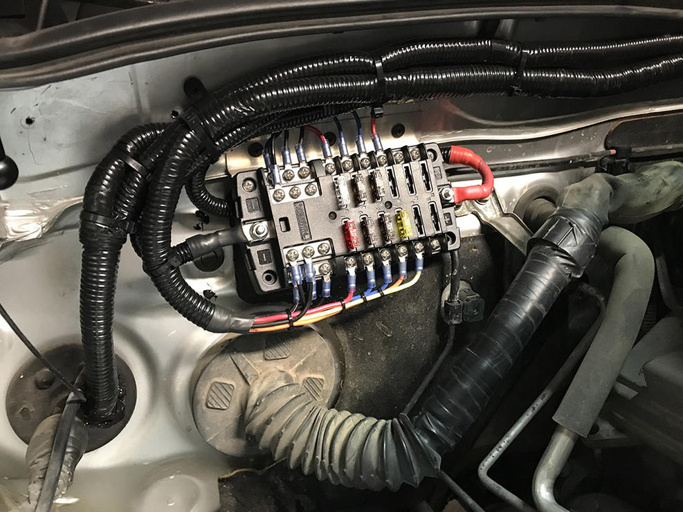

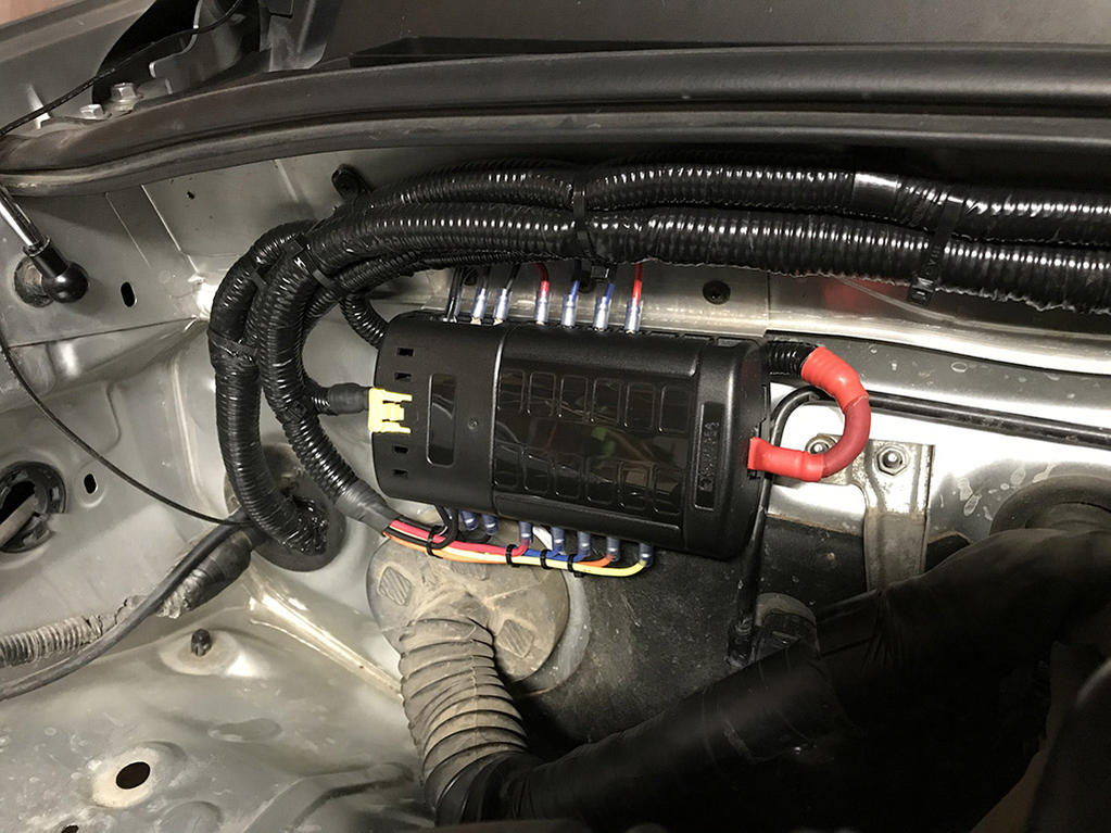

A 12 Circuit Blue Sea Fuse block will be mounted on the passenger side firewall and will handle all of the constant hot items
  • Console USB
  • Fridge
  • Ham Radio
  • Rear Passenger USB port
  • Two Rear Driver USB ports
  • Cigarette Lighter Adapter
  • Two Spare +/- Wires
  • Underhood Cigarette Lighter Adapter
  • Engine Bay Light

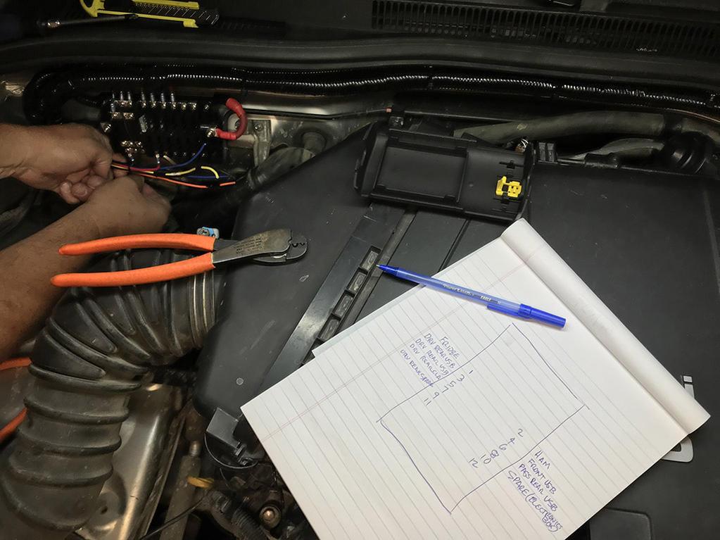

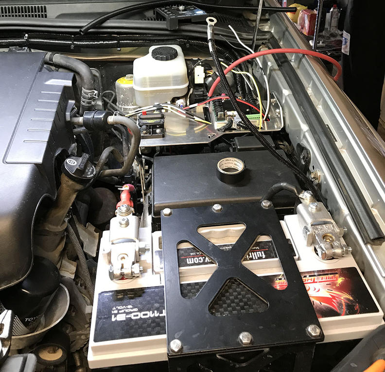

With the interior wiring finished, and the panels reinstalled, it's time to get under the hood and get the power and ground cables connected to the fuse block and connect the individual devices and their grounds to the fuse block.
Nice and tidy.
I decided I didn't like the clear lid. I want the fuse panel subdued, not highlighted. So I painted the inside of the cover black. And it came out awesome!
Now on to the driver side! Can't post that yet though :D

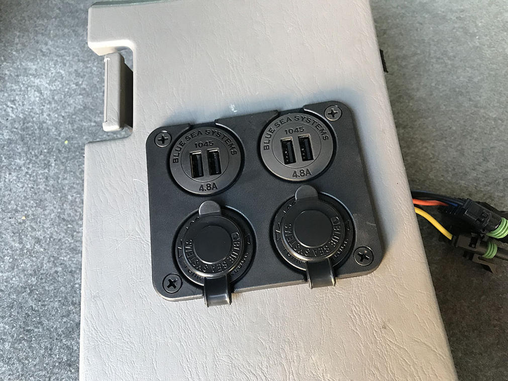

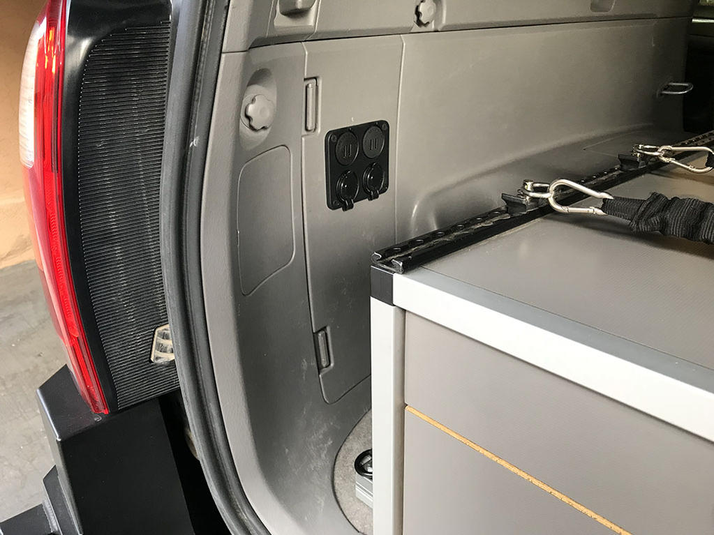

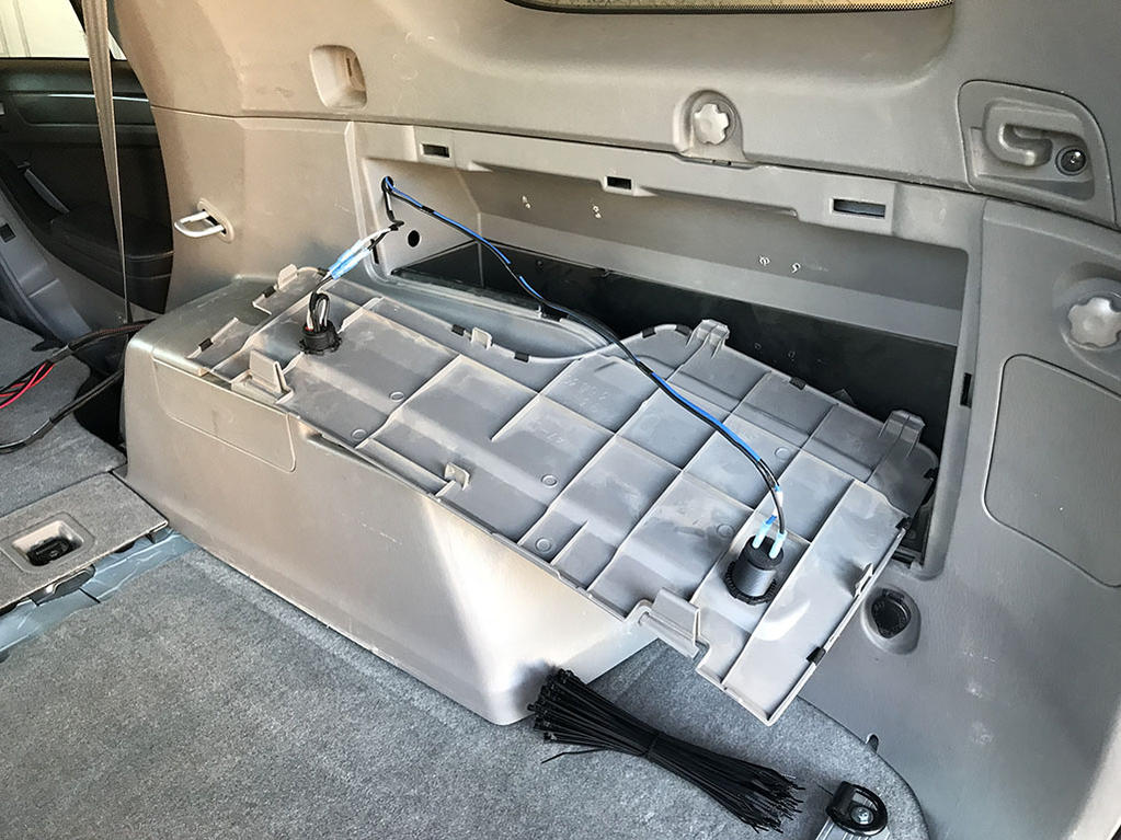

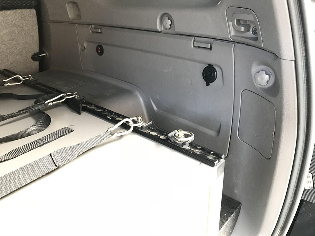

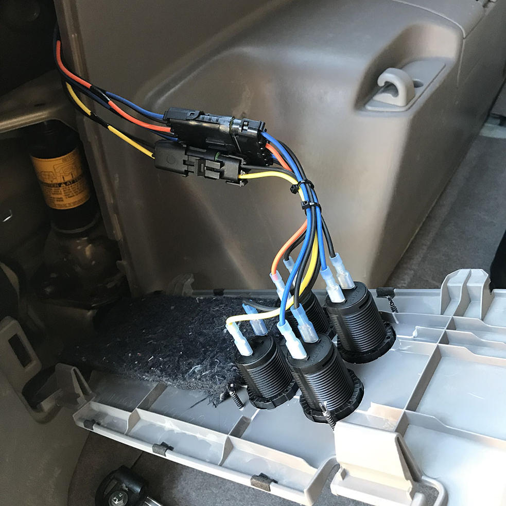

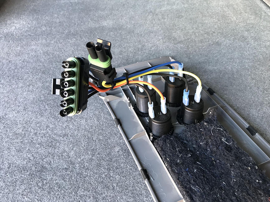

The charging station is on the left rear pocket that houses the jack and tire tool bag. This had to be removable, so pull out the weather-pack kit and make a plug set.
Two Blue Sea dual high-amp (4.8 amp) USB chargers, and two CLA's (cigarette lighter adapters) make up the charging station.

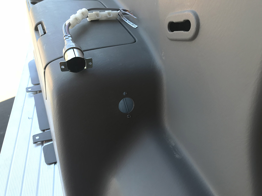

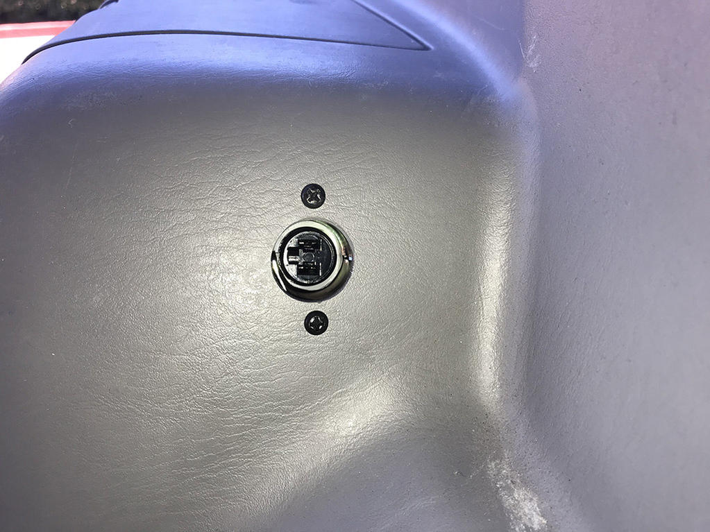

The passenger side gets the Living Overland water pump and another Blue Sea high-amp USB port. This particular USB is a remnant from the previous electrical setup when there was a fuse block inside this pocket. It was installed on a whim when Apryl told me she wanted a constant USB port for charging her phone. With the fuse block hiding behind that door, it was an easy install, and placed where she could leave her phone to charge worry free.
Well, the problem with that is it's right behind where the Scepter MWC will sit, and won't be accessible when the can resides in the truck (we don't always have it in there), but with four more USB's on the opposite side, we won't miss it. A little further back is a dual Anderson powerpole port where the water pump will plug in. They don't sell these in singles, so I got the double, and just looped the wiring into the second port. I have no idea what I would ever need to plug in the second port, but its there if I ever need it.

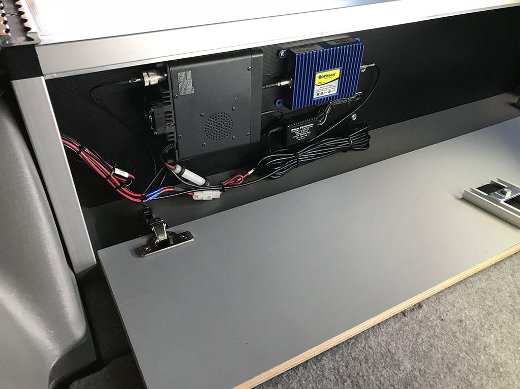

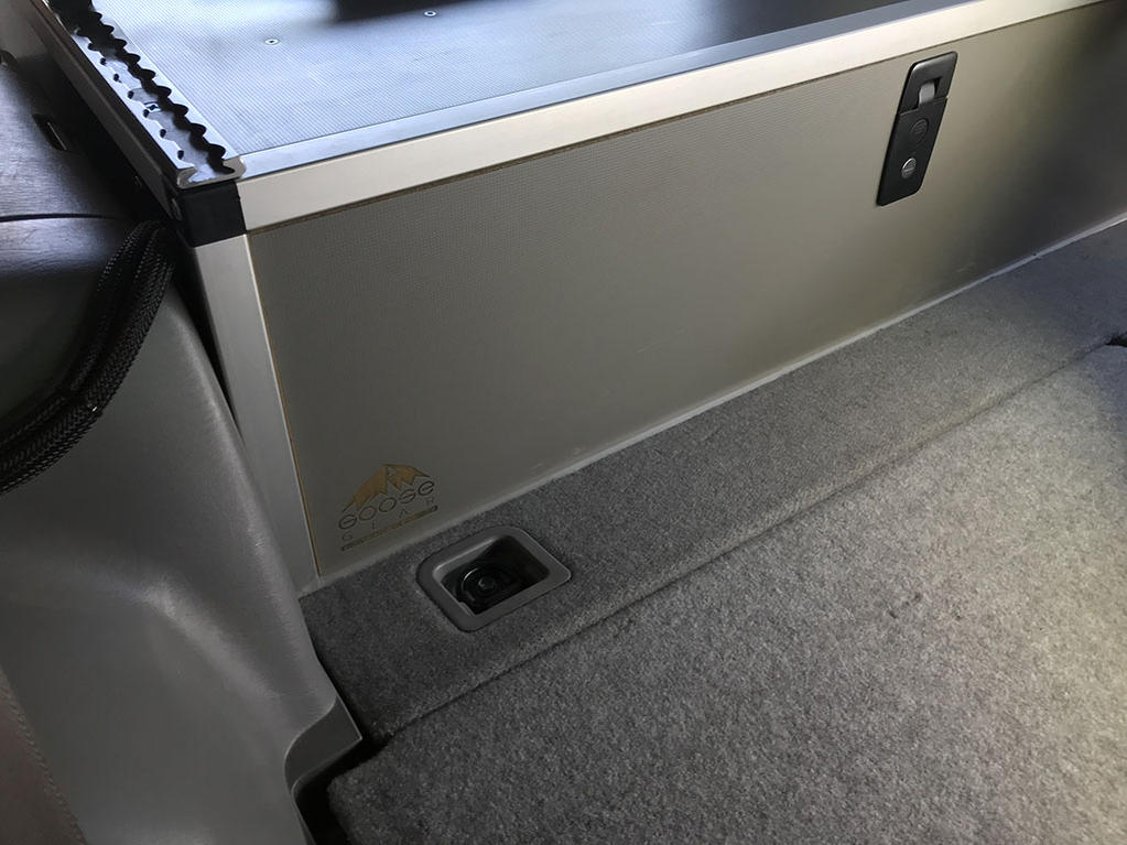

Now the back end is completely finished, with the exception of the second SPOD control head, which won't be here for a couple weeks, it's time to move to the front of the Goose Gear drawer box.
Some of you might remember when we built this box, my intention was a semi-hidden compartment for guns/etc. But when the fridge is in its home behind the driver seat, and camping gear is on the seat on the passenger side, getting into this compartment is somewhat of a pain, and we've never really used it for anything. So I decided to put the ham radio and the cell phone booster in there. These used to live in the storage pocket behind the water pump. This is what I should have done in the beginning.
With the door closed, these are well protected from anything!
I don't think Apryl will have a hard time choosing between the EIGHT constant hot USB ports placed strategically around the 4Runner to charge her phone and her little camp flashlight!

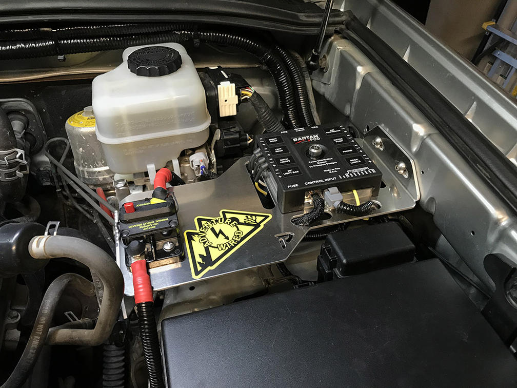

I've been given the go-ahead to show some snippets of the SPOD Bantam installation.
PowerTrays allowed me to buy a custom one-off tray specifically for the Bantam, his final product will be quite a bit different, but will be available to the public, and hopefully coincide with the release of the Bantam to the retail market.
Don't ask me the price, please, none of the testers know that info. Being a SPOD dealer, I was chosen to help beta test this unit, and when I turn this in, I will be buying a production model.
The new SPOD has some cool features that I'm taking advantage of to automate some things for me. Input triggers that sense either + or - will turn on corresponding outputs.

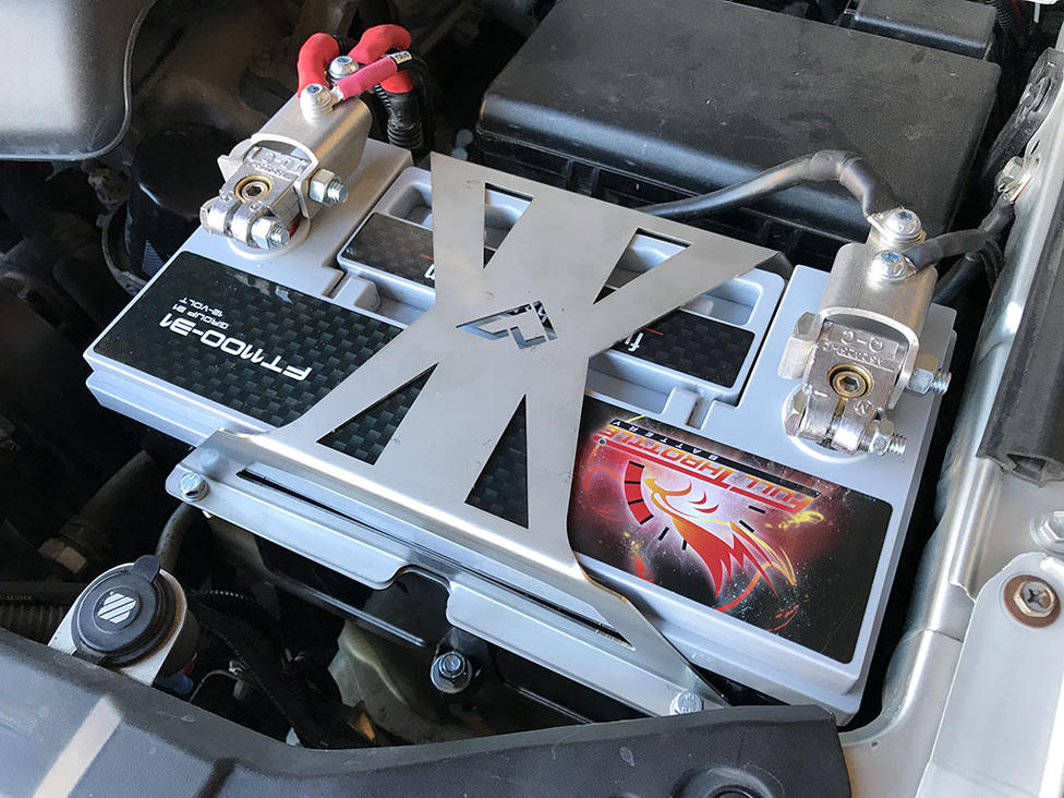

My battery cage used to be an Artec Group 31 cage, but on our last trip, for some reason it just stopped holding on to the battery, allowing it to rattle around, causing a horrible banging noise, and I could feel it in the footwell along the trail. So that's gone.
Immediately picked up a Pelfreybilt mount, which contrary to some opinions does in fact fit the 4th Gen 4Runners perfectly (I forget where I heard someone say it wouldn't fit). Now the battery is in tight, and won't move again. Those SLEE Offroad battery terminal extensions are pretty awesome too.
This is almost it, really. All of the crimping and zip-tying is done, a couple small things here and there, but otherwise, the re-wire is complete. The SPOD Bantam will change slightly from this version to the production version.
I'll get some interior shots of the installation sometime soon, I chose to go with two control heads for the Bantam, one on the dash, and one at the rear of the 4Runner, so I'll include those shots.
