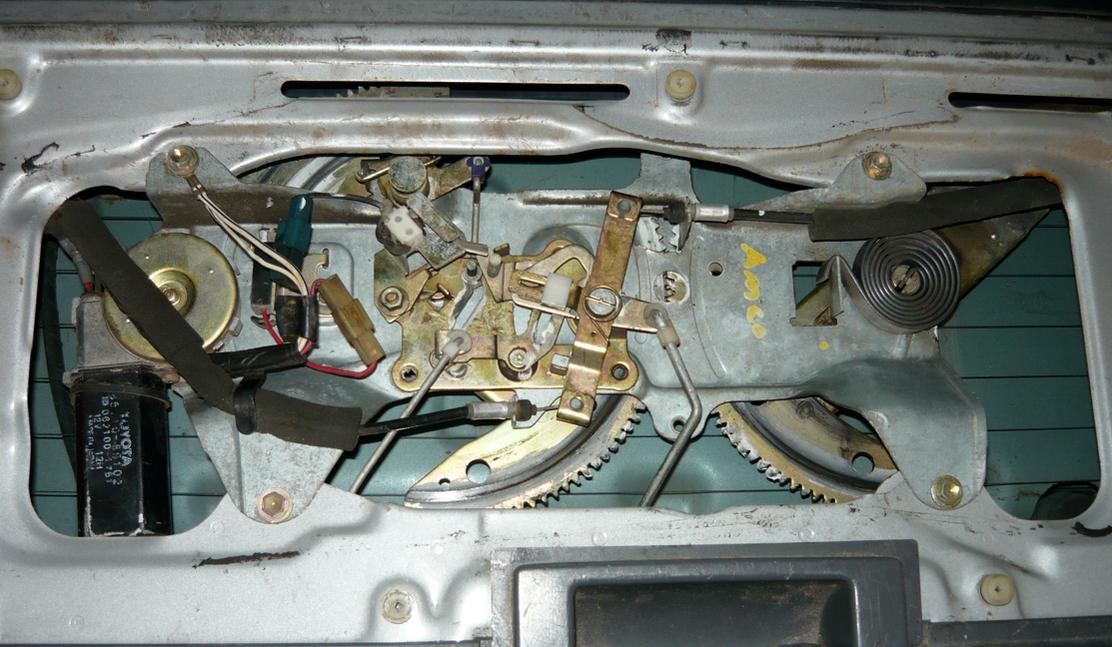

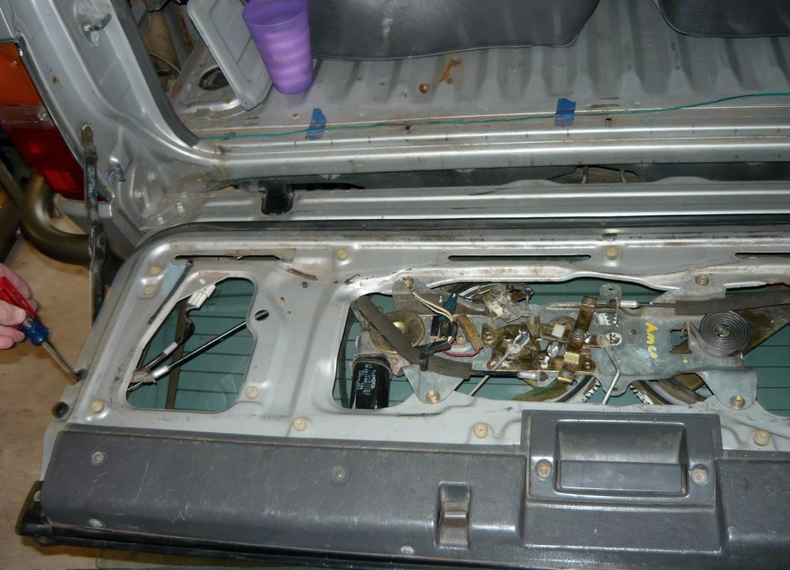

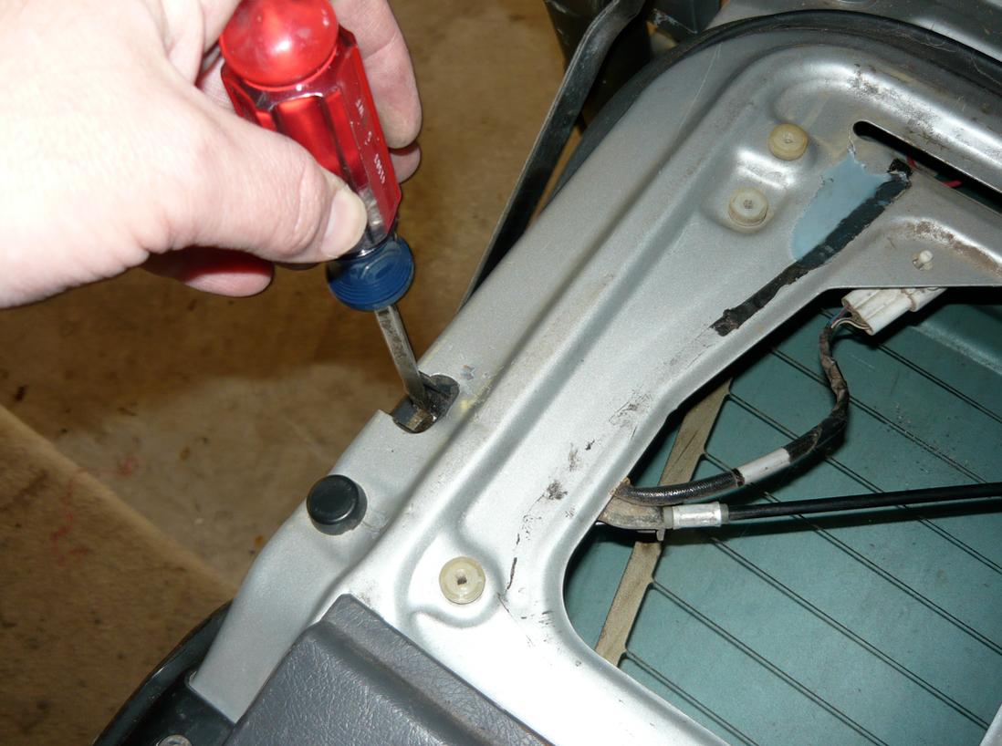

I would suggest not taking it out to start with. You can lower the tailgate and trip the switch to think it is closed (see screwdriver). This will allow you to get to the guts with it all opened up and in a workable position. I stress though, have something in place to support the glass though or it will end up on the concrete.
Once you have it open loosen all the tracks a little and see if it frees it up and. The tracks may need to be adjusted/lubed a little to get it back to working more freely.
