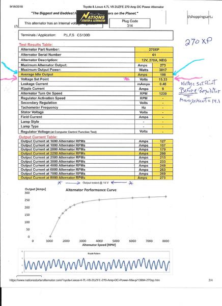

...This post is for [MENTION=119582]Jeffy[/MENTION] , [MENTION=58658]deekoi[/MENTION] , and all others who would like to see the DC POWER Engineering 270XP performance spec sheet for a reference. I've added pointing markers at the Idle RPM: Voltage and Amperage output Design specs: "see below"
rigtec-albums-%26quot%3Bmy+new+white+chick%26quot%3B%21-picture52644-270-xp-spec-sheet.jpg
The scribbled lettering on the right side of the cut sheet says: (15.33V refers to) Voltage set-point BEFORE regulator management = 14.1. If you have any questions about this device, just post it and one of the members that are using the 270XP (or myself) will be glad to help you! 'Best to you',
