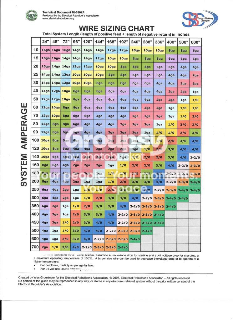

I happy to see so many team members doing a lot of their own wiring e.g., LED bars, remote starting mods, and audio amplifiers...etc. So I thought it would be quite appropriate to leave this 'wire gauge chart' here for your electrical systems working convenience:
I got this chart from ANOTHER very high quality alternator manufacturer who's customer base is 90% military grade first respondor vehicles. They're much like our DC power Engineering 270-XP but (believe it or not) just a little more expensive: No, you read that statement right, just a little MORE expensive! Check them out SBC High Output Alternators 'Best to you',
