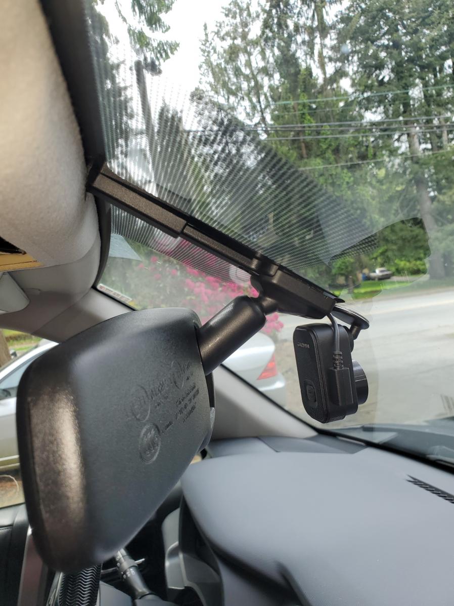

Here's my install with a Garmin Mini 2 and a Dongar adapter.
