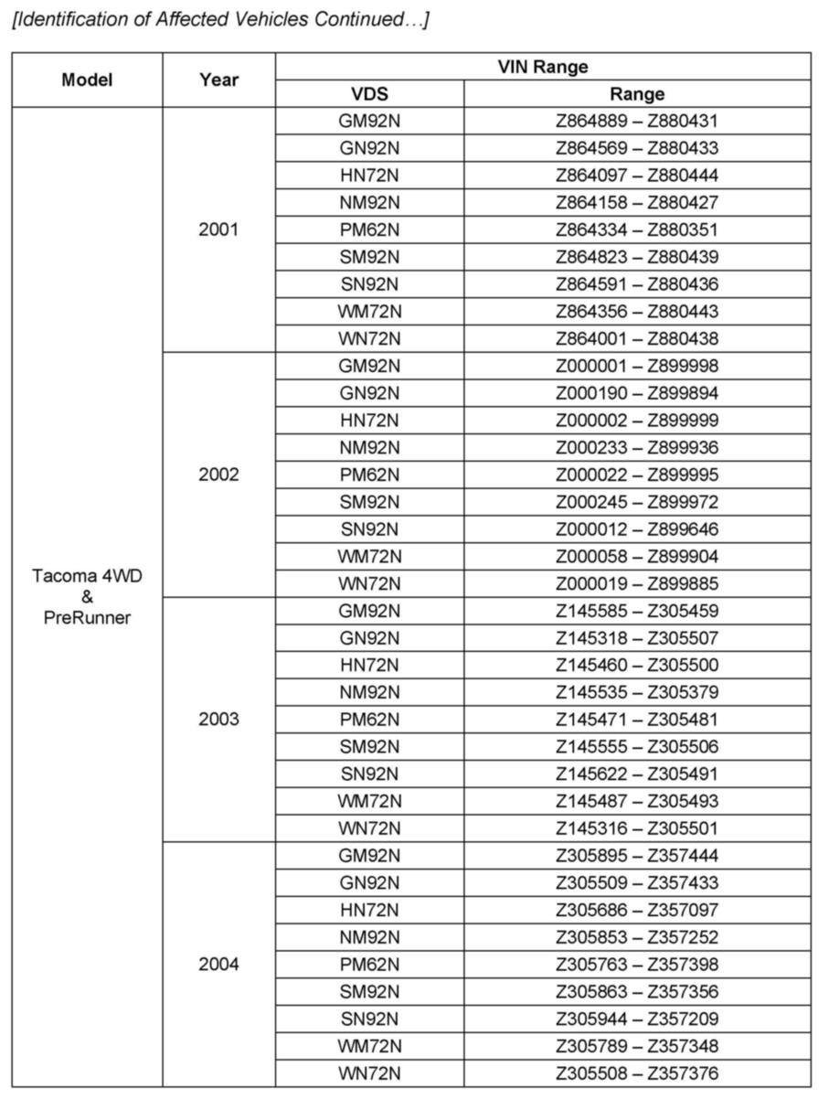

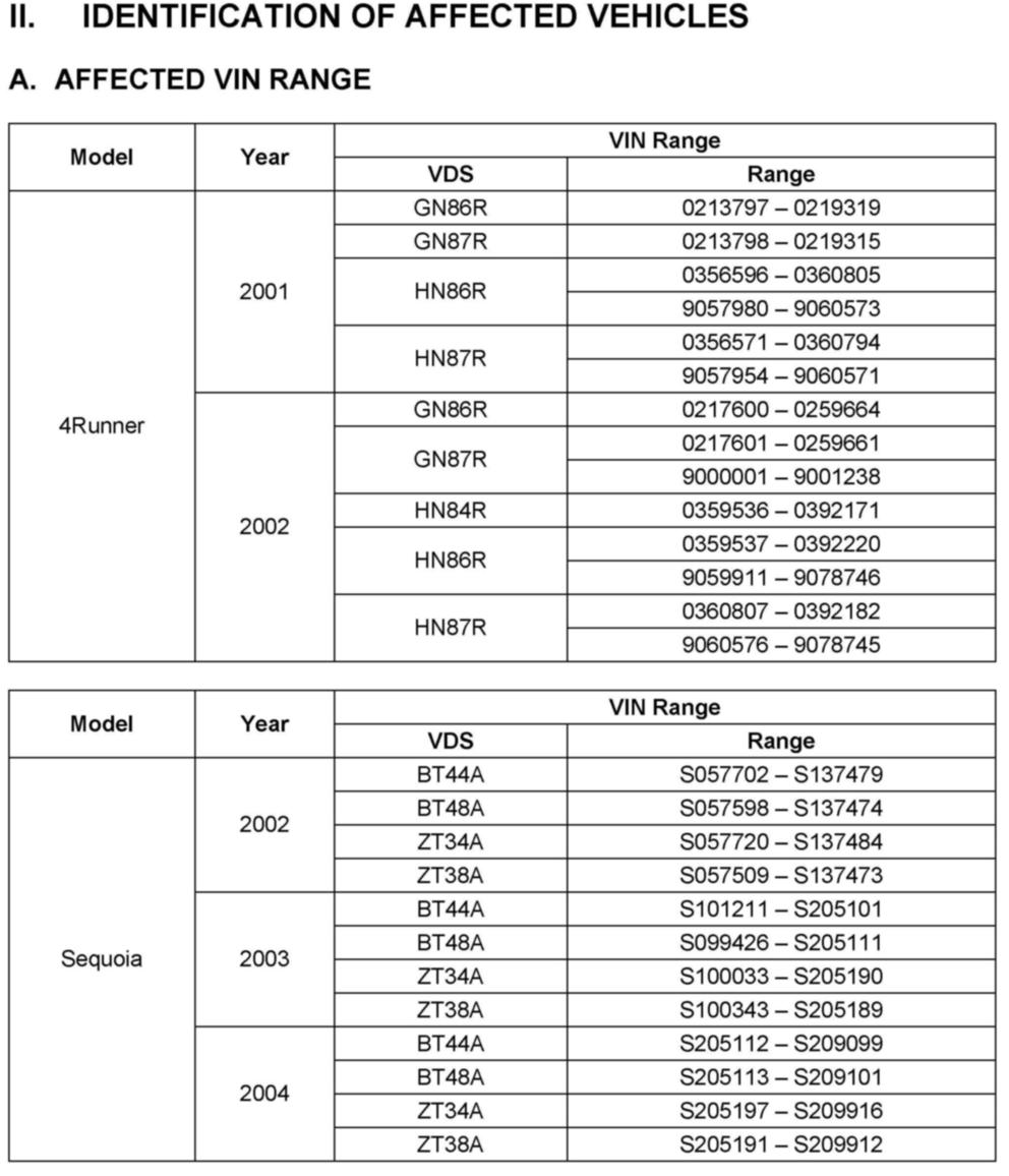

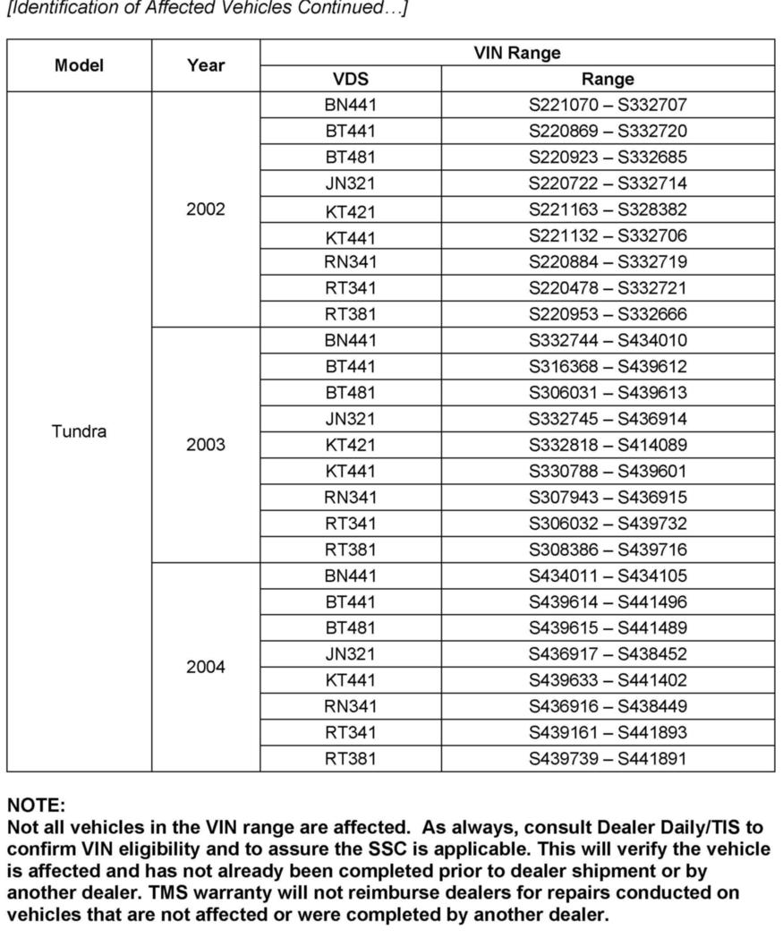

Any one know what VIN range the recall is on?
Here is a list of affected VIN's. Looks like it affects other models to.
VDS = digits 4,5,6,7,8 of VIN
Range = Last 7 digits of VIN.
Sorry about size of PICs!!
