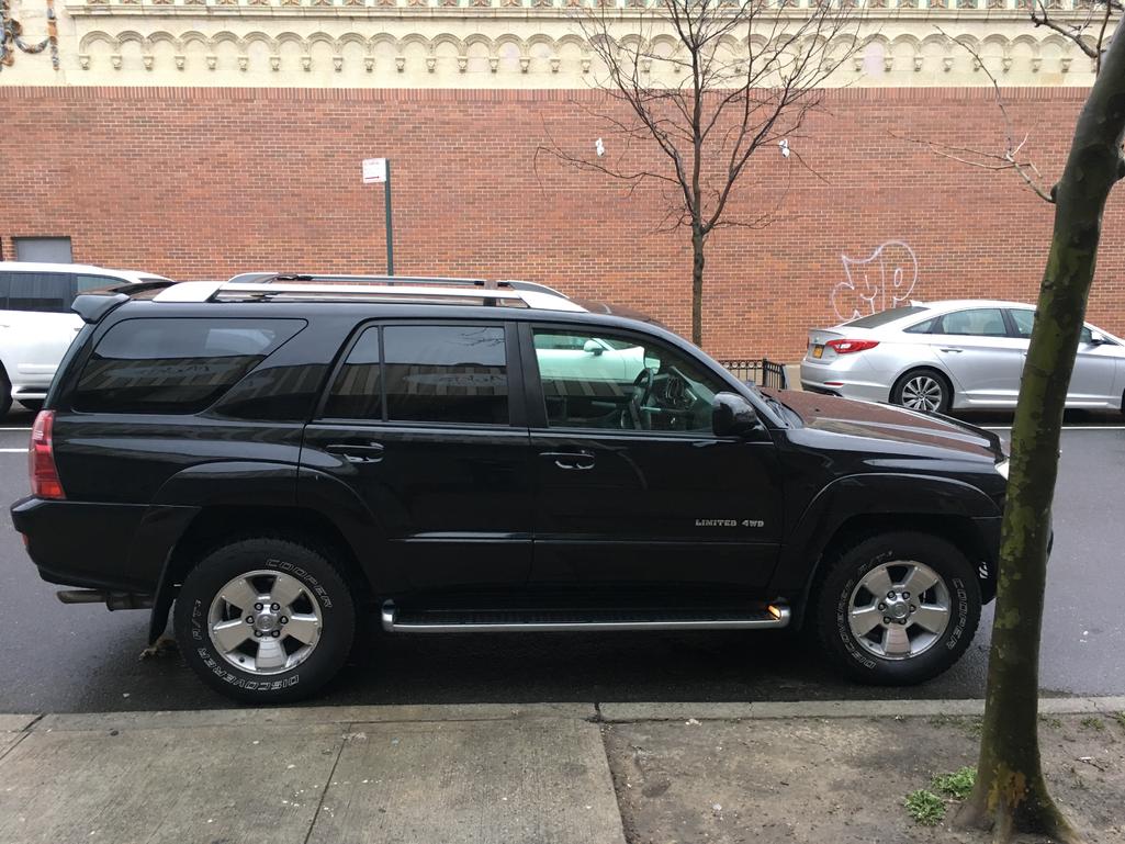

I'm taking a road trip from NYC to San Diego as I am moving there. I have a 3 week trip planned out. I will post the "google maps" link below so you guys can check it out. All thoughts as to the "feasibility" of the trip or if you think I'm being over-zealous are greatly appreciated.
I just bought my first 4runner with 147,000. It seems to be in great shape, some rust underneath, but from everything I've been researching on the web, especially this forum, the 4runner is the most reliable vehicle. I am building a bed platform for storage and putting a pillow top over it.
But any thoughts regarding this trip as far as my stops, safety, and other 4runner concerns are greatly appreciated!
