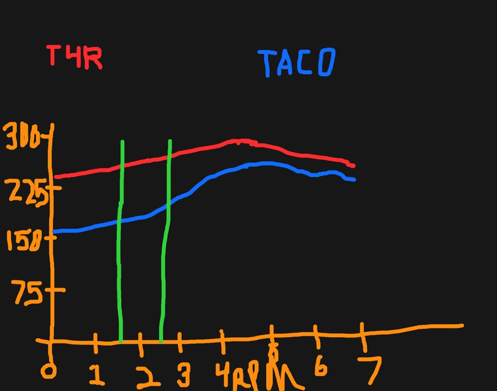

Question for those who know. 2019 Tacoma 3.5 produces 278hp @ 6000RPM and 265 lbs/ft of torque @ 4600RPM. For the 2019 4Runner 4.0 it's 270hp @ 5600 and 278 lbs/ft @ 4400. Those numbers are kind of similar (the 4Runner's peaks arrive a little earlier), and with the Taco being a few hundred pounds lighter, I would think it would be a wash. But most everyone says the Tacoma is slow. I've never driven a Tacoma - is the auto transmission that bad of a fit for the engine? Or maybe a combination of that plus having to wait a few hundred more RPMs for the peak power to arrive? Just curious. Thanks.
Thee attached post are not the actual dyno's: but a visual example of what many of the other poster's mentioned about torque across the entire curve. There are a number of other differences, but focusing just on bore and stroke, the tacoma 3.5L (94mm x 83mm) is a de-stroked 4runner 4.0L (94mm x 95mm). Same bore, shorter stroke.
In addition to the engine's power curve, Mass, aero, tire RR + Diameter, gearing, will all contribute to the total "Road Load" and resulting grade-ability of a vehicle.
Anyways... 4Runner all day unless you really need the open bed.
