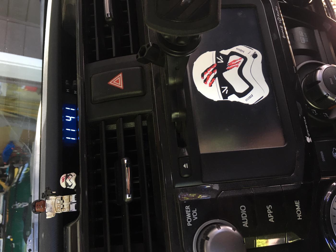

I finally got mine to work after many attempts. I kept thinking I had done something wrong with the file name or type, but it was actually just that the damn touchscreen button at the bottom of the head unit is barely functional. I sat there and punched it about 50 times before it finally did its thing and opened up the files on my USB. After that, piece of cake. Kind of a fun and totally pointless mod, but why the hell not?

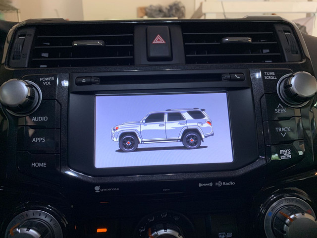

I updated my firmware on my 2016 today took about 5 mins easy peezy
I uploaded some startup images and that was super easy .. for the guys with issues make sure the folder names are spelled correctly and remember they are case sensitive

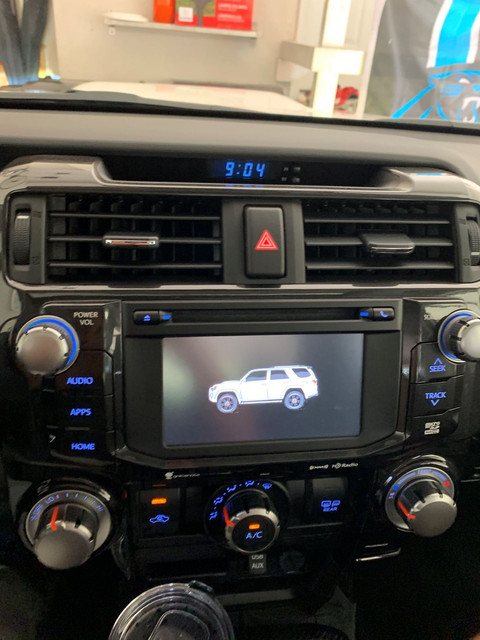

I am disappointed with the startup image though it only flashes up for maybe a second and is gone?
Oh well lol
