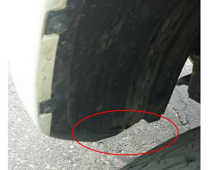

Where exactly did you trim? Got any photos? I just ordered the 3/4 spacers and spidertrax wheel spacers.
i trimmed the front of each front wheel well on the inside (closest to the engine). here's a pic of where i trimmed:
It is going to vary by wheel and tire combo, and even by individual vehicle. I waited until I had everything installed, then rotated my steering each direction and marked where the contact was. I then trimmed from there. I still get some slight rub on a mudflap during right turns when the suspension is flexed off road, but it is so rare and so slight I just don't worry about it.

Sounds like a plan. Thank you sir :cheers:

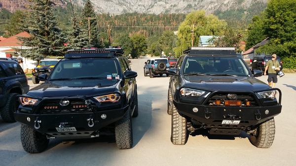

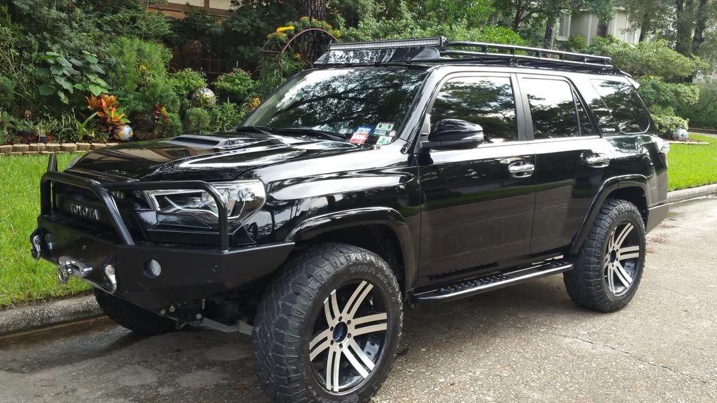

There are no issues with fitment. I have been running a Shrockworks bumper for almost two years now...... I have their rear bumper as well.
