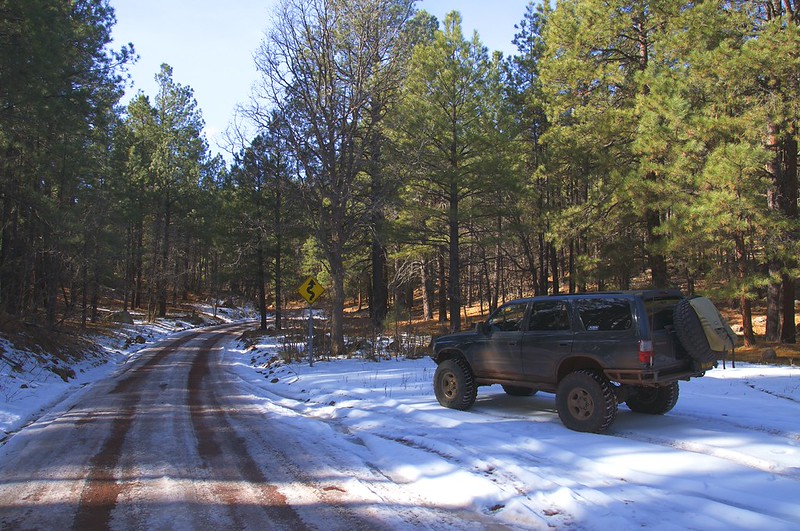

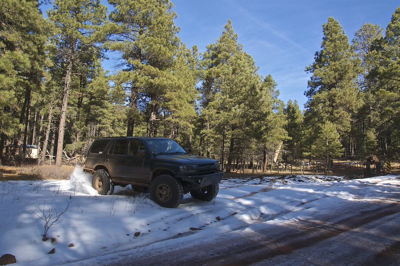

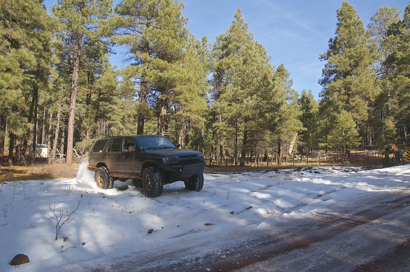

Ran Elvis again with the Tacoma's
DSC_0400 by Connor Rhoades, on Flickr
DSC_0402 by Connor Rhoades, on Flickr

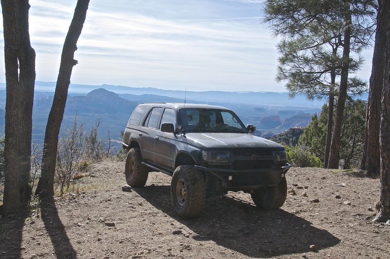

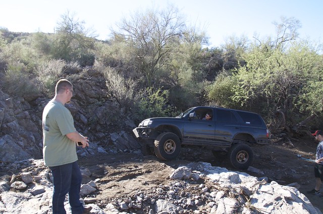

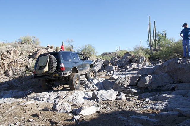

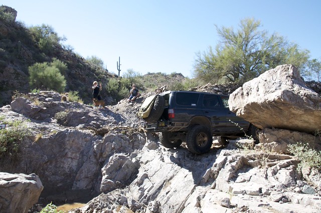

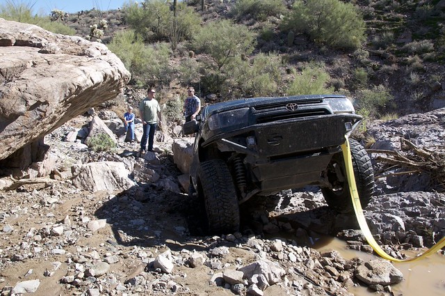

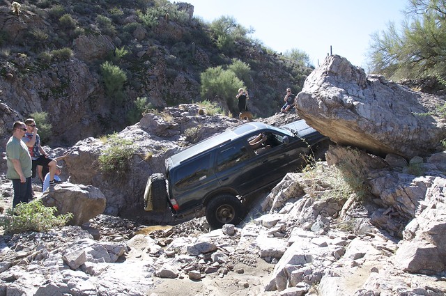

Tried going up the hard waterfall at the end, which I've done before. However, everything was wet and washed away from the recent rains. No one in our group or the Jeeps behind it made it up. I gave it a solid effort, but couldn't quite get there. Had to get yanked my a Tundra.
DSC_0452 by Connor Rhoades, on Flickr
DSC_0458 by Connor Rhoades, on Flickr
DSC_0459 by Connor Rhoades, on Flickr

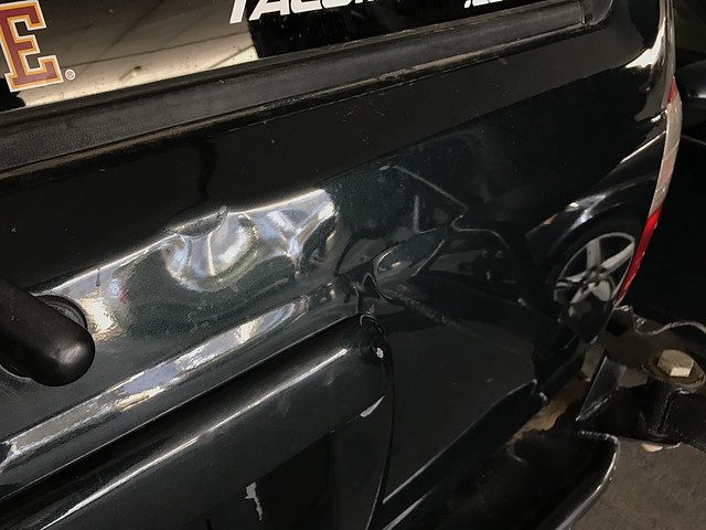

Got some body damage from the swing out hitting the hatch when I was trying to climb that waterfall.

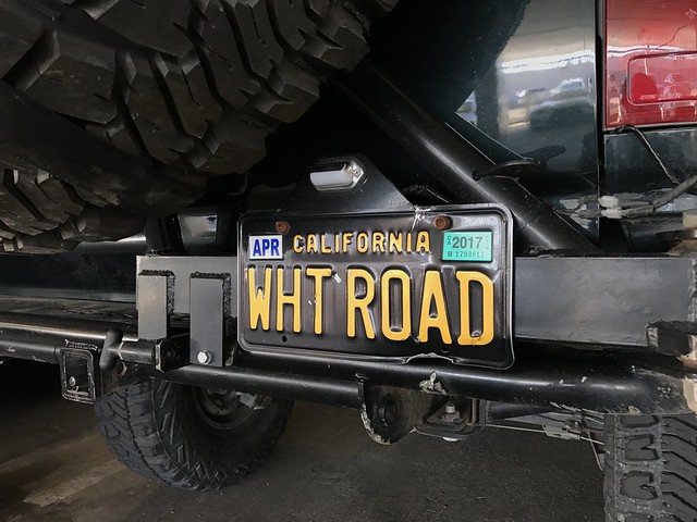

License plate looks fitting now
Untitled by Connor Rhoades, on Flickr

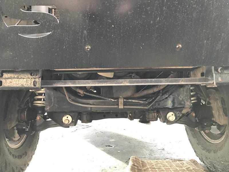

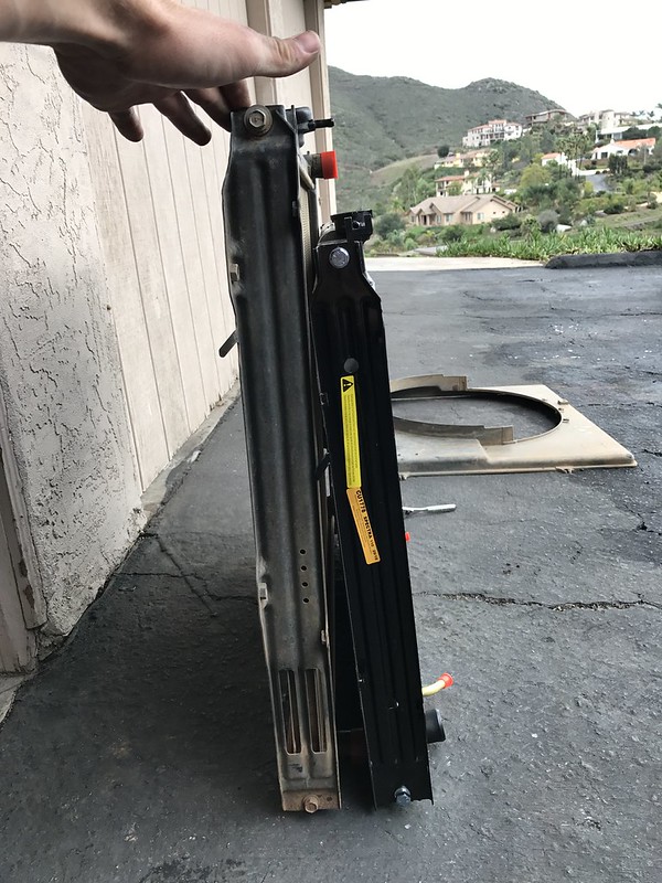

Here's a not very documented mod. Swapping in a radiator from a 1995 Toyota Tacoma, 2WD, 4 cylinder. It's 5 inches shorter than my stock radiator. Distance from the ground to the bottom of radiator was 21 inches, afterwards it was 26 inches. Everything bolts up. You'll need a lower radiator hose from the same vehicle. And you need to cut the lower and upper fan shroud slightly.
Radiator ends above my frame rails now. Which means my new front bumper can come back almost 4 inches from where the standard frame rail end cap is.
AutoZone radiator part number is B1778.

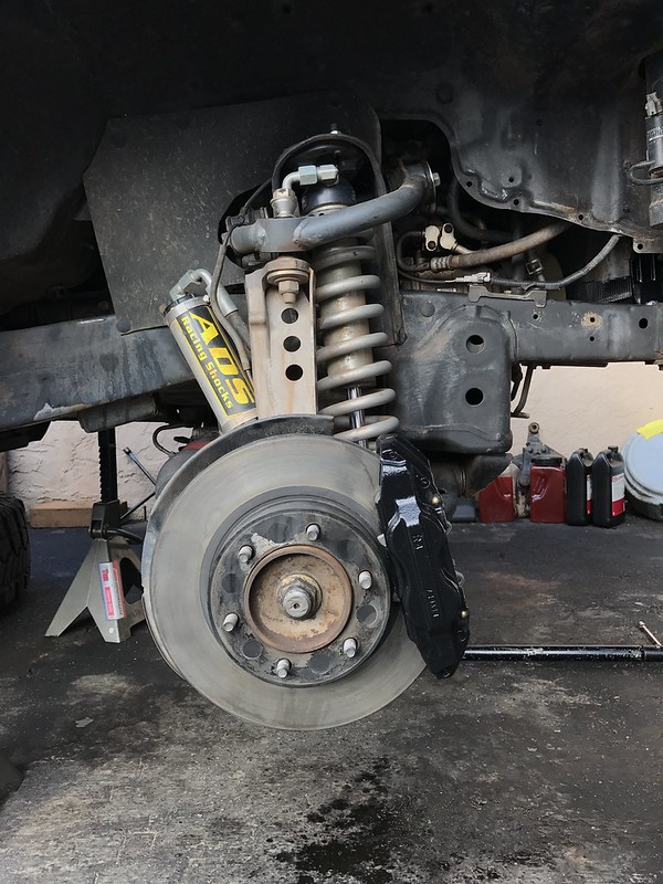

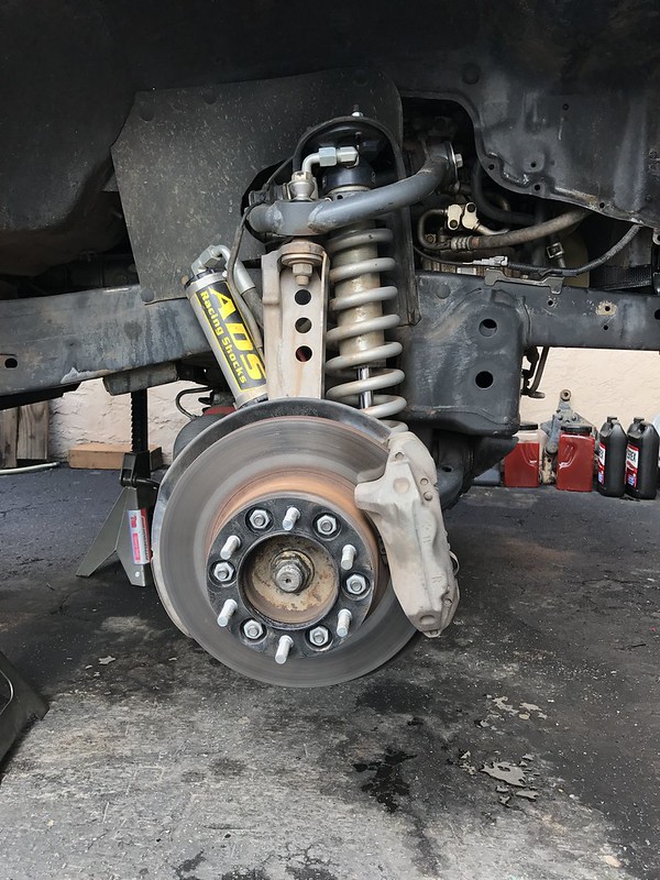

Then the Tundra Brake upgrade courtesy of [MENTION=100116]D Farms[/MENTION]

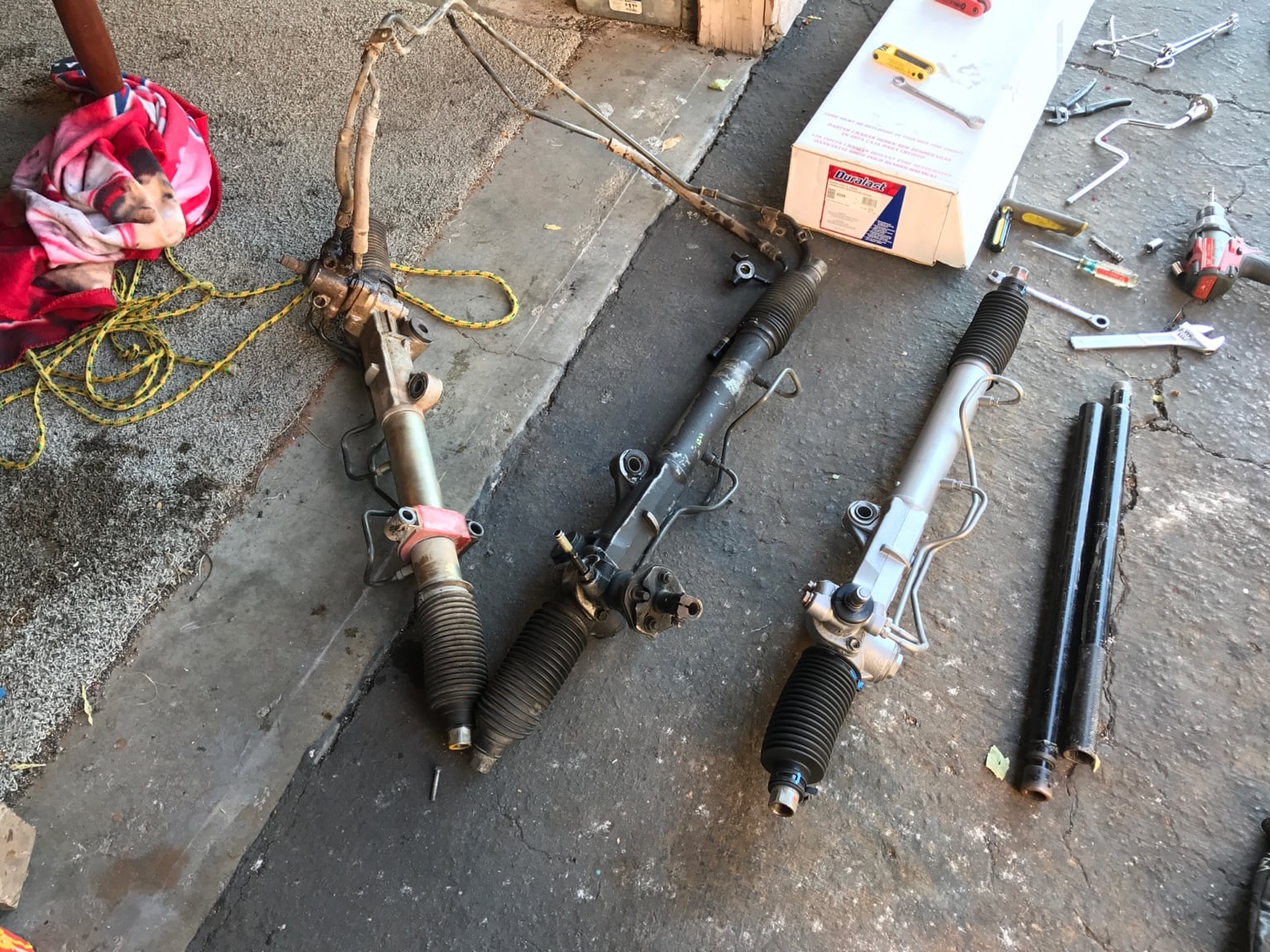

Installed new steering rack bushings fairly easily. Getting another alignment currently.

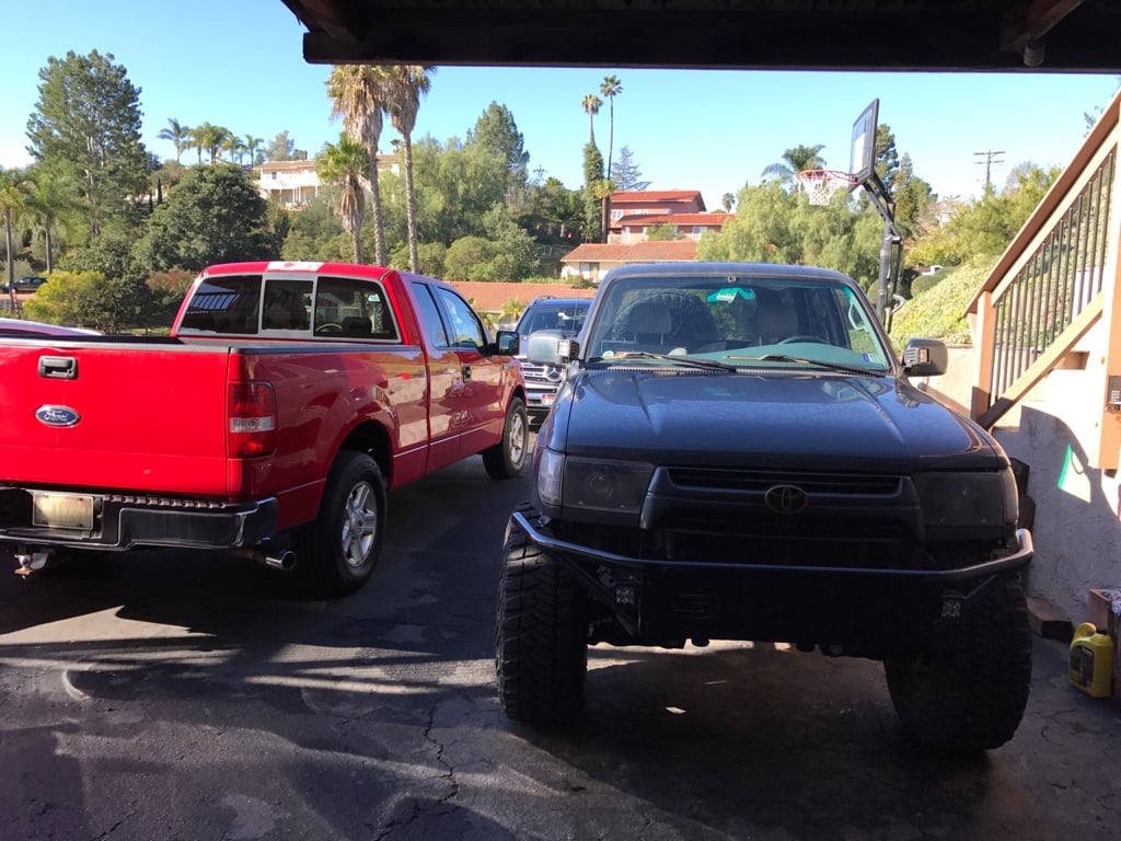

Also did the daily driver/tow pig mod.
2004 Ford F-150

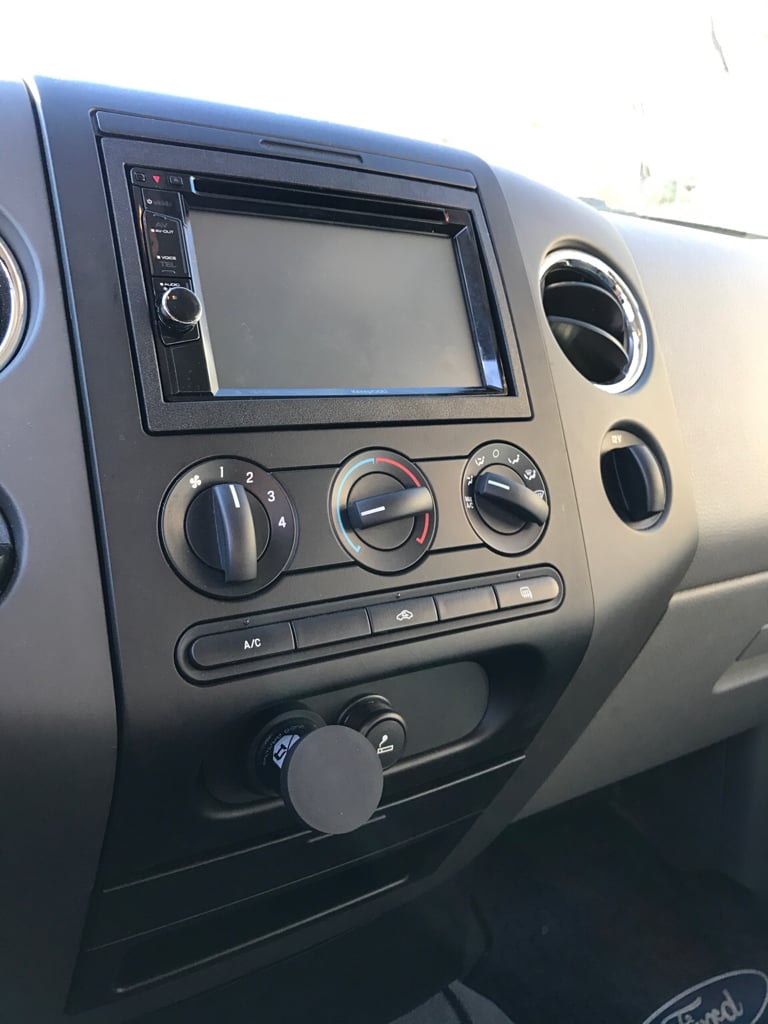

Installed a new CarPlay compatible radio and a Mob Armor mount
Ordered 5100's for the front to level it out. Gonna throw some 34's under it soon and call it good.
My step dad has the same year ext cab F-150 in silver. The interior's actually pretty nice and comfortable.
