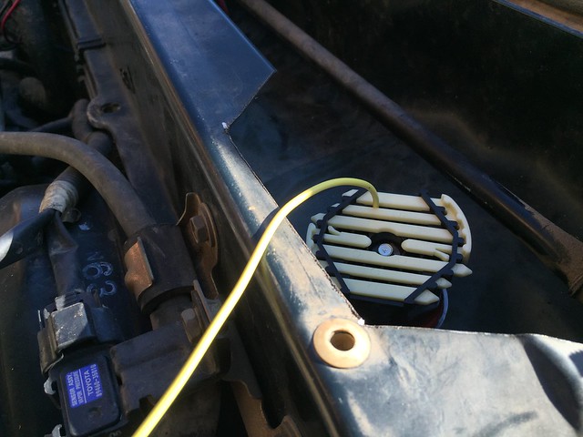

What did you do to waterproof the pins with no wire in them? (basically open for water to drain through)
I am trying to find an elegant solution for this, all I have is a bit of plastic zip tied above it on the cowl piece to stop direct water flowing to it.
Used the same electrical tape that I used to wrap the harness. Thick 3M electrical tape. Not a single issue so far and believe it or not Phoenix gets poured on often hahaha

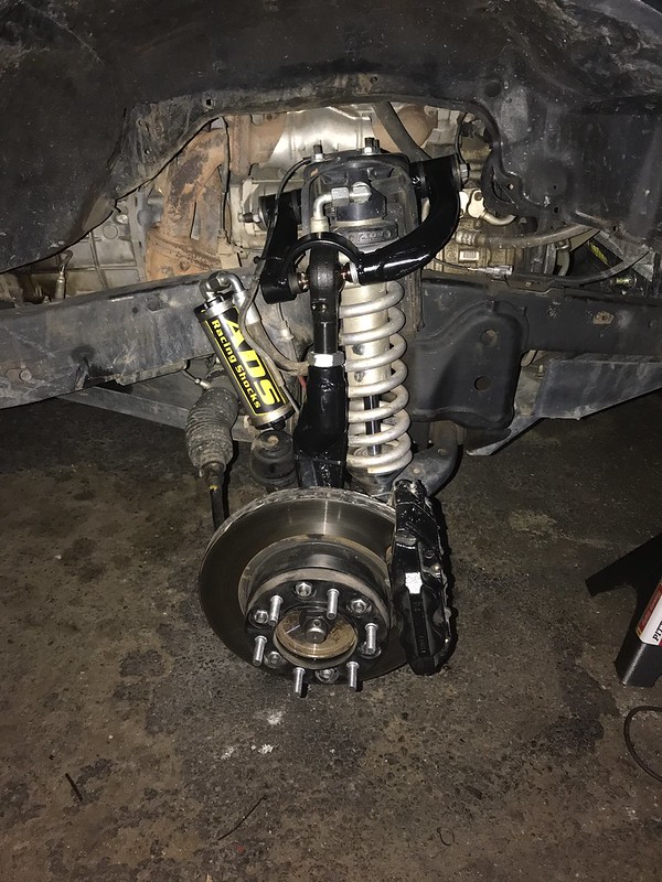

Ok. I'm interested. That's a unique setup. Just uppers? Does D-Farms have more info on these?

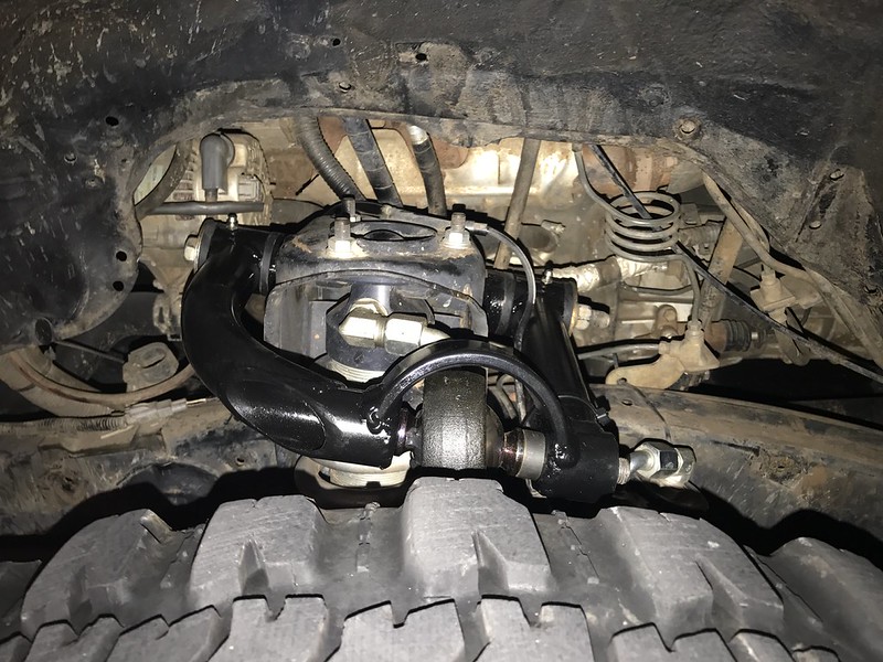

Its uppers and spindles. I would need a good chunk of change and spindles to make another set of these. They use Ballistic rod ends which are fully rebuildable and allow you to preload and adjust for wear. And yes they are fully tested.
The D_Farms aka Chooch Inc. arms and spindles got installed with a fresh set of Ballistic Joints. Ordering a set of 500 pound coils for it so that it actually flexes.
Untitled by Connor Rhoades, on Flickr
So what's the story on this setup? Sounds like it's built around the stock spindle, with UCAs from scratch.
I hear you on the "actually flexing" part. I love my 700lb coils for their weight carrying capacity, but it's next to impossible to stuff a front tire these days.
Yepp, just a stock spindle with the top cut off and a bung welded on.
My 650 coils were great on the street, but it took a lot to flex them out
I would think that a 600 lb coil would be the sweet spot between streetable and flex. 500 lb coils are generally used on regular cab Tacos and Rangers from what I've seen as far as aftermarket coilovers are concerned. I know stock stuff is closer to 500 but they don't take well to being preloaded either.
I'm trying to run no lift at all. Swapping springs is pretty easy, so if they're too soft I'll go to 550.

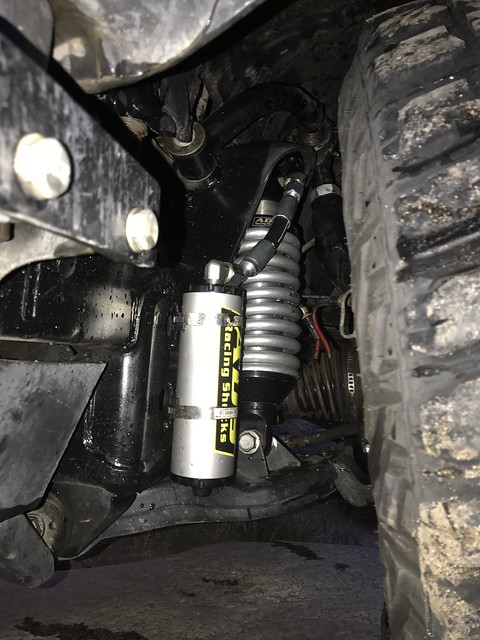

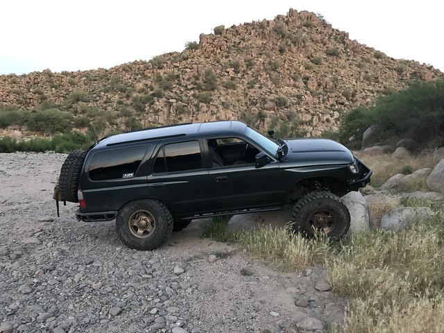

ADS coilovers are on. 3/4 of an inch more down travel than the off the shelf "Extended Travel" ones and 1/4 of an inch more up travel.
Sits with about an inch of rake after the coils have settled

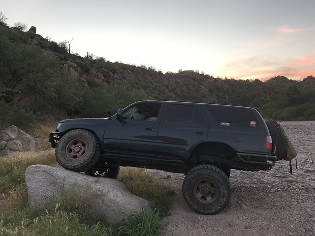

Flexes great
No coil bind. This is the driver side with exactly 1 " of thread showing.
It's super smooth around town. On washboard roads the front doesn't feel a thing, even at 35 psi. The back sucks ass in comparison. Those Icons need to go this summer for sure. Tires never leave the ground with this much travel. It's so nice never feeling the front end in the air.

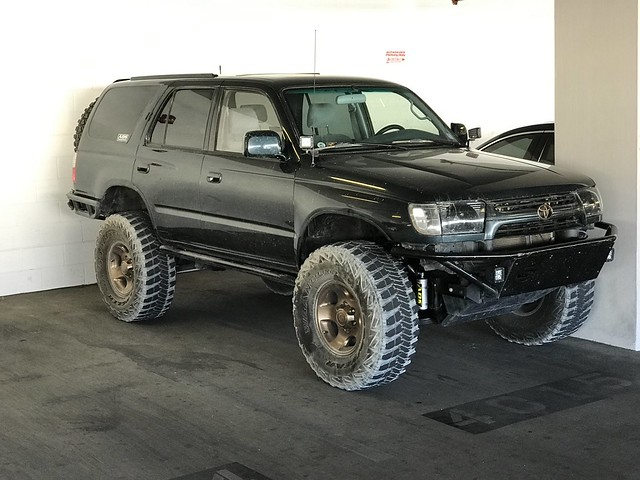

How is the F150 coming along? I guess it didn't make it back to ASU with you.
Thanks!
Had my dad drive it out in January with me actually. I've put about 4,000 miles on it since. It's super nice having a daily. The 4Runner gets to sit for 5 days of the week. Which is good because I'm really not looking forward to replacing the MTR's at the end of this coming summer haha. I've managed to not modify it except new door speakers.
