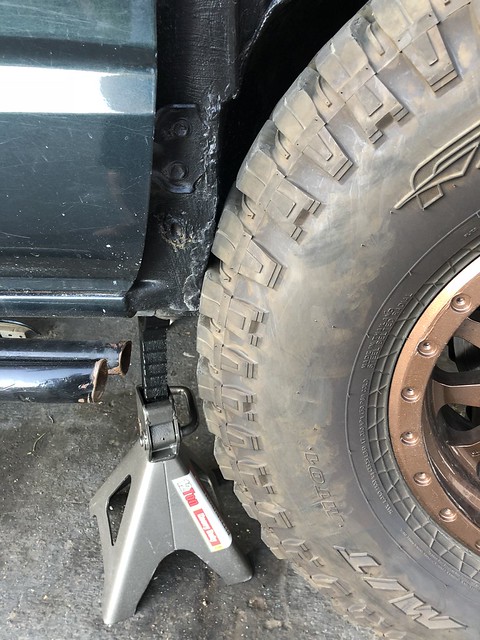

Well the reason I lugged the 4Runner all the way here was to cut for 37's. I knew it was going to be a lot of cutting, even though I've already cut for 35's a number of times. I'll let the pictures do most of the talking, but I started with the passenger side because I don't have to fight the clutch pedal, which I'm worried about.
So first I pulled the spring off my ADS coilovers, took the bumps tops off, and cycled the suspension all the way up to full bump to see what I'm dealing with.
In a straight line, nothing rubs. Not surprising.

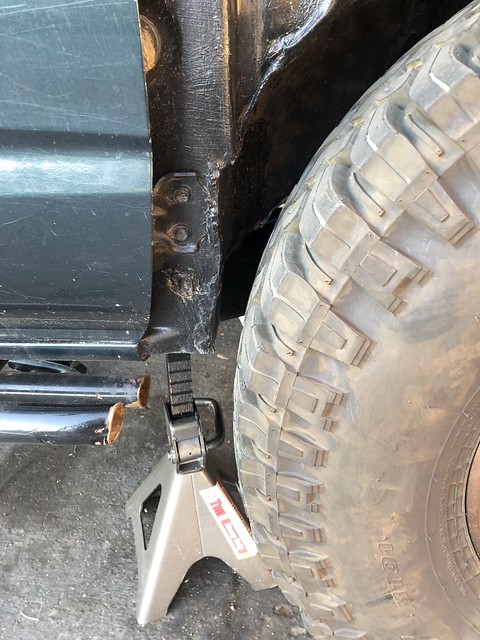

As soon as you turn though
Untitled by Connor Rhoades, on Flickr

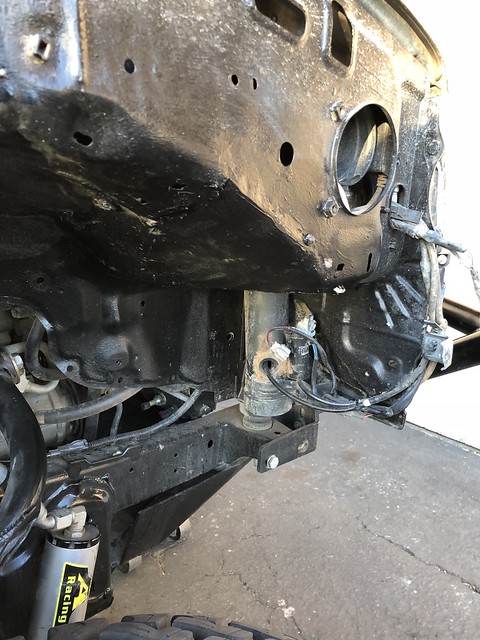

So time to start cutting. I bought myself a new Ryobi angle grinder and man it is fantastic.
Initial Cut
Bigger

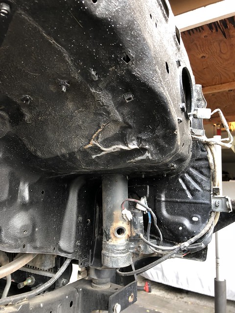

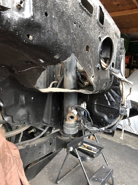

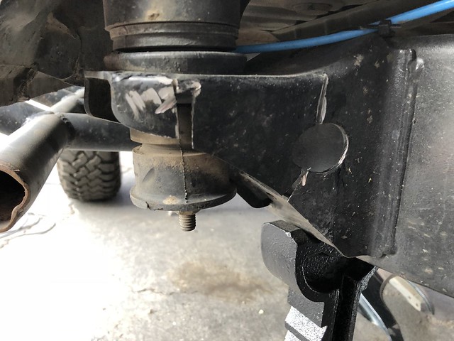

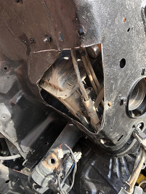

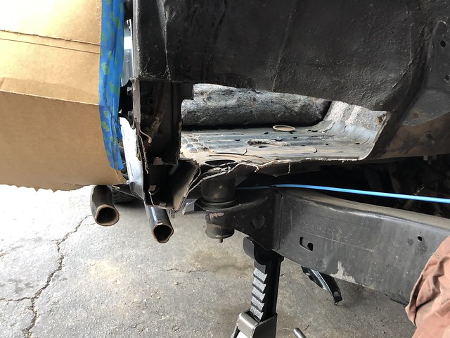

I also rub the body mount. So I cut 2 reliefs and bent it back with the intent to weld it back together and grind it smooth.
This give you a good idea of how far in I cut. FAR.

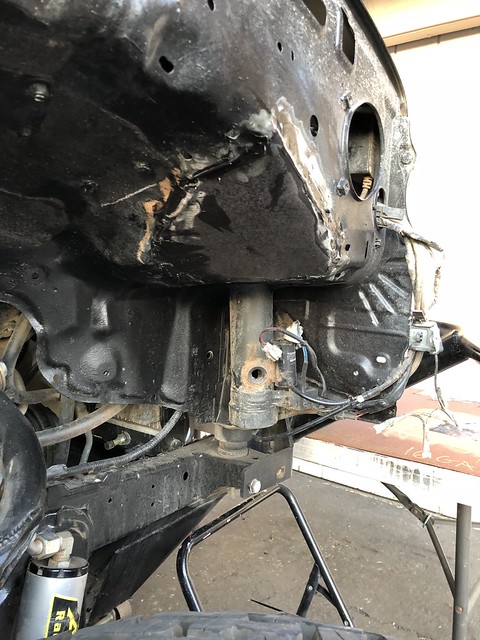

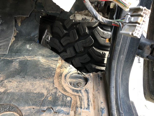

Next, I tackled the other area I rub, under the airbox.

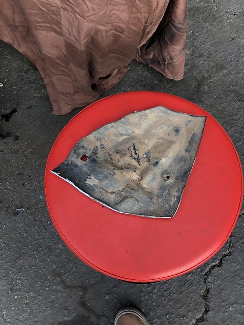

Well thats easy, cut it!
Airbox back in

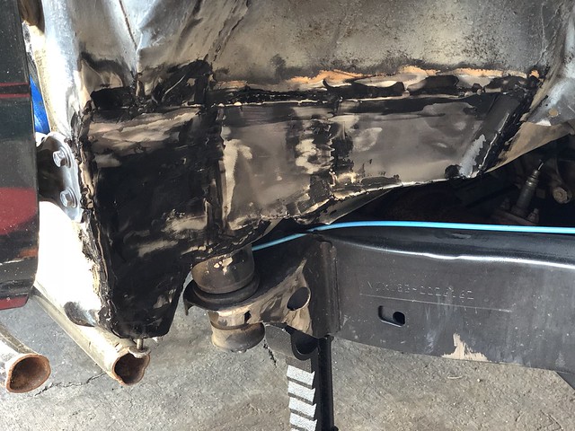

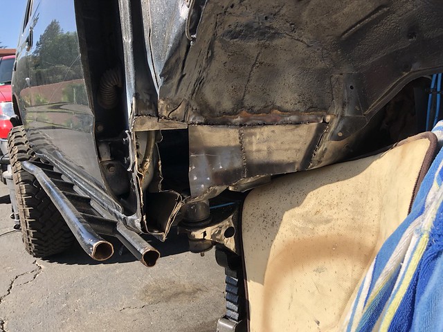

After cycling again, the tire rubs on the airbox itself hahahaha. So I used some washers to space the airbox up about 3/4".

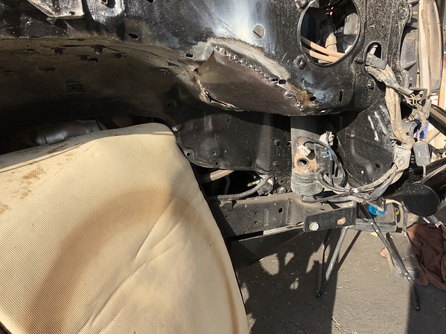

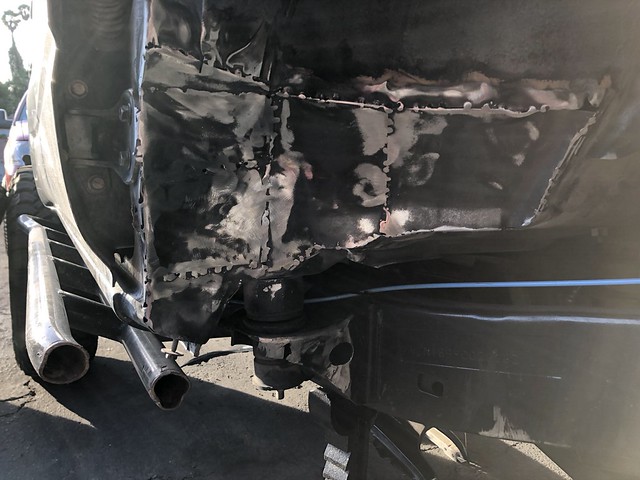

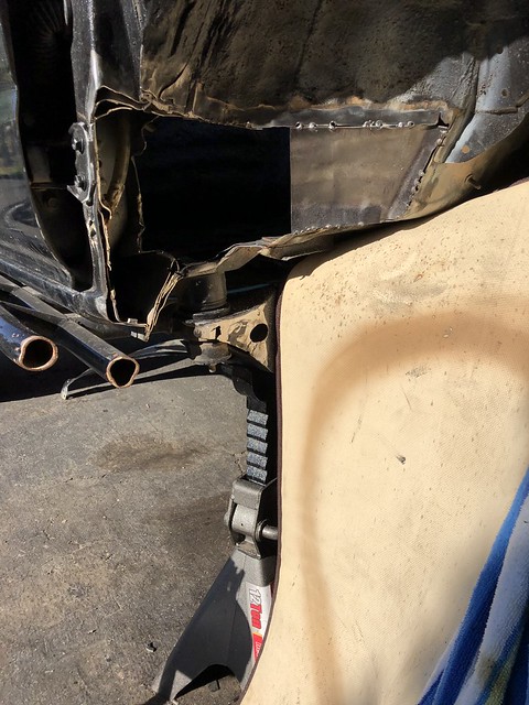

Then it was time to patch! 16 gauge cut and bent in place

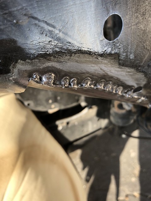

Tac welds for days. A new 220V welder will find its way into my possession in early 2018 because this is annoying.
These tags are really all you need though, around the entire plate.

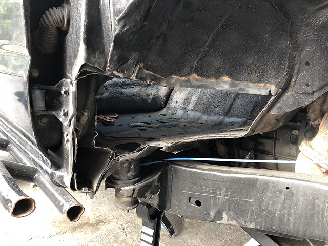

Then just add some sealant.

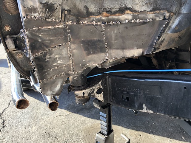

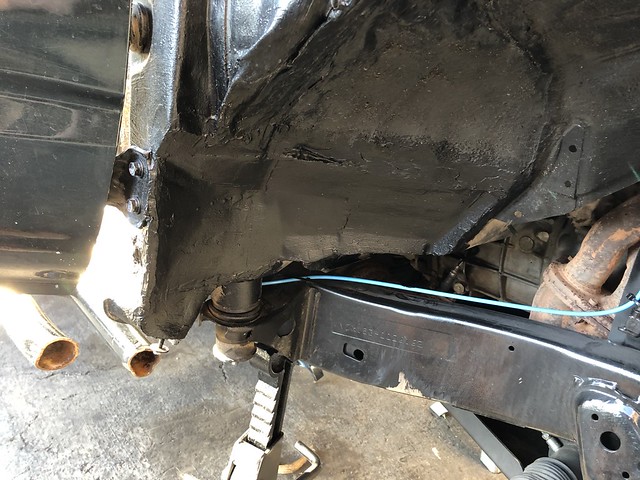

I'll bedline it after I patch the firewall tomorrow and it should be good as new!

No plans to notch the frame. These 37x12.5’s are actually narrower than my previous 315/75’s. So the frame rub really isn’t bad at all anymore. Very rarely am I at full lock. Plus, let’s get real, I’ll probably SAS in late 2018 haha. The steering rack wants to die and I’m sick of replacing it.
Everytime I check this thread you're always doing crazy things and I love it.
That chop is probably the biggest I've seen, but it looks clean!
Thank you sir! I just like to have fun hahaha. Reallllyyy not looking forward to cutting the drivers side, but definitely looking forward to wheeling now that they won't rub all the time.
