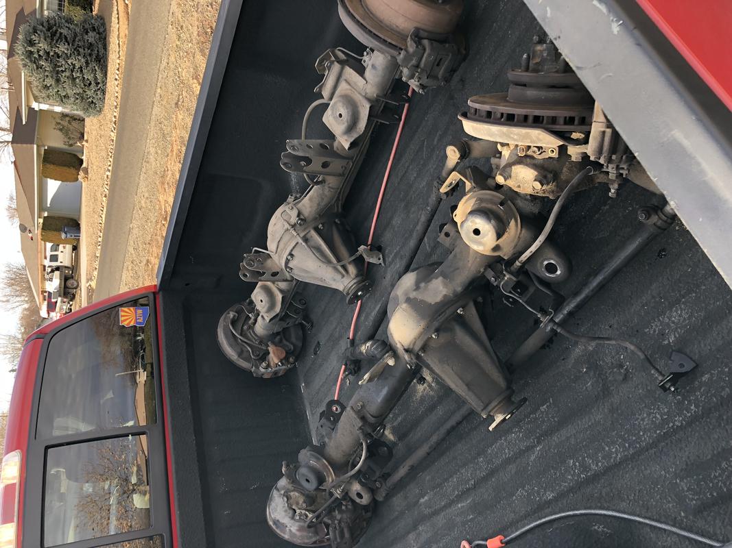

Solid Axle Swap coming late 2018 or 2019 or some time eventually EBE683F2-3630-49B5-AC72-081B6E051B3E.jpg

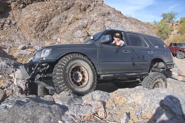

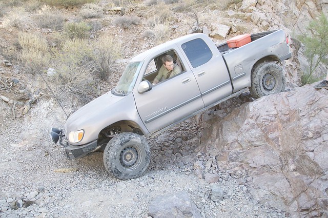

I went up the V-Notch to the left of the Tacoma and was trying to turn left. Passenger side was bound up, front diff was unlocked, and then POP. The funny part was this obstacle use to be harder. I was sitting there staring at it thinking of a way to make it hard and Brian(Tacoma driver) says "I don't think there's a way you can make this obstacle hard."
DSC_0244 by Connor Rhoades, on Flickr

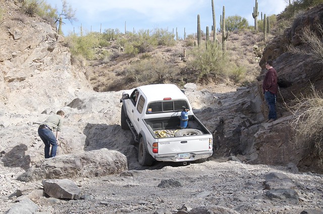

Here are some more obstacles from the day

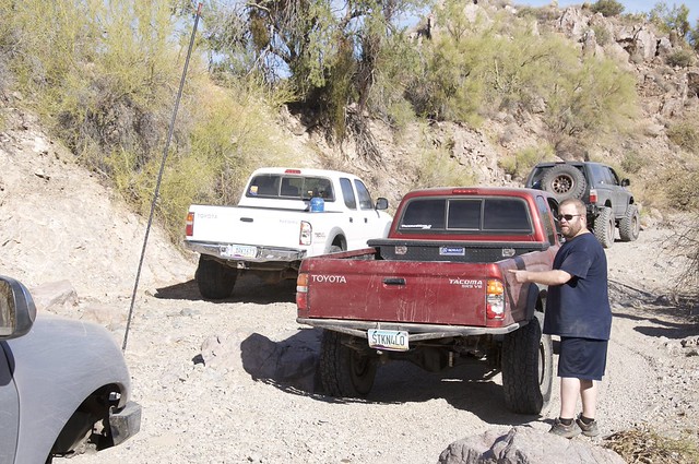

Yours truly being pulled off before realizing I would have 3WD if I locked the front diff
DSC_0248 by Connor Rhoades, on Flickr

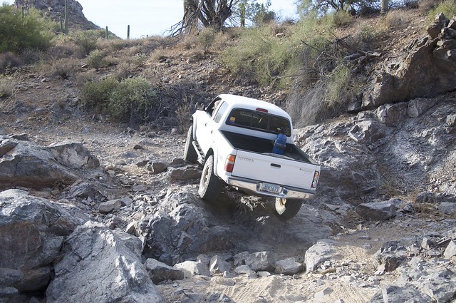

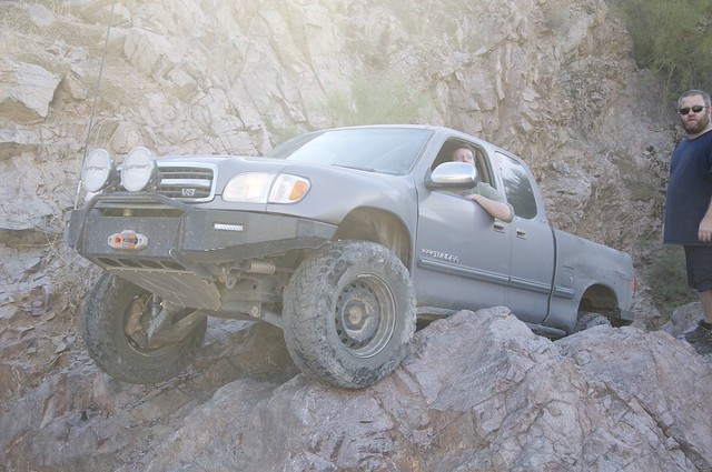

This is called Up and Over, a fairly famous buggy only line. Our crew made quick work of it
DSC_0269 by Connor Rhoades, on Flickr

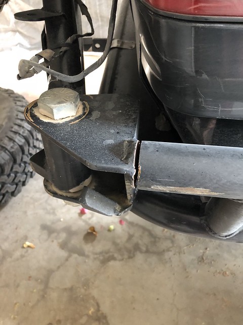

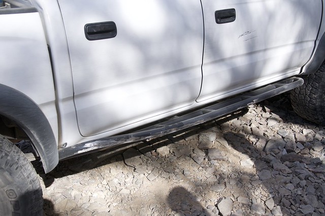

So basically he ended up getting kicked farther right, and then high centered. So we had to yank him off sideways, and he came down on his slider. Which then bent.
DSC_0290 by Connor Rhoades, on Flickr

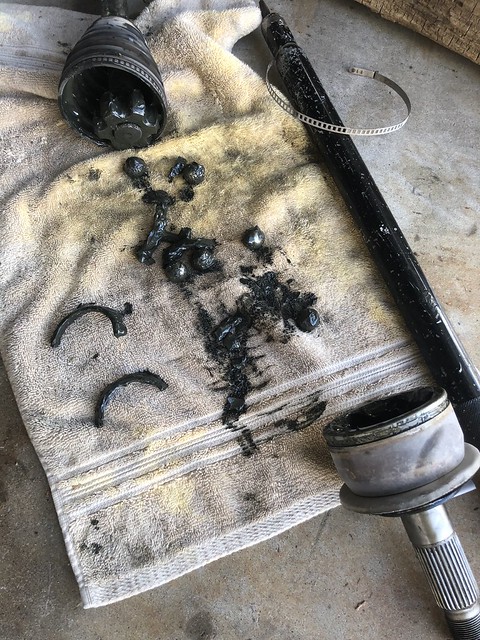

[MENTION=67615]Dirtco[/MENTION] I’m 90% sure I sheared that ADD tube extension thing that you did.
I've broken a couple of them, and with the Lotus axles that became a weak point. I also thought about cryo treating the stub shaft, I think it would be worth a shot if the price is right.
Ya I was stoked I didn't break an OEM CV. I'm gonna try and pull the diff today and make sure that's what I actually broke. But I'll probably have the new one treated, I found a place near me that seems reasonable. Less than $100.
