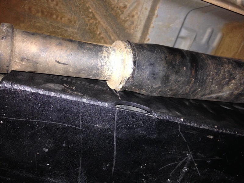

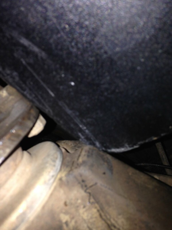

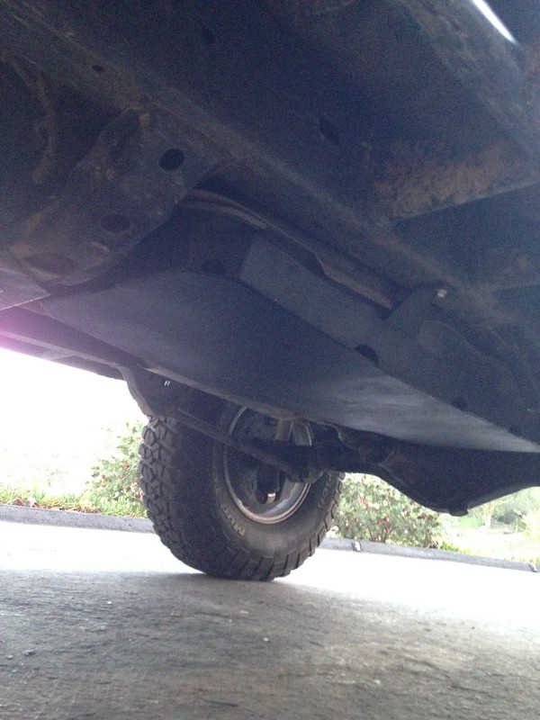

Any7 OffRoad Gas tank skid installed today. It wasn't an easy install. It took about 3 hours to get it bolted up all the way. Modifications had to be made. Some holes drilled out more, etc. Thanks [MENTION=91297]Kraze[/MENTION].

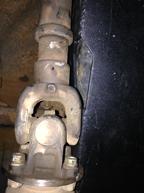

And if rubs on the diff and on the driveshaft. So I'll have to wait until next week and plasma torch some of it out.
Now I gotta go deal with a fire...
IMG_3056 by 4Running Daily, on Flickr
Pictures: Bad ones though haha.
Rubbing
IMG_3049 by 4Running Daily, on Flickr

Hitting 3rd member
IMG_3051 by 4Running Daily, on Flickr

Did you have to open up one of the front mount holes? haha. I had to do some modifications on mine as well. Sucks that it rubs your driveshaft. I have no interference there, hits the front of the 3rd when I'm really flexing it out but thats it.
On of the front mount holes just needed to be filed out slightly. The big modification was to drill out the hole on the mount that bolts into the frame rail, it was off by 1/2". Mine only rubs when flexed. Those pictures are during flex. Not full flex though, probably only 80%. Luckily I still have access to a full metalshop.
I had to do the same. I bolted the frame mount first and that caused the outside front mount to be way off. I had to completely cut the hole all the way out and I now fun a bolt and huge fender washer instead. I also had to cut a slit and bend part of the skid that sits on the gas tank strap. It will take a hit though thats for sure, I landed on it more than once in Moab and I cant even tell
Ya, I didn't have to chop that much of the mount out. But I will have to do that to the strap.

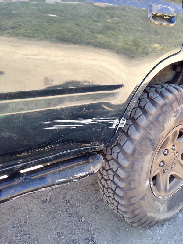

You could have the truck shop chop and re weld the sliders on so they stick out 2-3 more inches. That might protect you for next time. They recently did this for me.
Looks like you made out better than Kraze.
Ya, or I could just do it myself hahaha, but certainly a good idea!
