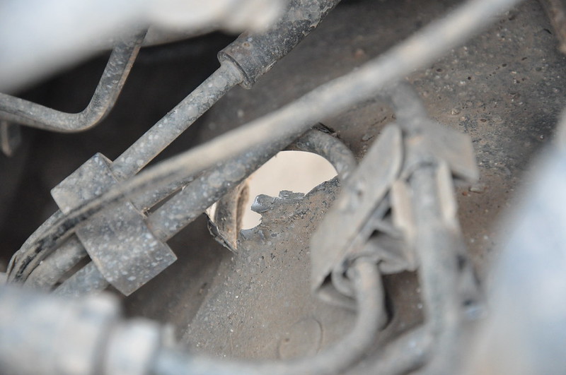

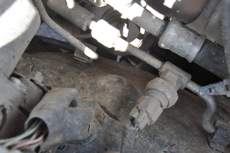

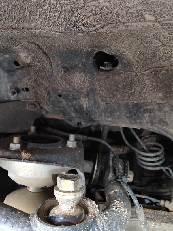

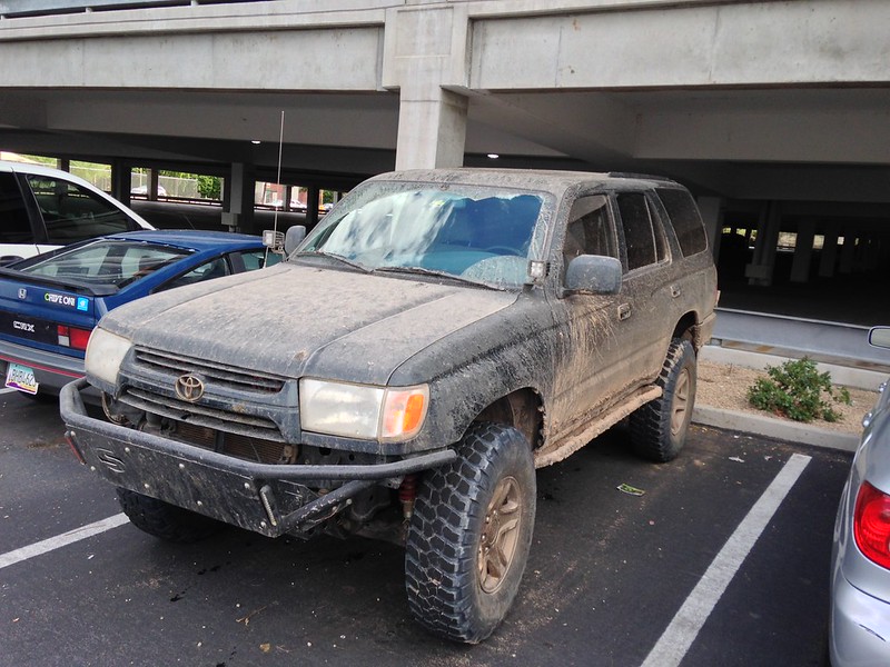

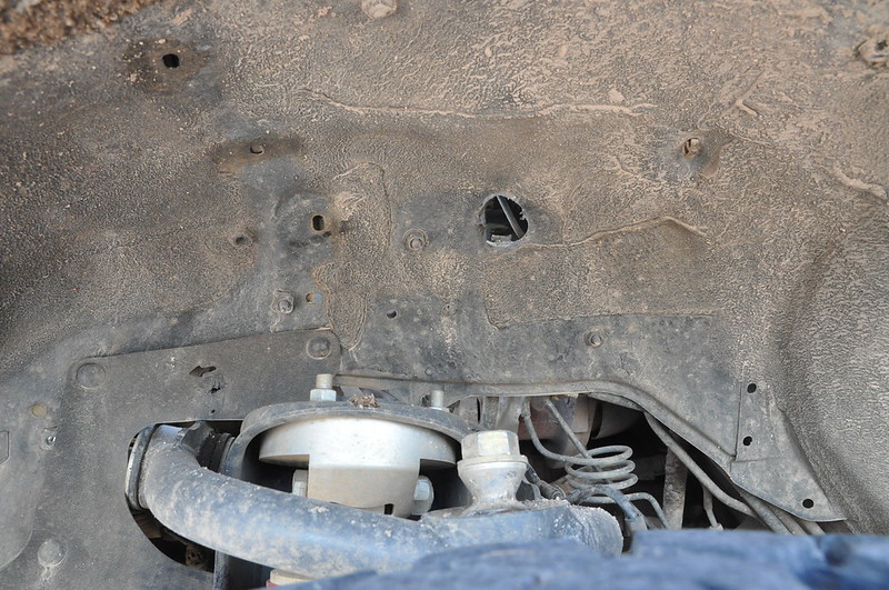

Today I bottomed out hard in a stream. It was bad. I have a video.
Damage:
-Ruined alignment
-Broken turn signal
-Grill flew off truck
-Driver side fender is buckled from tire contact
-I have a hole in my inner fender from the Uniball bolt
[MENTION=44448]ToyTec Lifts[/MENTION] I have too much travel I guess
So I need to buy bigger bumpstops and maybe fenders
Video is coming

You cant have too much travel, but you are definitely pushing the limits of the coils on those toytec coilovers. You are carrying a lot of extra weight with all the armor on your rig now.
I would look into some bumpstop upgrades along with maybe a heavier coil to support all the weight when it comes crashing down. I would also make sure that you aren't bottoming out your coilovers and using the internal piston as your bumpstop, no coilover lasts through too many hits like that if that is what is stopping travel.
