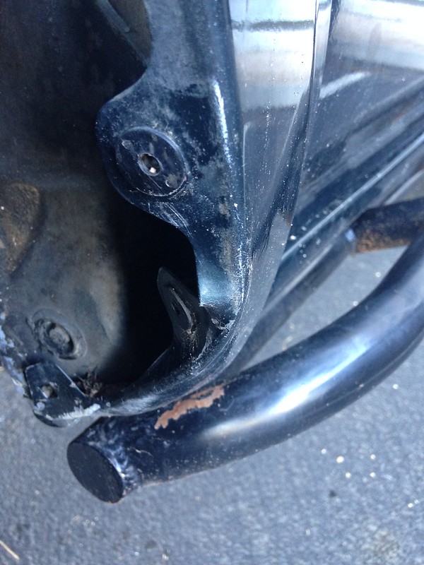

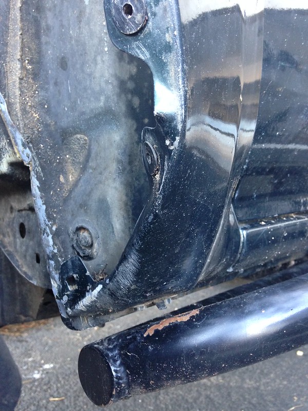

My drivers side didn't match up as well since the hood was partially crunched when I rolled but the passenger side was perfect.

With that said, I would still rather have the 4Runner fenders and correct lines that match stock but it fits good and looks awesome in my opinion.

Solid bump stop help tremdously. My tires would rub and beat up everything in my wheel well until I put my hydro bumpstops in. It is a good solid stoping point that you can test fit unlike any rubber stops. The only bad thing I found with rubber stops is that you truly can't fully cycle the suspension to make sure everything clears.
I would skip the fenders and buy the hydro bumpstop. The main thing the fenders do is give you coverage over the wheel. Where your fender bent is where I shattered my fiberglass fenders because I didn't have my bumpstops step up properly.

As soon as I saw the hole in my inner fender I thought of you. "This would make Jonathan proud" hahaha
I still need a welder for hydro bumps, and I don't have that resource yet.
