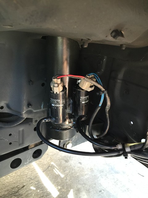

Here's the finished washer reservoir.
Start with a 2" ABS Pipe, cap one end, JB Weld a mount on it, drill 2 3/4" holes for the pumps (one pump for the front windshield, one for the back window), mount the pumps with some silicone, let dry, paint everything and mount it. Good to go. Holds a decent amount I would say, I really don't use it all that much as it is.

Looks good, I really need to make a new wiper reservoir somewhere far from the tires haha
Haha I'm just hoping that the new tires don't just rip this off the mount, but we'll see. I gained multiple inches, I'll just have to try it out.

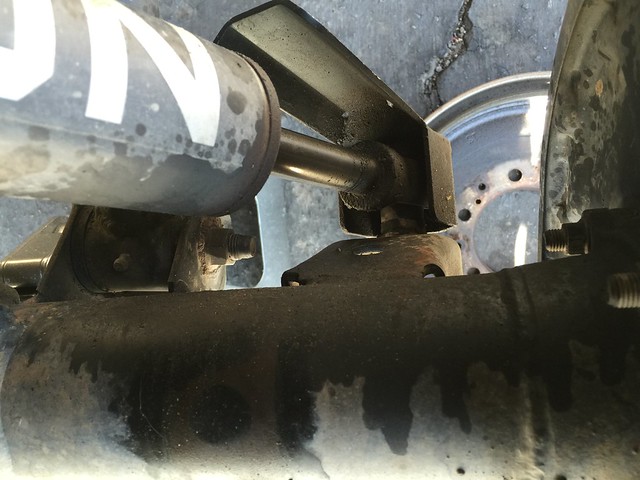

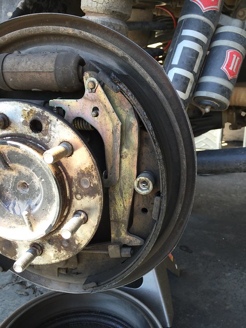

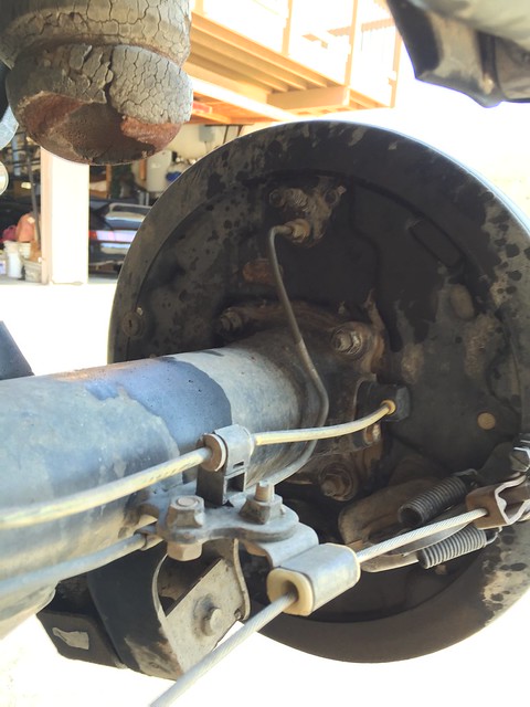

Alright I have a question for you guys. Do you think this is a leaky axle seal, or a leaky shock. I already know my Icon's leaky decently badly, but this seems excessive.

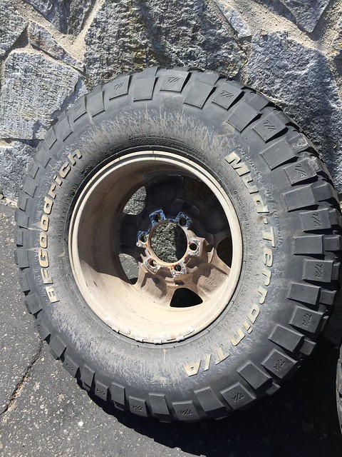

Notice the pattern on the tire.
I would say no on the axle seal. It's fine. The dust on the brakes look dry. It's not the axle seal. It's just your shock leaking.
Mine had the same problem. It was also down the gas skid plate. Turns out my front diff was leaking at the cv axle and spraying down the vehicle hitting the shock and axle making it look like my axle seal.

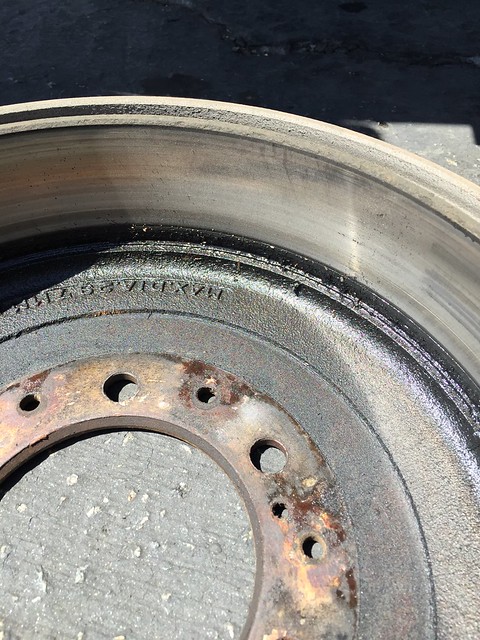

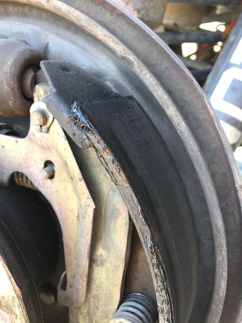

One of those brake shoes looks like it has some grease/oil on it.
Are the shoes wet, sludgy AT ALL?
They should be completely dry and brake powder should be at the bottom of the drum.
I just opened mine up yesterday to check (new annual ritual) since i am paranoid about the leaks coming back.
If you haven't extended the breather, do it. And at the same time buy a new breather.
Considering those shoes have some kind of gunk on them, I'd save up for a day to redo the drum brakes with OEM shoes. Must have been easy to pull off those drums.
Shock. If the rear inner seal goes, the shoes are usually covered. Plus it is concentrated in only one area.
There is some grease in the brake shoe, hence why I posted the photos. I cleaned it all out of there, but it is certainly weird. I have to wait for my first paycheck before I begin rebuilding the shocks sadly.
