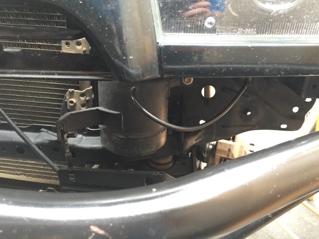

In other news, the Vacuum canister has been relocated!
I moved it behind the bumper under the headlight and grill, you really can't notice it.

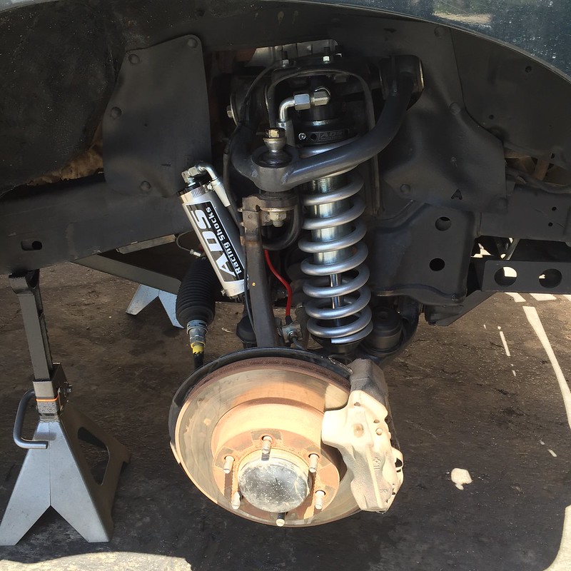

Today I replaced my front brake lines, bled the brakes, and the clutch. I must say the brakes are much firmer now. I can actually tell a difference. Worked on the washer reservoir more, letting it dry over night. Also painted my 5th FJ80 Wheel, so now I'm all set for the tires to arrive, hopefully this week.
Untitled by Connor Rhoades, on Flickr
Are those stock calipers? SS lines from Wheelers? Looks nice. I need some new front lines myself.
All finished with the freshman year?
Yes stock calipers sadly. I highly recommend those lines from Wheelers, they're really nice. Freshman year is over luckily, now I can relax for a little bit.
