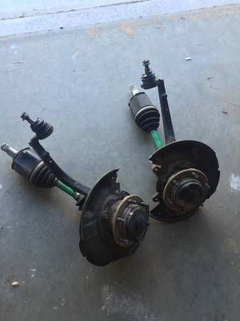

Bought a set of spindles and more CV's for a ridiculous price. Only have 100K miles on them. Also ordered spindle gussets for them. Plan is to replace the front wheel bearings and weld on spindle gussets. Make them nice and pretty.
Plans for the truck currently basically include lots of welding. I should be buying a welder within the next few months. I'll start playing around with Solidworks pretty soon too. I'm gonna start with small projects before moving to the bigger ones. First things first, new front bumper with a lot better approach angle. I'll stick to a hybrid design with a combo of tube and plate. After that I'll switch to stock length lower control arms for the front. If that goes well then I'll eventually make a long travel kit as well. I'm hoping [MENTION=92884]snivilous[/MENTION] makes a built spindle that I can steal ideas from. I'm kind of hoping to find some 2nd gen Tacoma spindles or FJ Cruiser spindles and build my lower control arm to work with their stronger design. No more lower ball joint issues with those 4 bullshit bolts. Theoretically it should work assuming you built a lower control arm to connect correctly to it. Then you could use 2nd gen Tacoma front brakes too. Lastly, when I'm really confident in my abilities, I plan on linking the rear. I'll be running a 3 Link setup with a pan hard. The goal is anything over 16 inches of vertical travel. I'll probably run 14" or 16" ADS coilovers and bypasses.
