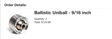

And in other 4Runner news, I ordered some Ballistic Uniballs to see just how hard it is to build lower control arms. Stock length to start.
