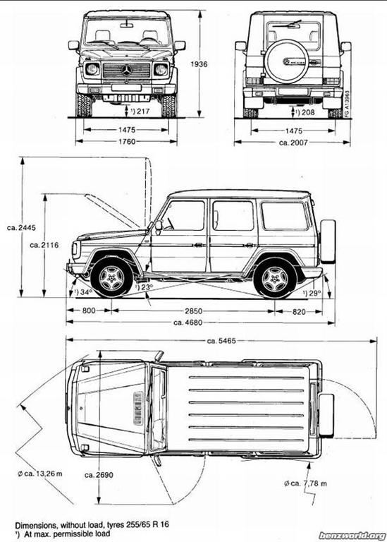

Good question. Supposedly, the G-wagen and Hummer vehicles measure their grade index with a full load. This is why a Hummer H1 can only do 60% and 40%, respectively. We all know that both of these vehicles can do more, but this is the safe gradeability with a full load. This is how the military measures grade capability. Both G-wagen and H1 must past military tests...thus, they are measured that way.
Therefore, the numbers between the different vehicles cannot be compared directly. Toyota has been known to fudge with data/specs to make themselve look good.
In fact, if you look at this spec sheet for the G-wagen, then you will see that at the bottom left corner..."at max permissible load". Everything is measured at max load. Thus, the numbers tend to be lower than that of Toyota's.
And since we're on the topic of Mercedes stats, i want to vent! I really do hate Mercedes USA...they treat the G-wagen like a bastard stepchild. The stats on the MBUSA website are wrong...and no one seem to care to change it.
Here is my post on another forum regarding the picture in my previous post above:
As you may know, i have always wondered where Mercedes get their stats on our 463 G-wagens. The MBUSA brochure lists ground clearance to be 8.3" and angles of 36/27 (approach/departure). Recently, i was looking at an old picture that we all have seen...see previous post.
Well, if you look at the left lower corner of the pic, then you will see that the specs for the pic is for a G with 255/65/16 (29") tires. If you convert mm to inches, then you will see that MBUSA measurements are very close (if not exactly the same) as these measurements.
So, current factory G-wagens come with 265/60/18 tires which is equal to 31" tires. So, if you were to add 1" to the height (due to larger stock tires) of the G in the picture above, then you will come up with a ground clearance that is much closer to what i actually measured on my G...9.3" inches (i measured 9.4").
In addition, stock G's approach/breakover/departure angles will be around 36/25/31. This is confirmed in my off-roading where i felt that my departure angle is significantly better than 27" degrees quoted in the brochure. And these angles are with a fully laden G.
So, basically, Mercedes messed up on the stats in the MBUSA brochure & website. MB does not really care about G500's off-road stats...it is clearly not MB's priority.
G-wagen is MB's bastard stepchild!
