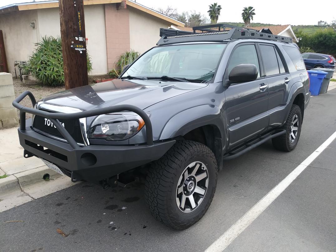

Demello bumper installed today
Well,I did it. I installed my Demello Stealth Series bumper on my rig. Lucky for me, the shop is about 1 hour drive so I picked it up (while maintaining social distancing)
I installed it by myself and it was time consuming but not too complicated. A lot of fit test and messing around but it is done. It is steel and I can feel the extra weight on the nose, but the real test will be on the trails.
I was looking at partial bumper AKA hybrid, but I wanted to get rid of all that plastic OEM stuff. Now, I need to add some lights to it.

No problems! This is why there are so many options available, to keep everybody happy. I pickup my bumper last week and installed my Demello today but still wonder if the Lil B's would have been a better choice... BTW, the Demello full bumper was about 110 lbs, I installed it by myself.
Show us your rig when you are done!

Just saw your picture, it looks mean! Did you upgrade your front springs to handle the additional weight?
Here's the hybrid I installed-
Once I put a winch in, it will look much more rugged and tough.
Looking good! I really dig your hybrid winch bumper, this is the best stealth looking rugged bumper on the market! Good job! I have the Toytec Bilstein 3" lift on the front and, so far, it did not seem to affect the height too much despite the extra weight. Real test will be on the trails.
Thanks for the feedback and let us know how the weight is distributed while riding on trails!
