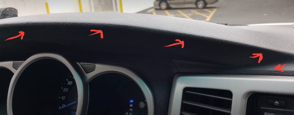

Just noticed some cracks above the glove box last week.

So I noticed a small crack in mine last week, now I have two very large cracks. Sounds like I'm SOL after reading this thread by a few months. That's sucks.

Just found/saw the same crack on mine today. Same story also...the warranty is no longer in force. Toyota wants $899 for the dash cover and $325 or so to do the replacement.
Has anyone found a source for the part for less? Has anyone done a DIY on this. Toyota service states only 2.2 hours to do the switch. I figure I can do it myself!

Dohhh! I did the same thing, Found the same crack same location. I feel like an idiot i checked ~6 months ago before warranty was up. expired 3 months ago. and I just found that crack isn't supposed to be there. so stupid...

Ya it sucks. I have found 2 cracks that weren't on mine when I got it back in July. I wish Toyota would extend the warranty.
