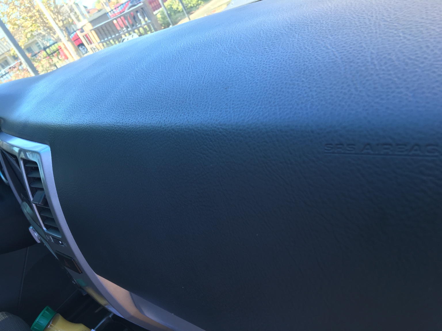

Got my dash installed yesterday.. is this supposed to be the correct color? Picked it up after dark, so didn't notice a difference until this morning on way to work. New dash looks grey, rest is black. Is this correct? If I hit it with some mothers leather treatment i assume it will darken?

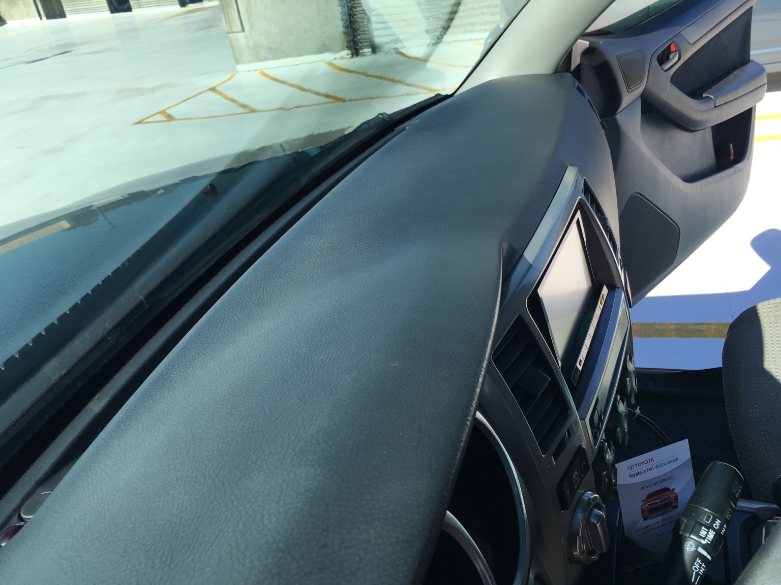

I just got mine back -- The new dash is a slightly different color, and it seems like the the fitment isn't quite right? Or maybe the dealer just rushed it? I see in [MENTION=131392]Nodnarbian[/MENTION]'s pictures that it looks similar.
Am I just being overly picky, or is the dash not fitting the same as pre-replacement? Look around the passenger hvac vent.

It seems like the 4Runner dashes are not "cleaned/waxed" from the factory, I've seen a lot (including my own) that came with a very hazy/poor looking colour. I wiped it down with the leather conditioner our detail department uses and it looks brand new now (still slightly different shade if you really look, but not as noticeable).
Fit around the vents looks acceptable to be honest with you, some of the trim panels may fit slightly different than they did before; I struggled with this a lot when doing the Camry's but I guess I am just as picky as you because I haven't had a customer complain about my work yet. Typically if the dash was "rushed" (I'll be honest I am getting the Camry's down to an hour in and out and that's just being leisurely, so "rushed" is subjective there) you'll see the dash pad not being seated properly which means the curve around the A-Pillar Trim will usually have a .5~1" gap between it and the dash pad because it's not resting on the pinch weld at the firewall properly.
I'd wipe it down with a conditioner (I've heard Armor-All is not a good product from a lot of detailers so I wouldn't recommend that one) and see how it looks afterwards.
