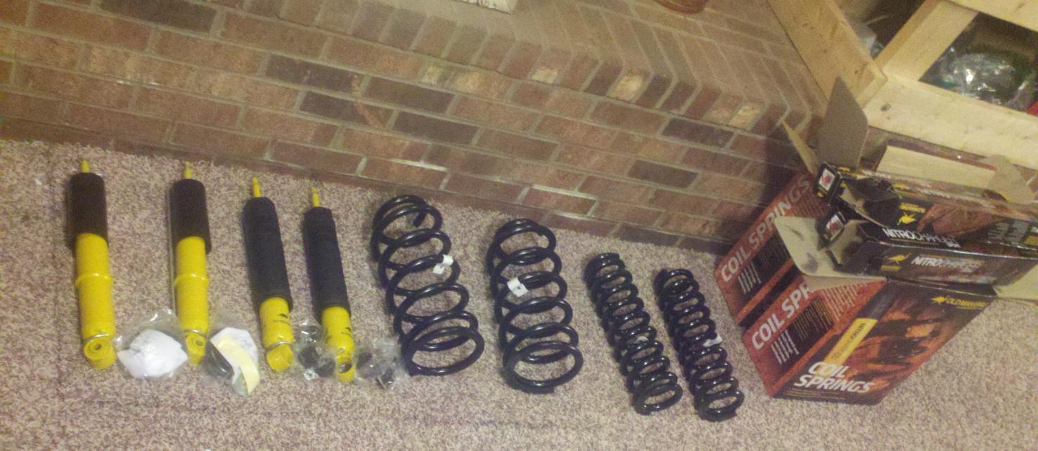

getting ready to have the heavy's installed. Good info to know. But am planning on the shrockworks front bumper. So I think the heavy's are needed.
