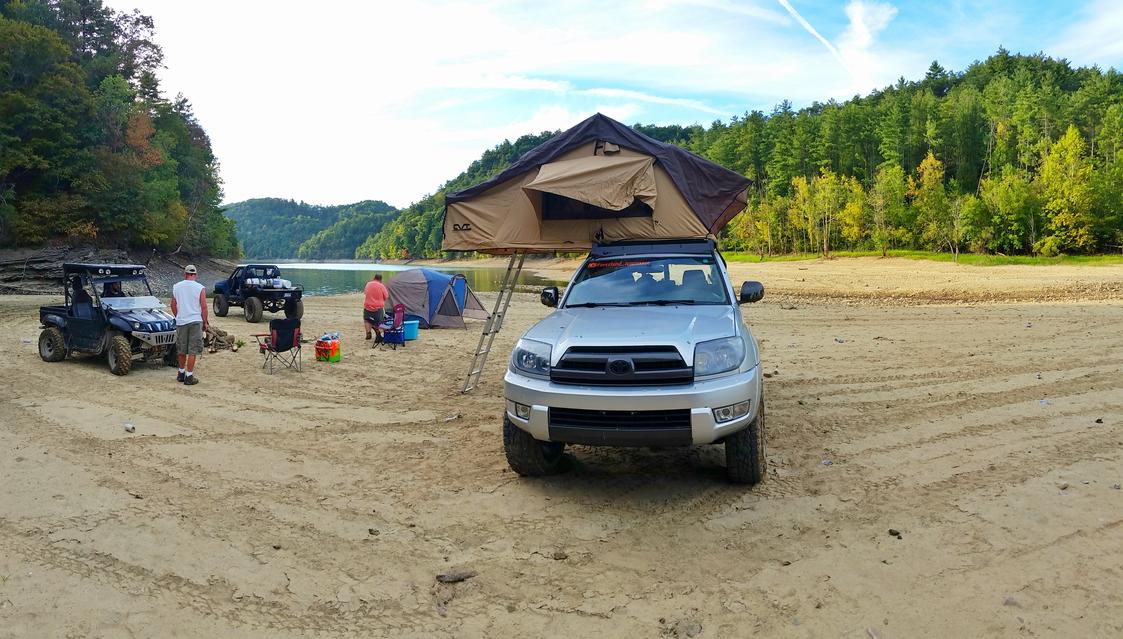

4th gen roofrack
That is one great looking set up. Any roof modifications needed for folks to sleep up there without risking the roof buckling?
Nope.

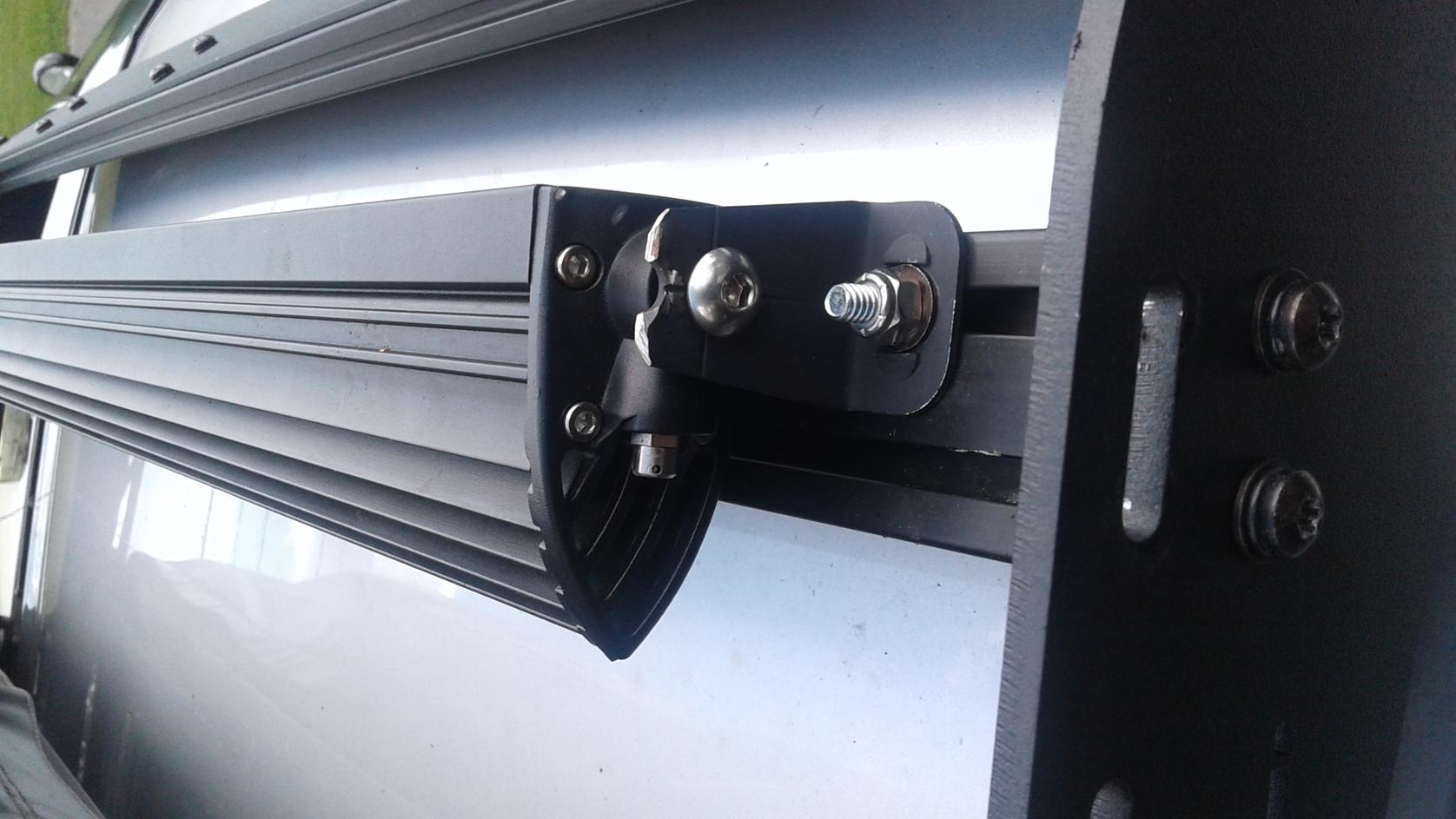

What are you using for mounts on that lightbar? I currently have a 40 inch lightbar that I'd like to install just like that on an eventual Prinsu.
My light bar was purchased on ebay.... here I just used the mounts supplied with the light bar, and used the special bolts supplied with the prinsu that you slide into the channel with the threads pointing up... I then mounted the crossbar behind the fairing on the lower holes so the light bar sits low
Edit.. here's a photo
Nice - thanks for the photo and ideas on mounting.

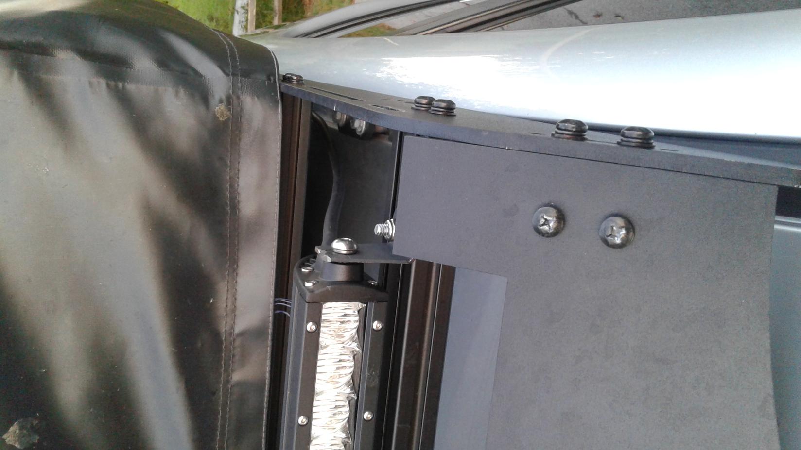

Where did you run the electrical?
I couldnt see any cabling/cords in the pix you posted... Im curious to know where/how you did it for that clean look. Any pictures to show details would be helpful. Thanks in advance.

I ran my wire down my factory rain gutter, where the OEM rack used to sit. I then ran it into the hatch, in the already existing hole for the 3rd brake light and other electrical stuff in the hatch. I then doubled back and went all the way up my headliner, to the a pillar, into the firewall. Took double the wire but didn't need to drill any holes.
