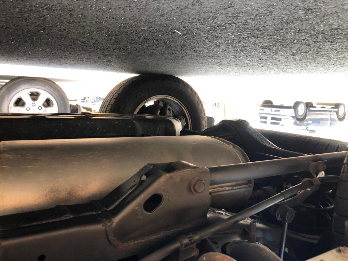

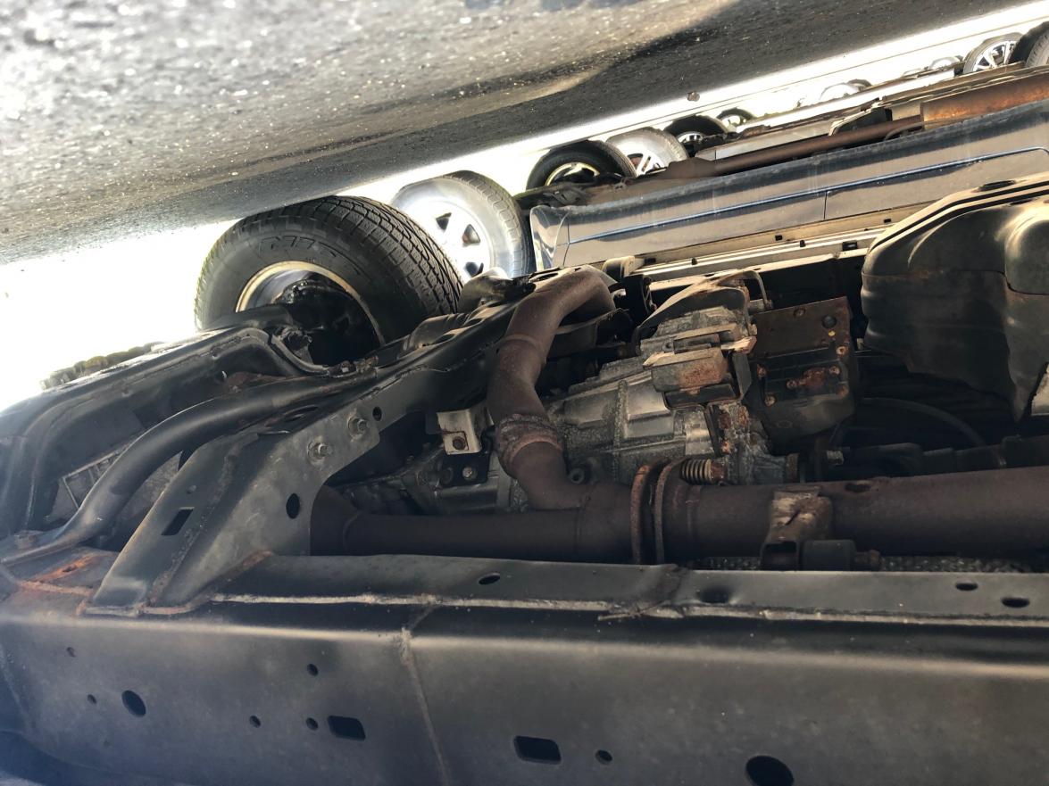

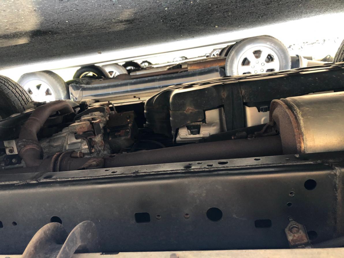

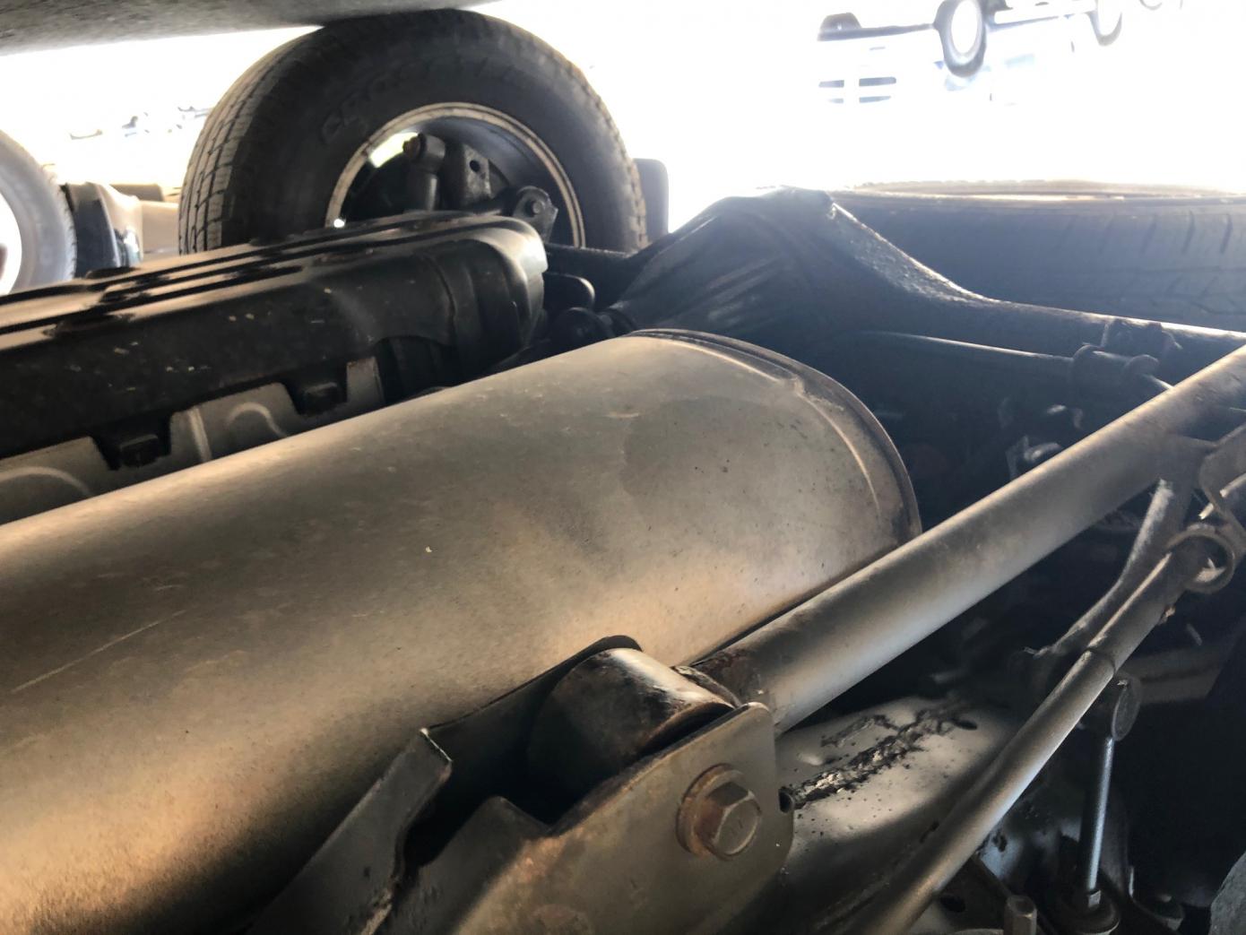

Can anyone provide any input on these pics? 2008 4runner with 140k on it at a dealer about two hours from me. Asked them to send pics of the frame before I drive up there to get a better look and they sent back these. It looks good but almost looks like it was painted over? idk maybe not
edit: not sure why they are showing up upside down when I upload them, if anyone knows how to fix let me know

That looks pretty freakin minty if you ask me. The worst part for rust is the front skid plate mount, the cats, and the passenger ac drain on mine. Based on the pictures, you should have any of these issues. Its a really clean looking frame

The frame looks great, the exhaust not so much unless I'm seeing things that are not there. I had to weld in plates where the outer gas tank strap attaches, on one of the trailing arm attachment points and a bottom flat area near where your feet go when in the truck. That one looks worthy of looking at. Do try and drop the spare tire as that mechanical piece like to freeze up.
Thanks guys! I couldn't believe my eyes when I got the pics from the dealer, looked too clean to me haha. I've got them saying they will hold it for me til friday and I've got an appointment with the toyota dealer that's next to them for them to look it over before I purchase it. Here's to hoping I can finally join the club!
To me it looks like the frame has been painted. Two clues. There is a hole which has bright orange rust but no lifting paint around it. Rust starts under paint and causes it to blister and lift. Compare the gas tank sheild vs the frame. They look like they camr from two different trucks. The gas tank shows fading and stains, but the frame looks new. Also look at the frame, the paint has glossy and flat areas, its not uniform, but it looks clean, as if it was just painted.
How bad is it? Who knows. I dont see rot and the PO may have just been proactive. It may have been through a body shop for an accident. Until you see it, its hard to say.
And I see black overspray on the bracket and bolt in the lower right corner of your picture. Its been painted.

Yea it may be too good to be true. It's only had one owner and shows no accidents/damage reported on the carfax for what its worth. I have an appointment with a toyota dealer to look it over before I purchase so I'll voice my concerns with them and see what they can find.
Rap the frame with a hammer and listen for a dead thud sound. If its solid, I would be fine with it. Like I said, I dont see any cancer or rot.

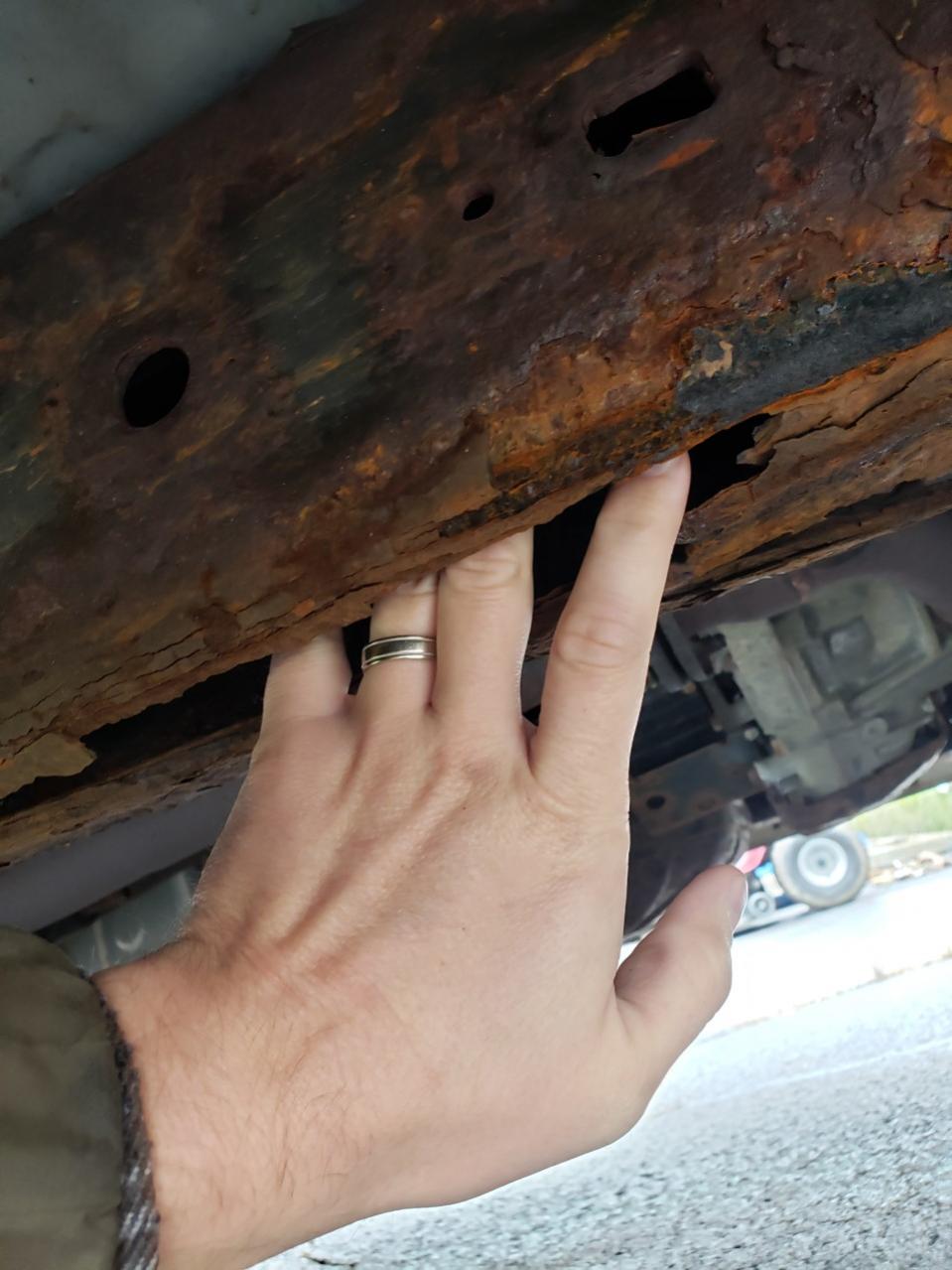

Rust Spots
I have a 2006 4Runner (4th Generation) and it's lived in the Northeast its whole life. It is definitely rusty but the frame is still hanging on well. It's definitely something to keep an eye on but you'd be surprised how resilient these things are.
I wish I could agree but I have a 2005 with 90k miles. It has been taken care of but has lived it's life in Wisconsin and we do salt roads. But regardless I have had cars older than this with less rust on it's frame. Mine has been sitting in the corner of my driveway for a year because I don't know what to do with it. It isn't safe to drive in my opinion.
But the frame that was being questioned to purchase, it looks great - painted by someone or not. Just watch for issues.

I agree, that has definitely been touched up, but nothing I’d be concerned about based on the frames I’ve seen on these here in the northeast. Usually there are holes already, or blistering under the paint where if you whack It with a ballpein hammer, you’ll punch through the scale. I’d say the previous owner or dealer just sprayed some areas to make it look better and cover surface rust. I wish my frame was that nice!
