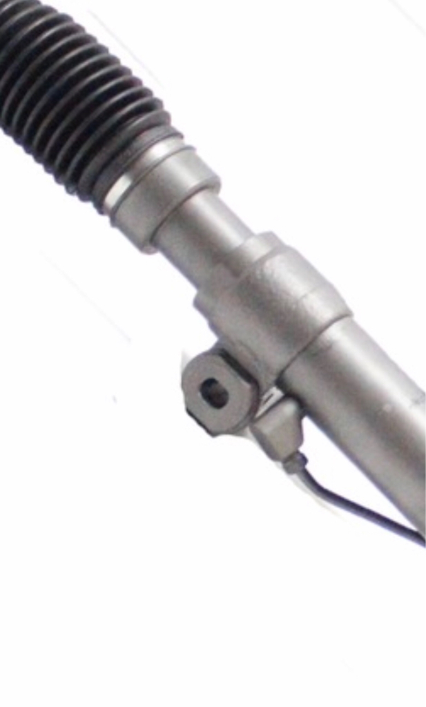

Thats basically what mine look like, but if you look at new steering racks for Toyota 4runner you will see that the rack has an oblong mount on the left side. Just type in your year of 4runner and look at all the new racks offered online and you will see what im talking about. Bye the way...impossible to do on the truck, have to pull it all the way out. If you take off the 14mm bolt holding the belt pully on the bottom of the truck just above the steering rack bolt you can pull the bolt all the way out and slide the rack out towards the rear of the vehicle pretty easily. Only took me 2 hrs to pull the rack.
