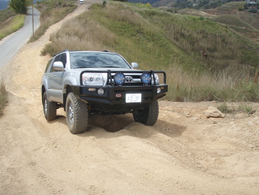

I Know Whats going on!!!!!!!!
The 4runner you guys saw on that video is from Venezuela and i think it's exported directly from japan or colombia. I have one of those 4runner here in Venezuela and they don't bring the ATRAC/TRAC or the center diff lock. They have 2wd 4hi and 4lo that is it. I hope this answer a lot of questions.....
Wow! Interesting post. Didn't see that one coming.:bugeye:
What an amazing twist. Thanks for chiming in.
Hey BadRunner, nice rig you have there.
What configuration of Front and Rear Diff's are in those T4Rs they sell there (open F/R, LSD R/Open F, or something else?) and what kind of 4WD system is it.
just wondering
Joe
