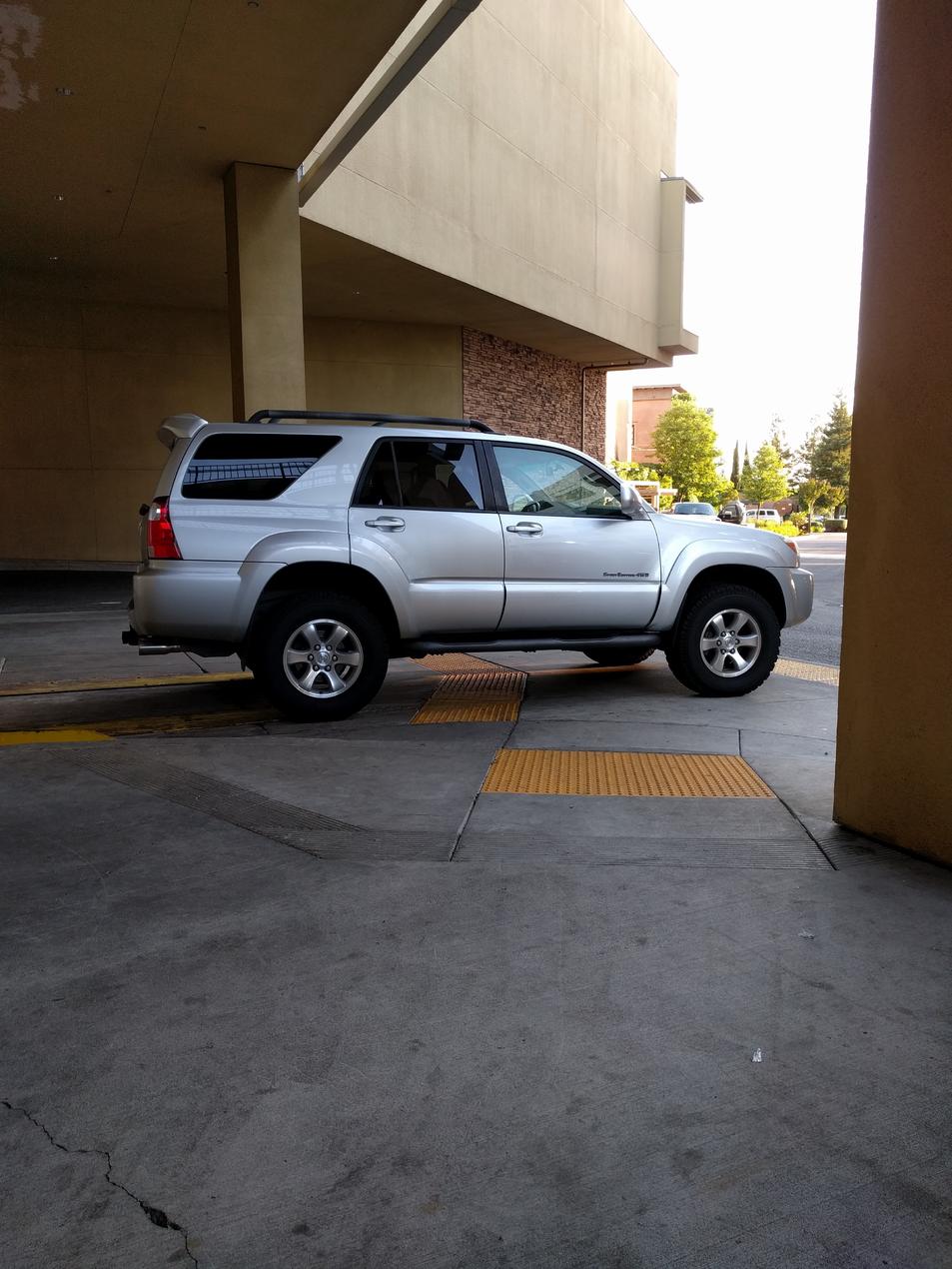

Just put on Bilsteins 5100s with front set at 0 with wheelers T1/T12 springs. Wanted closer to a 2.5/1.5 rear lift and be able to run 265/70/17 KO2s. Happy with the ride and height. Replaced 95k mile xreas.

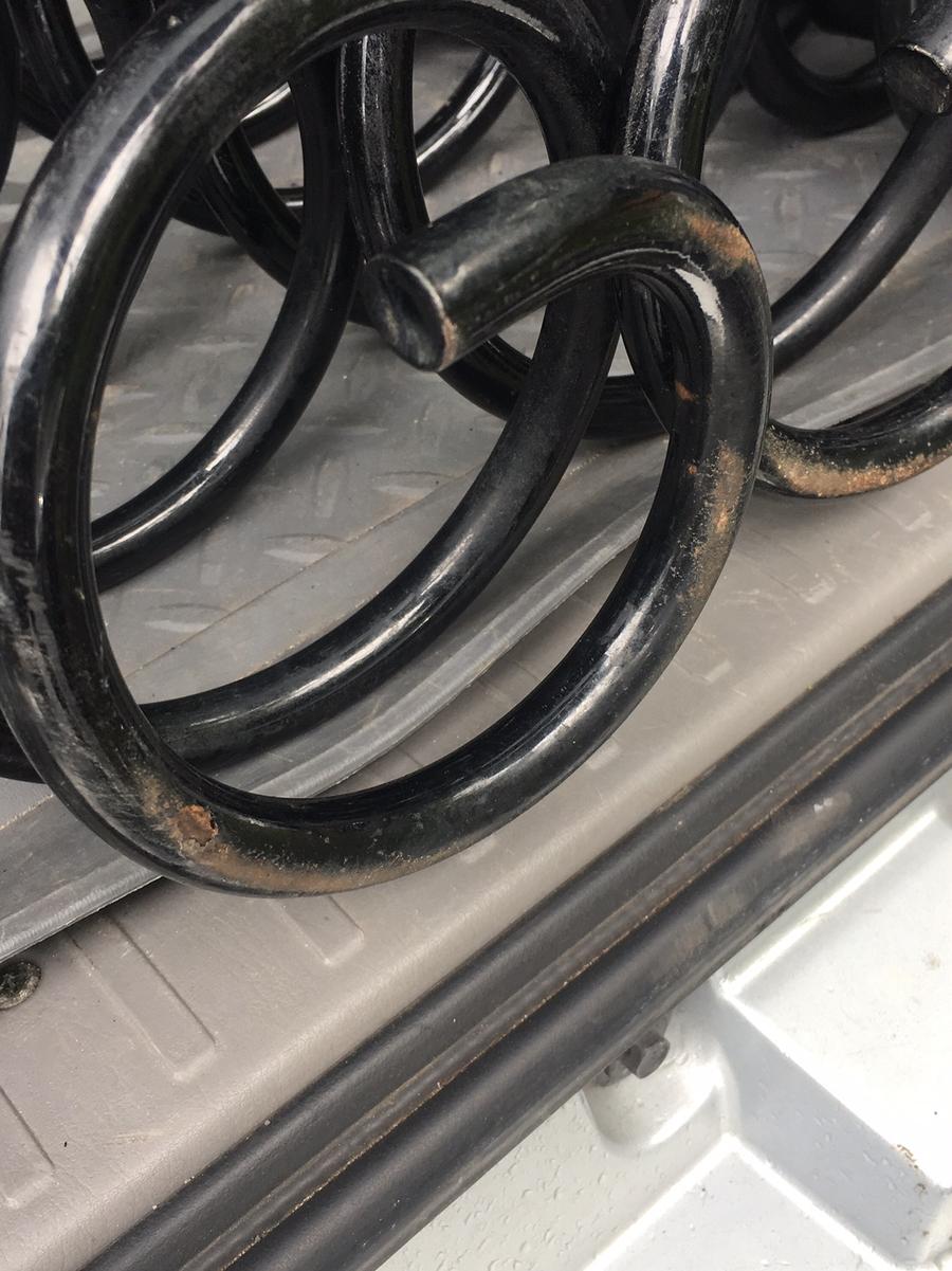

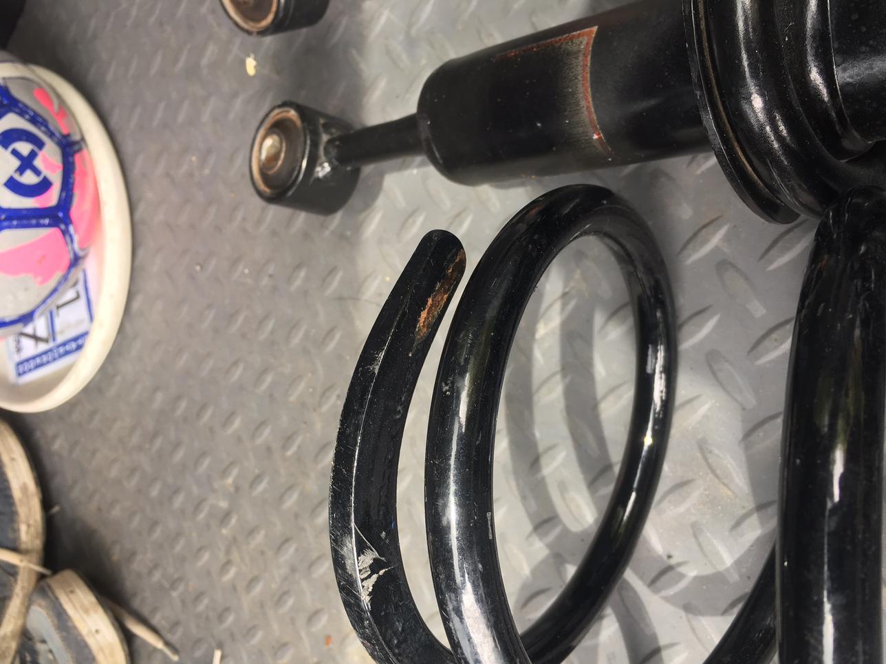

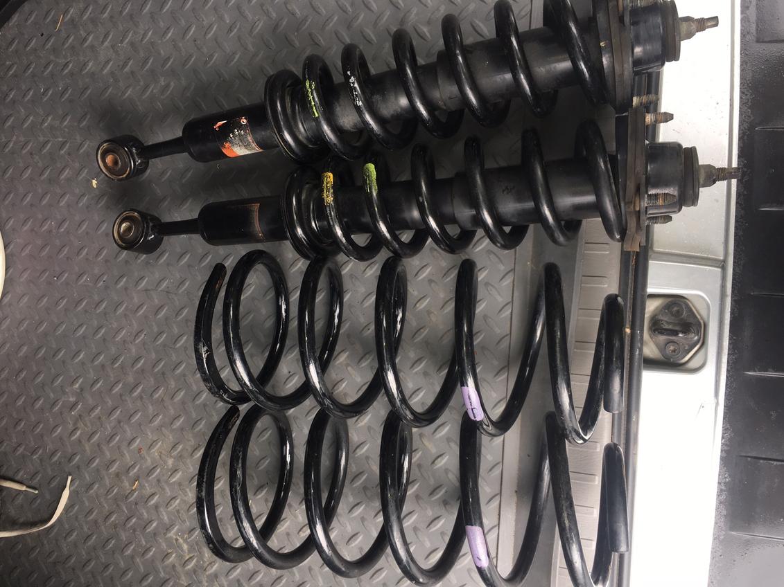

Just got an 07 FJ setup with 20k (supposedly) from over at the FJ forums. The rear coils have a very slight amount of rust on them that appears to be where they touch the mounting plates when they are seated. I assume this should not be an issue but i'm not trying to run sketchy coils and Im curious to see what others think. I plan to give the rusty spots a quick sand and light layer of paint....think they should be good to go after that?
Also, I will just be using the coils so if anybody wants the shocks you can have em if you pay shipping.
