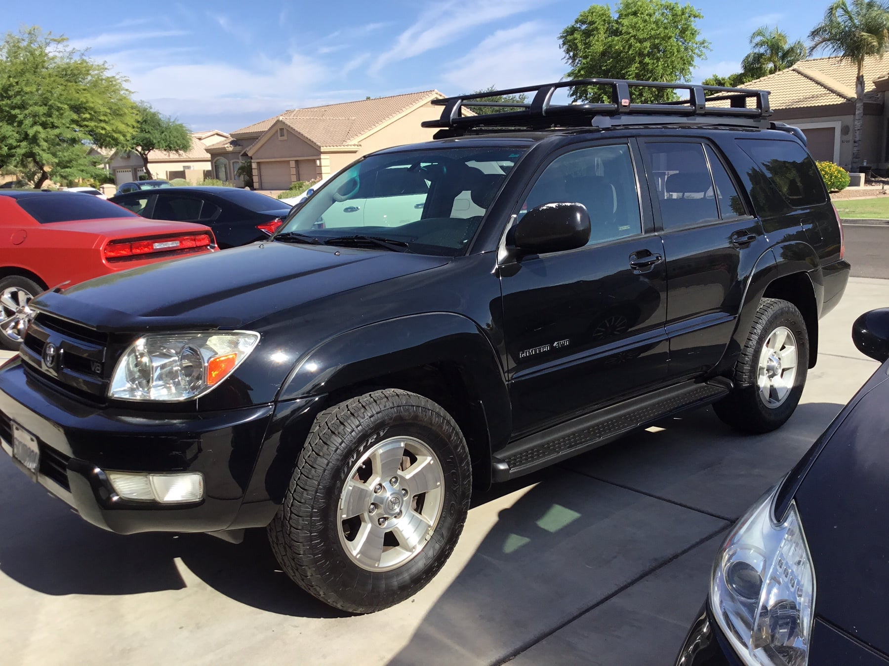

I went with the Toytec 521600 HD springs. They list them for Tacomas but they work. I have my 5100's on the bottom setting and got 4 inch lift for the front with the V8. However my stock XREAS shocks were shot and sagged some from stock height. I am running 255/80 17 and only had to trim a little off the inside of my mud flap. In the future I will get an ARB bumper and will most likely run the spring set up a notch to compensate for the sag.
Yes they ride nice, I'm actually surprised.

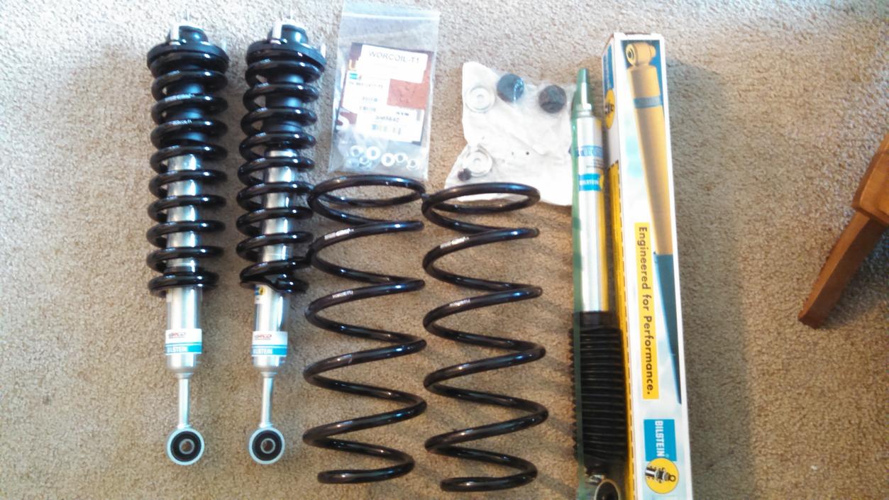

I just bought 5100's with Wheeler's (see Eibach/Sway-A-Way) Springs. Adjustable's set to stock setting with T1 coils in the front and 5100's and T12 springs in the rear. Wheeler's had a great price on the adjustables and their coils/springs will provide about a 2" lift without spacers. These are more heavy duty than Stock FJ stuff and the prices are reasonable. I found some like new T12's on the FJ forum for $100 shipped (would have been $60 more to get new T12's from Wheeler's), paid $482 for the adjustable Billy's with T1's installed (incl shipping) and $154 for the rears via Amazon (Summit also had a good price on rears) shipped to the door. All hardware installed or included. Total was $736 to my door. Wheeler's was great to work with. Highly recommend them. Goodbye XREAS! Install next week.
http://www.toyota-4runner.org/4th-gen-t4rs/222569-feedback-review-wheeler-t12-rear-coils.html
