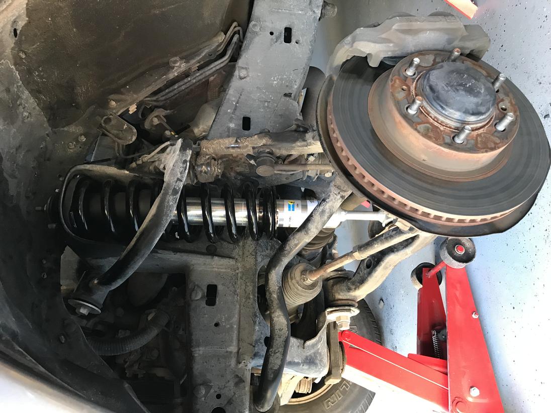

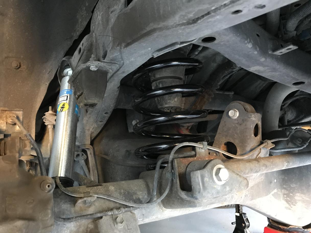

New suspension on the wife’s 4runner.

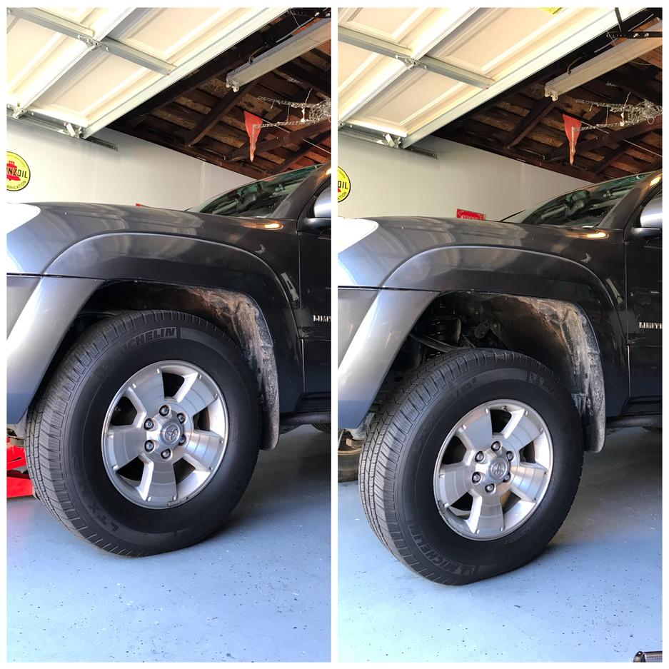

Is it standard operating procedure to get an alignment after replacing shocks/springs all-around? And if so, is it advisable to wait a week for settling to occur?
Yes. I noticed the tires were at a different angle after the lift. I think I’m just going to get the firestone lifetime alignment. I’ve had it on my tacoma for almost 5 years and get an alignment every 6 months and or after major off-roading.

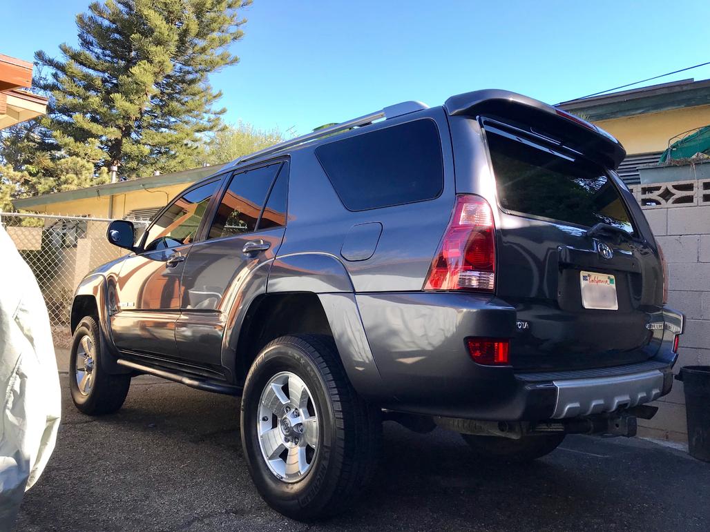

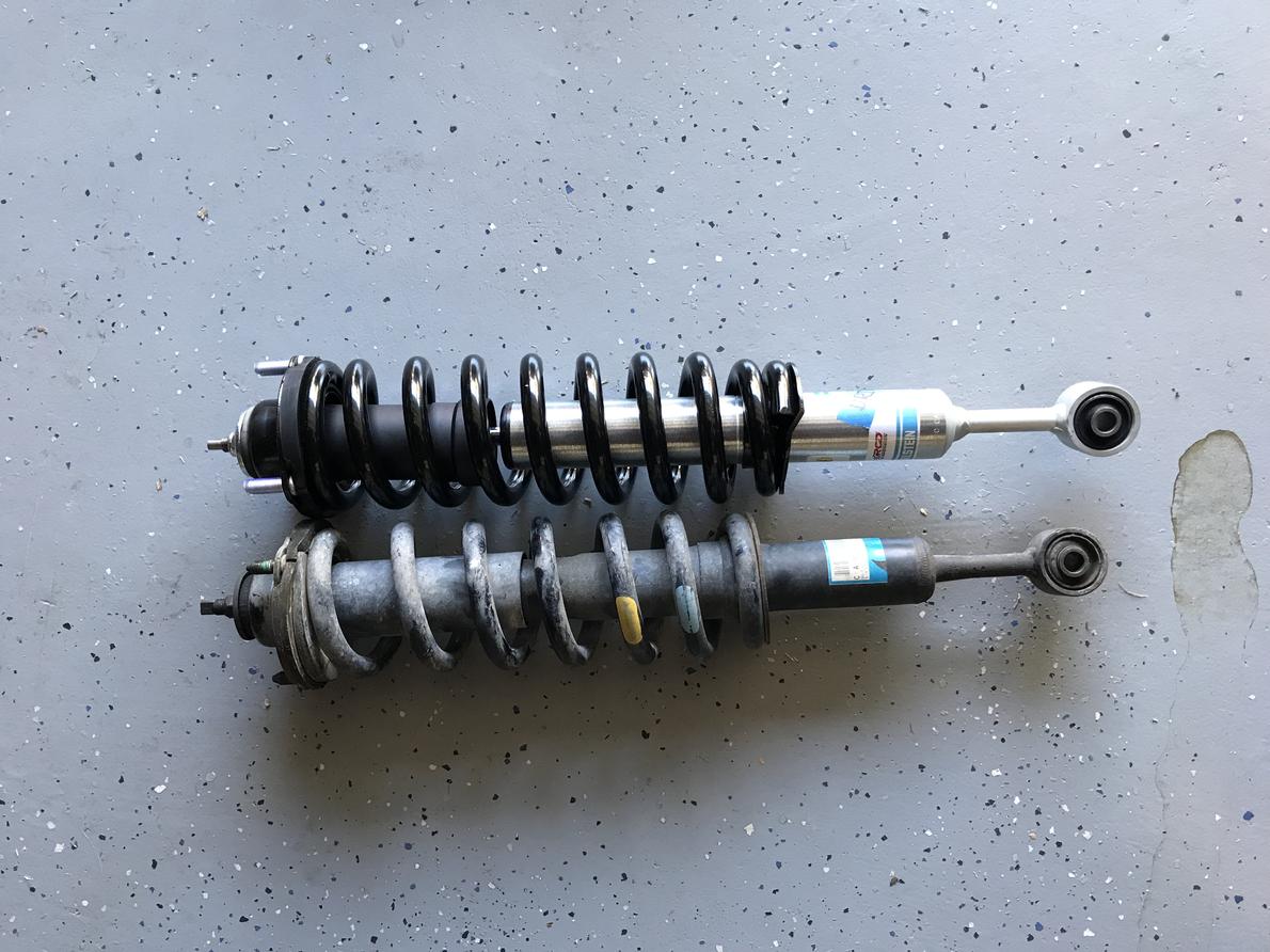

Here are some more pics. Looks more than 1.25” lift probably because old suspension was shot.

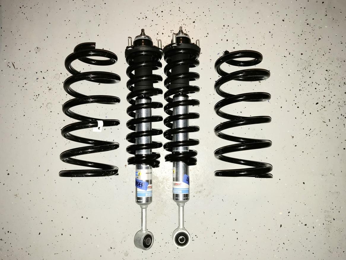

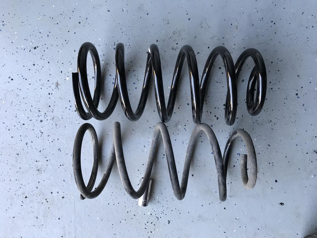

The suspension upgrade came out exactly as I had hoped: supple yet firm, approximate lift 1.25" front (with the Bilsteins set to .85") and 0.5" in the rear. Ride height is 20"/20.5" F and 21.5"/22" R with the tank full. This gives me exactly the lift I need for going to 32" tires in the future and provides a supple yet firm ride. I tried it out on the Iron County Recreation Trail (UP of MI) and really like the way it rides.
Both front springs are the same, marked white-orange and with the extra wrap (p/n probably 4813135650). Both rear springs are also the same, marked orange-pink, 373mm (14 11/16") in length (2mm shorter than the stated length for the FJ rears). (Pix included below.)
IMO anyone having trouble looking for a decent set of FJ springs should consider getting springs from a 5th-gen 4Runner instead. They are widely available and relatively inexpensive.
