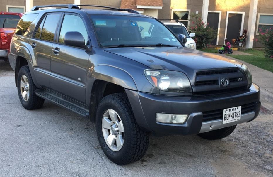

Happen to have a photo of your rig handy?
Trying to attach photo, dont know if it worked.
I"m at 38" to the fender lip in the front and 39 1/4" for the rear. this is with 255/80 17's
