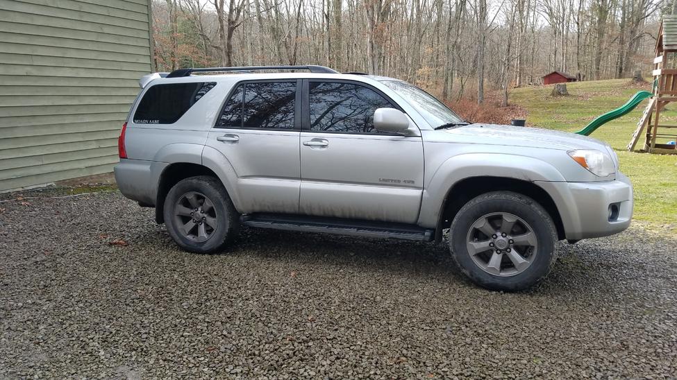

I feel like my rig isn’t high enough so 3/2 lift here I come I guess. What everybody think about a lift?:biggrin1:

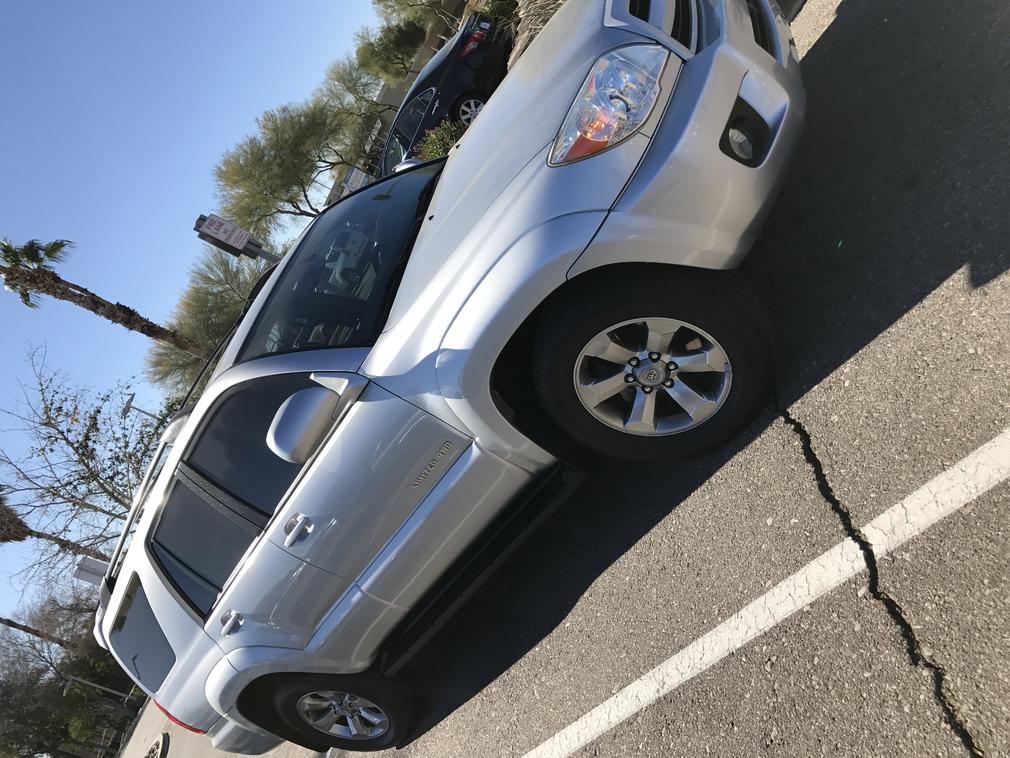

Hey fellas, just purchased an 2008 v8 limited 4wd came from
Owning a 2012 tacoma 2wd. Being a noob to 4runner and owning a 4wd i was wondering if anyone is running FJ springs and keeping the rear stock? If anyone is please post a pic would like to see how it looks.i just want the front to be level and have have a rake being stock . Thank you so much guys

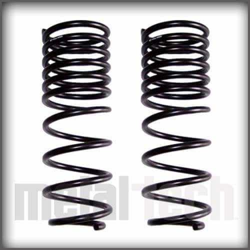

Bilsteins 5125 26" or 28" shocks used with metal tach 3" coils. Has anyone else done this and do you know what valving should be on them since there are a few options? Spring info below.
NextGen Spring Specs:
Free Length - 19.25 inches
Top Coil Rate - 104 lbs
Bottom Coil Rate - 300lbs
Total lift height 3 inches

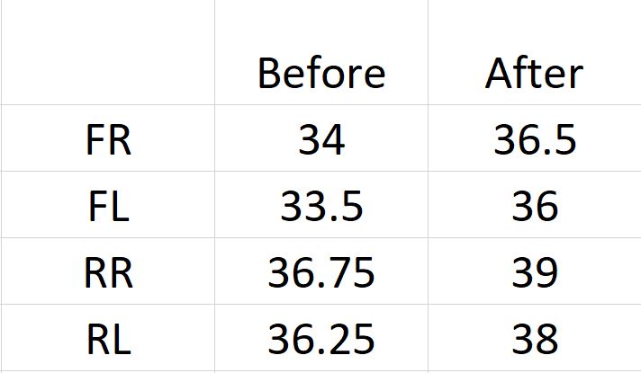

Here are my measurements. I had a lot of sag before I lifted it.
I am also hoping to get it more level. Does anyone know how else I can bring the front up? I know I can get a .25" spacer for the front left to bring the front even, but should I do a tapered body lift to get the front up 1.5"? I didn't anticipate that the back would end up this high. Also, the rear is not level because I had a full tank of gas.

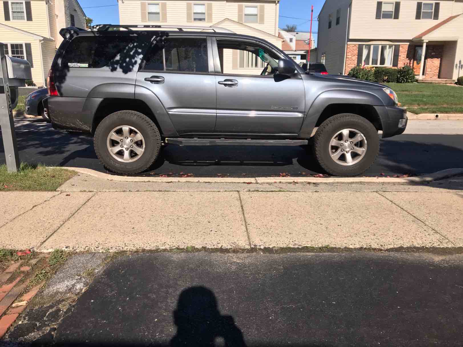

posted this in another thread but heres mine with moog 81108 fj coils in the front and moog 81045 4runner coils in the rear. also, mines a v6.
its sitting on a small slope toward the back in the pic but on flat ground it looks really level.
Looks good. From my research I was planning on using that spring and shock combo but on my 04 v8 SR5. I think I will try a higher clip for the 5100s. Maybe middle or near the top to help with the extra weight of the v8. I may just see how that works and have some rear daystar spacers ready in case I get some reverse rake.

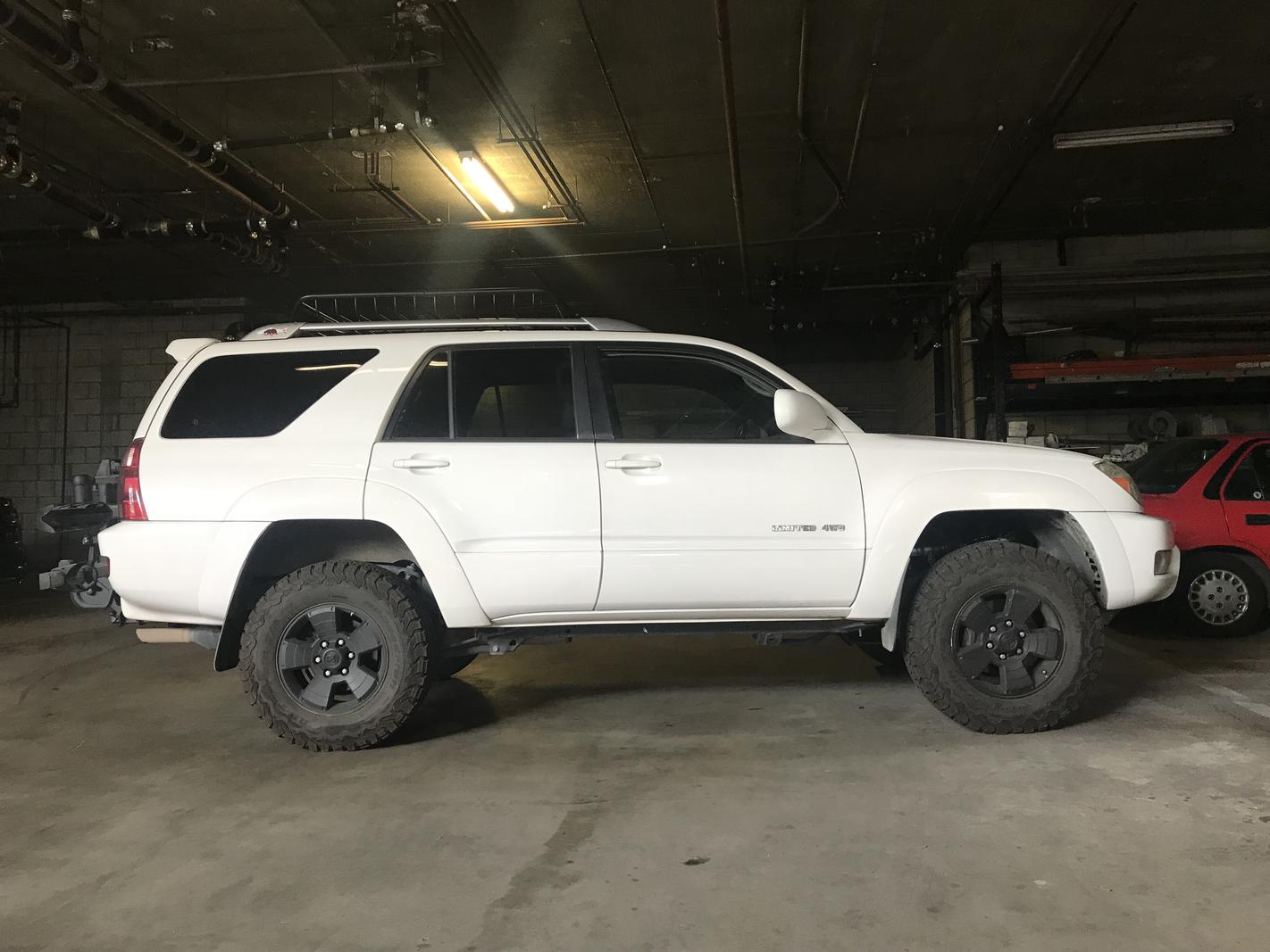

IMG_2460.JPGHere’s my 05 v8 on 6100s front and rear, set at the higher spring perch up front and daystar 1.5” spacer above the rear springs utilizing OE FJ springs front and rear
