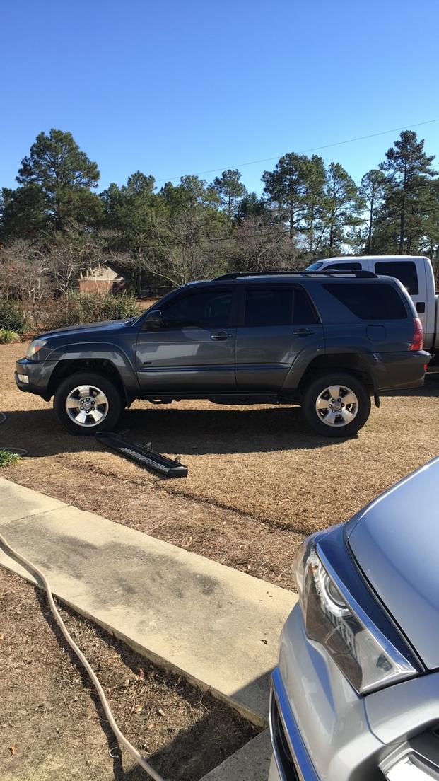

Help with info
I recently installed the toytec 3” coil spacer/rear coils lift on my 04. Although I’m happy with the ride comfort, the truck does not sit level at all. Is it at all possible to level the front with the back without being dangerous? Non-Toyota friends have suggested putting an additional 1” spacer on top. Toytec technical support does not recommend it. Any suggestions on how I might be able to fix this problem?

Help
Anything? I'm brand new to this page so I haven't looked through every post.
I guess a better question would be why might I have such a big difference between the front and back?
I can make you a spacer in ANY size you want, custom, to get you level.
