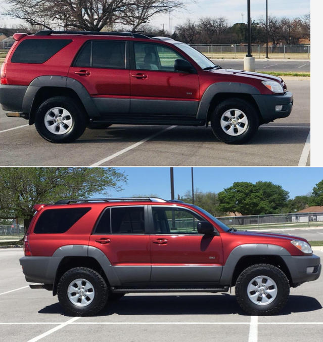

Below is SR5 bone stock suspension with Geolander 265/70/16 on factory wheels in first pic. 2nd pic is the Burtman 2/1 Cornfed lift with Bilstein 5100 shocks all the way around. Frnt shock set at zero lift. Switched tires to BF Goodrich AT KO2 in 265/75/16. Rides great.
4Th gen lift and leveling kit at Burtman Industries
Can also make ANY CUSTOM SIZE spacers you guys need.
