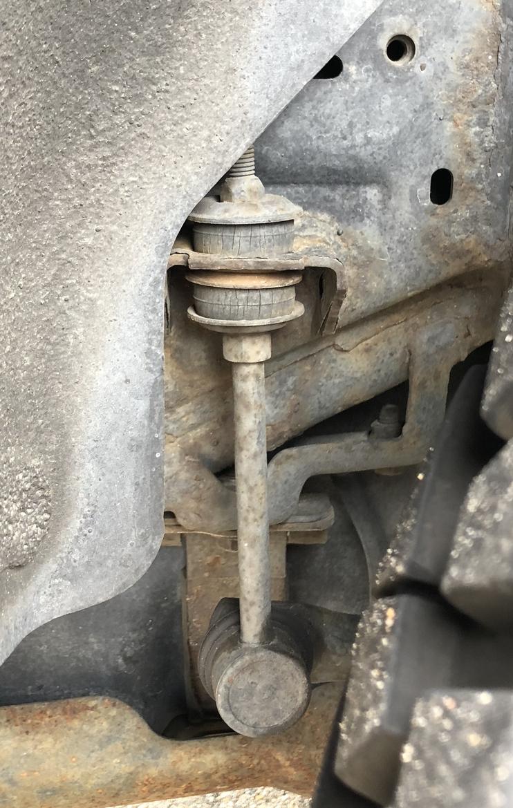

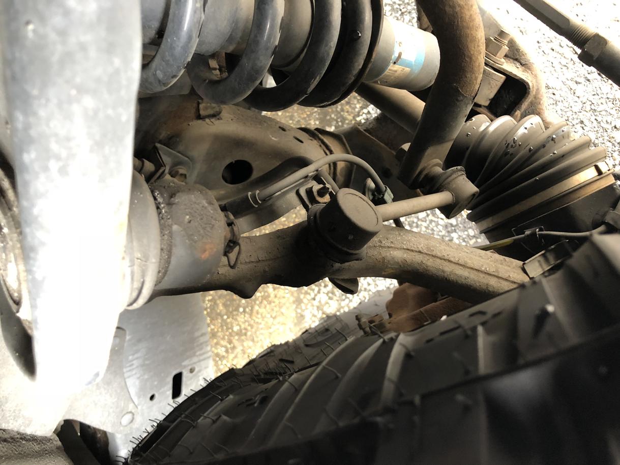

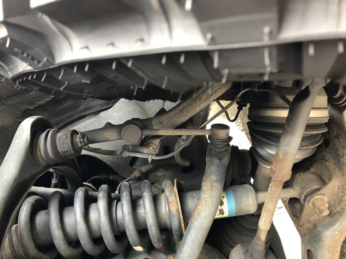

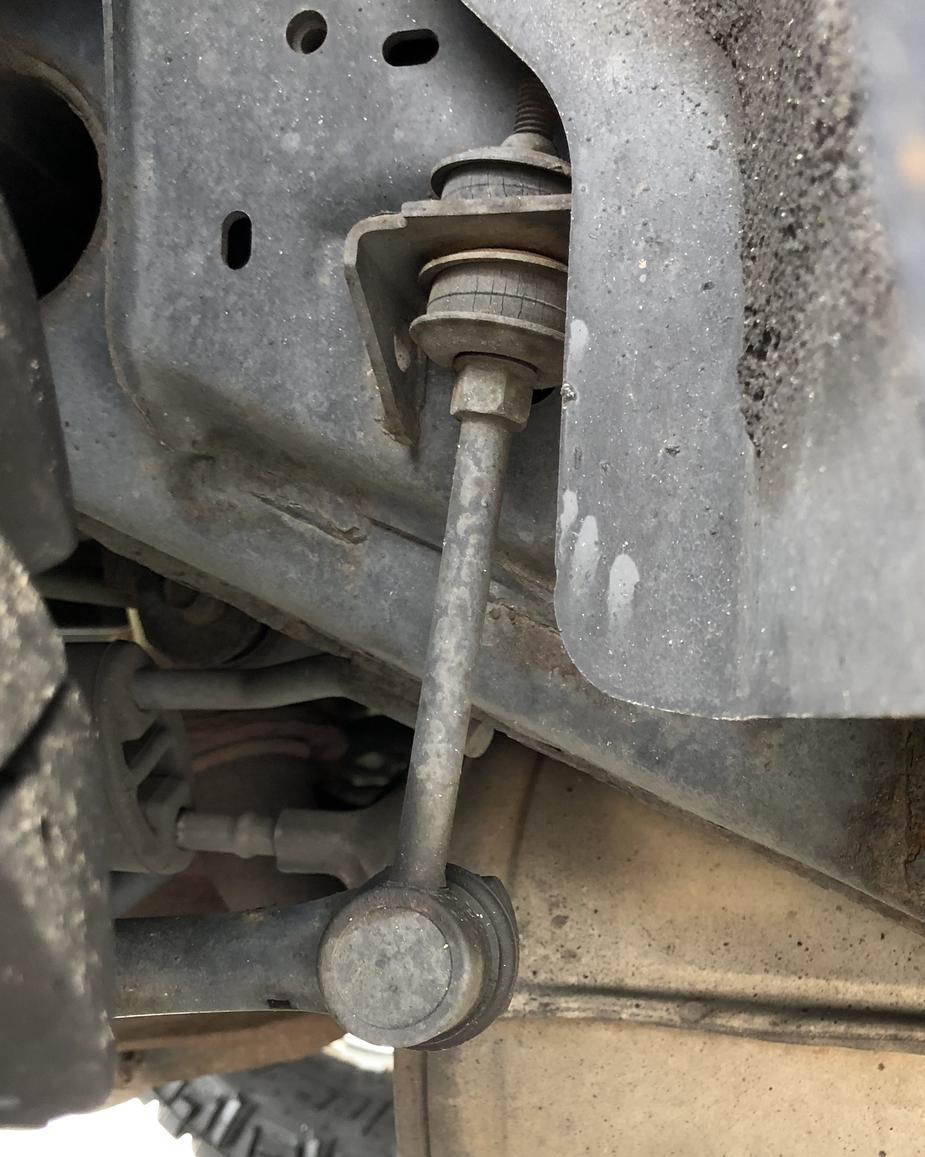

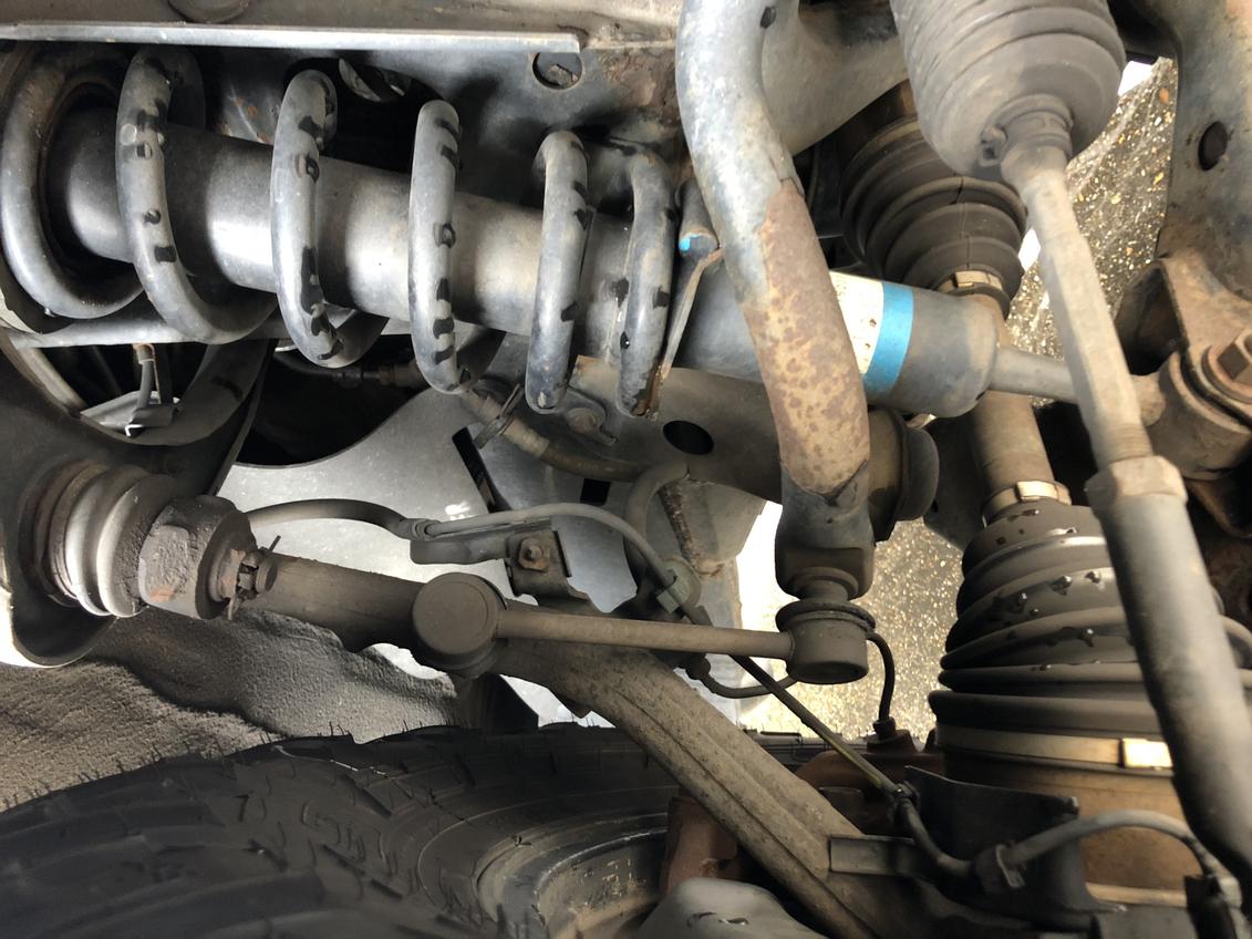

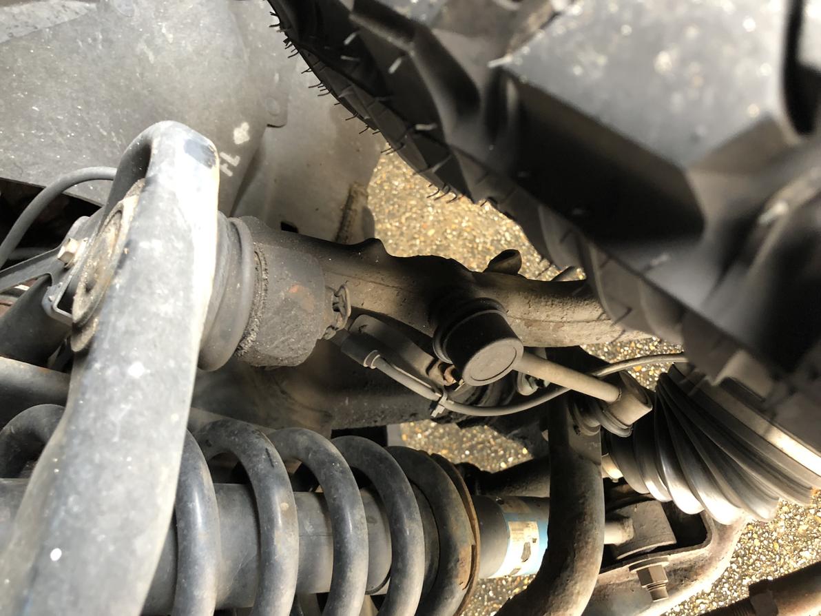

Im about to put the new lift kit on in a few days and can't decide if I should replace all the sway links or not. what do yall think based on the pics
I would, Its easier to do the suspension stuff with them disconnected anyway. I went with the Skyjacker FJ links in the rear and some new stock ones for the front.
