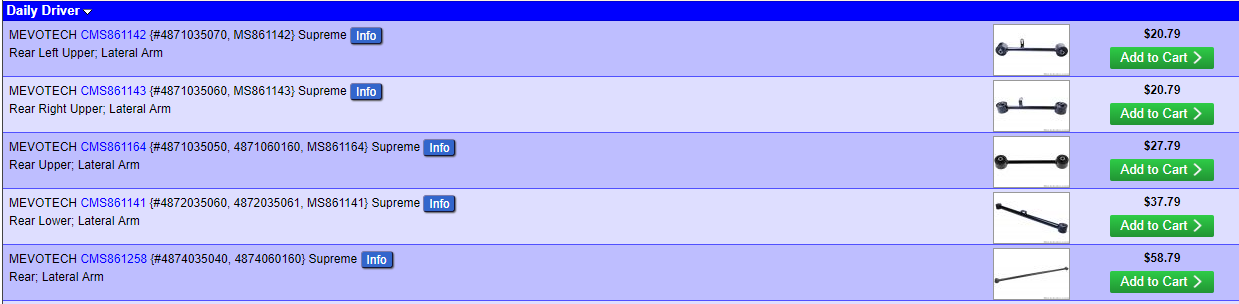

I'm slightly confused about the rear arms, looking at rockauto. There is "Rear Left Upper; Lateral Arm", "Rear Right Upper; Lateral Arm", and just "Rear Upper; Lateral Arm". Does the version with no left/right designation work for either left or right? Or do I need all three? The left/right ones have a bracket, while the one with no side designation does not.
I guess my question is, if I want to replace all the bushings in the rear by just replacing all the control arms, do I need one of each of these items?
These are the rear upper links.
Either 1 of CMS861142 and 1 of CMS861143. If you need the brackets.
Or 2 of the CMS861164. If you don't need brackets.
And 2 of CMS861141.
These are the rear lower links.
CMS861258 is the cross bar/diagonal, not part of the 4-link.
