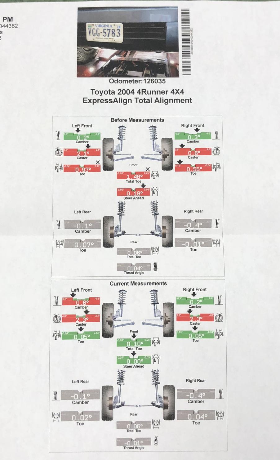

Got the runner aligned yesterday after installing new springs, shocks, and cv axles and Im not sure if I need to get the UCAs or not but here is the specs from it. My concern is the left front camber as it isn't even with the right
Someone doesn’t know what they are doing. I would find a shop that can align a vehicle that’s been lifted. Caster isn’t terrible, but should definitely be able to get camber in spec. I would take it to another shop, ask them to max out caster and get camber and toe in spec. Take the print out back to the first shop and ask for your money back.
yeah im going back tomorrow to have them fix it. the caster will be fixed when I get my new UCAs since I still have stock. but that camber is causing me to pull to the left and I can't stand that. like you said that should be in spec. if one side can be i dont know why the other wouldn't

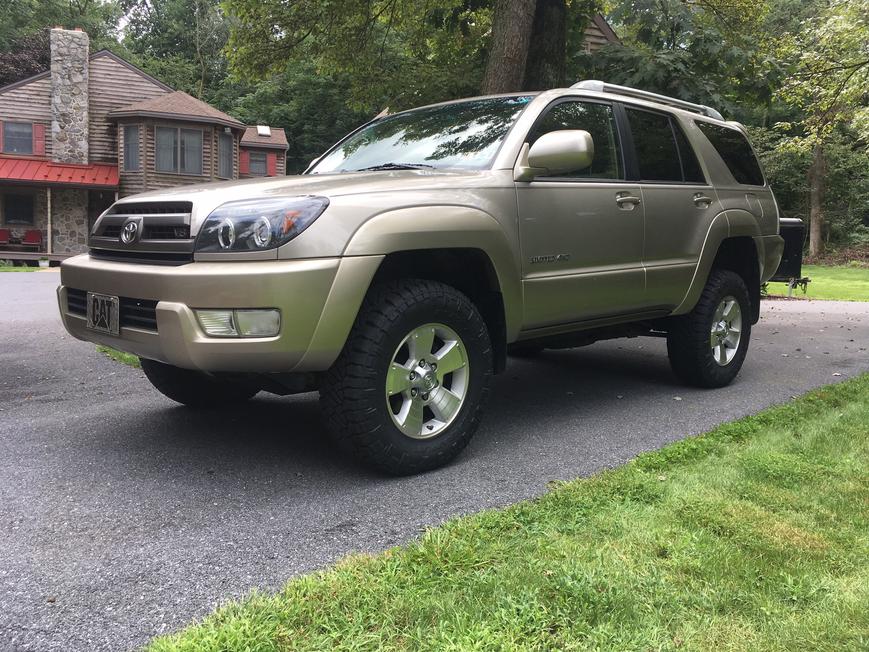

Since I didn't get any comments/suggestions (this thread seems to have died off) I went ahead and pulled the trigger today...
Not actually either of the 2 options I listed above but I'm doing Bilsteins all around with the Bilstein packaged coils on the front and Toytec Superflex HD's on the rear. I will set the front to 3" of lift and if as advertised the Superflex HD coils should give me around 2.5" unloaded in the rear. I will rarely be unloaded completely in the rear, so hopefully it ends up closer to level.
Also went ahead and ordered my new sneakers: Nitto Ridge Grapplers.
In about 3-4 weeks, when it all comes, in I will gladly let you know if I feel like I made the right decisions or not. Short term impressions only, obviously.
I'm just quoting myself here to save some typing.

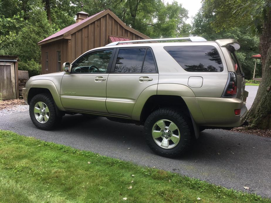

My lift is done and new sneakers are on. Alignment is complete and although I forgot to get the printout from the shop, I believe it worked out well because it tracks perfectly straight. No squirreliness in the steering, no pull and handles fine. I did not replace UCA's. Nor were there any unpleasant other surprises from the install.
Stats: The front ended up with 3" of total lift. 2.5" from the suspension & 1/2" from the tires. Rear was a bit surprising with 3.25" of lift from the suspension & another .5" from the tires. Hopefully it will settle down some since I wanted to maintain some rake, but not quite this much.
Early impressions: Couldn't be happier with the ride. Exactly what I had hoped for: firm but not at all harsh. Even with the HD springs in the rear, it stays well planted on crappy back roads (all we have around here) and has a very confident feel without the bone-crushing jarring of my 2500 work truck.
The Nitto RG's are freakishly quiet for a hybrid mud/AT tire. Quieter than the General Grabbers on my work truck. Probably even more so than the last set of GY Silent Armors I had on it. The Load Range C tires ride well. I only wish Nitto made these tires in a 275. My one disappointment is that the 265/75R17's just don't look beefy enough with where my lift ended up.
The Toytec HD coils in the rear did accomplish what I needed as for as load & towing. I hooked my 3500 - 4000 lb boat up and I still have .5" of rake. So that worked out perfect. Haven't towed it more than down the ridge & back up yet tho.
At the moment I have 150 lbs of tractor weights in the back of the truck to help settle the rear some and see how it affects the ride but I won't get to test that out till I get done replacing my rear calipers since my RR stuck when I took a little joy ride the other night. That weight did drop the rear roughly 1".
