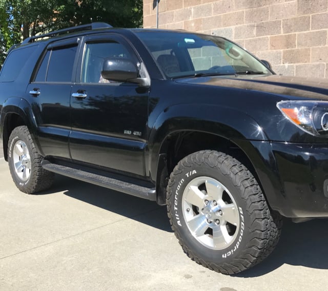

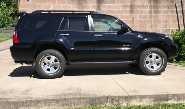

2/1 leveling kit came out awesome. It sits perfect and alignment even stayed the same.
Note: the driver side rear spacer is made thicker, which fixes the driver side lean that all these trucks have. After installed the rear will also be level, which most don't always know.
4th gen lift & leveling kits at Burtman Industries - Kits still on sale
Here was a customer that did the 3/2 with the Japan wider flares:
Another:
