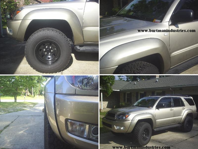

We designed the 4th gens kit off an Xreas 4Runner when they first came out. It will work with Xtreas no issue. The instructions are also specific for Xreas and explains what to do different, and you don't disconnect any lines.
Note: the driver side rear spacer is made thicker, which fixes the driver side lean that all these trucks have. After installed the rear will also be level, which most don't always know.
4th gen lift & leveling kits at Burtman Industries - Kits still on sale
Here was a customer that did the 3/2 with the Japan wider flares:

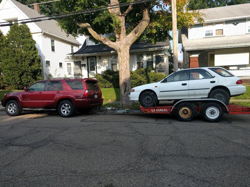

Hey everyone - longtime car aficionado - first time 4Runner owner. Bought an 06 Sport Edition V8 with 67K miles on it. Towed our Gambler 500 car (98 Impreza wagon w/ 3" lift thanks to swapped Forrester suspension) via a U-Haul trailer. Turns out, I'm pretty sure I exceeded the tongue weight and now my shocks are shot (I have XREAS). Before sinking $1200-$1500 in to either an OME or Toytec Boss Lift Kit - I'd like to replace with the OEM X-REAS system - my X-REAS system is still in tact - but the shocks are definitely done. Anyone out there have this setup sitting around they would like to find an excellent home for? I'm located in Canton, OH.

I didn't even come close - trailer was 2K and the car was just under 3K. This was immediately taken after I hooked it up.
The car was too far forward on The trailer. The weight should be centered over the axles of the trailer
Not according to U-Haul. Tires had to be up against the stops so the tire straps could secure properly. Do I agree with the design? Hell no. Did I want to invent my own securement system for 1400 miles of towing? No.
I made the executive decision to tow it according to instructions on the trailer. Just will never rent a U-Haul trailer again.
