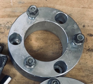

Wanted to clarify what i said about the Top-hat.
If you look at the top of the mount you can see how much thread is left on top of the mounting bolts, hence my 1/4" statement.
Found an example pic in the 'for sale' section.
Its really not hard to disassemble these, "no spring compressor method".
Link from member plasticsnaks...
YouTube
YouTube
Last thought... adjust your headlights after you mess with your suspension.

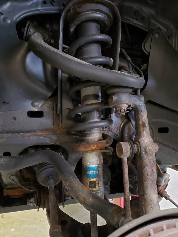

that upper control arm (UCA) looks really close to the strut in that pic. If you add more lift you might be touching the UCA...
that upper control arm (UCA) looks really close to the strut in that pic. If you add more lift you might be touching the UCA...[/QUOTE]
Thats with his suspension fully drooped. Under normal circumstances it should be just fine. Obviously not what you want for offroad use, but it doesn't look like that what he is going for
